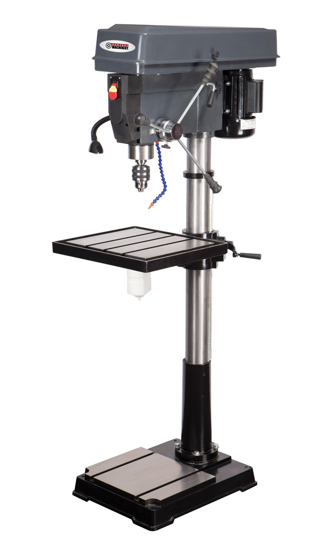

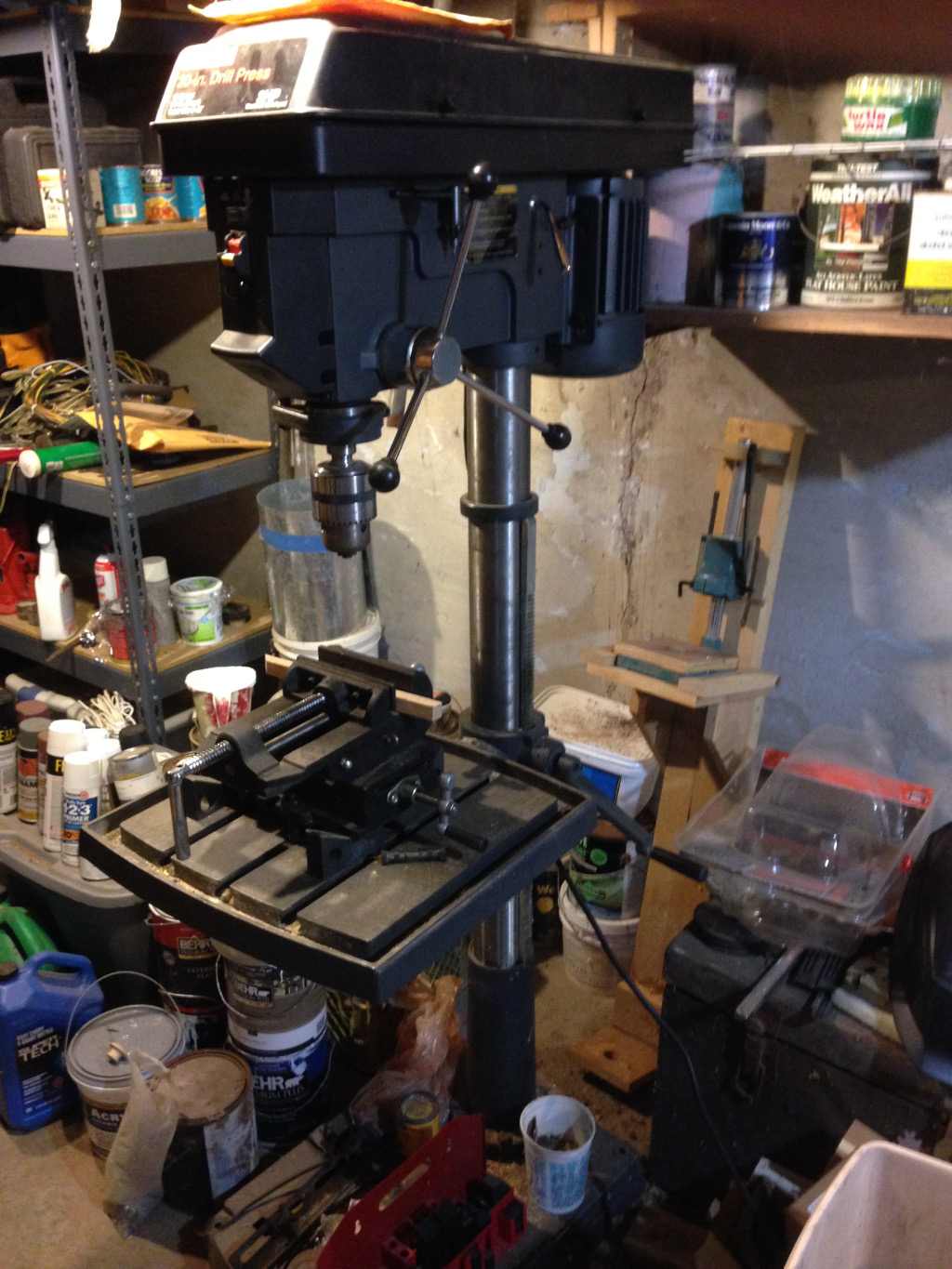

I have a 20 inch craftsman drill press that I purchased about 18 years ago. I think the deal I got was very good. I saw it for sale on eBay from a seller just a few miles away. It turned out that the seller was employed in some capacity at Sears. He had several of these drill presses, new in boxes. I think I paid around $280. It has the tall column mount, a 2hp motor and is generally a pretty beefy drill press. I think it is almost identical to the 20 inch press that Harbor freight sells. I really like it for conventional drill press operations, but I'm thinking, at the price I paid for it, it would not be unreasonable to to try to convert it. Does anybody know if it is a good candidate for upgraded bearings for the spindle and other mods that would make it useful as a mill?
Attachment 17353
Here's the actual drill press. I noticed that the column is 3.345" od. Thinking of using a straight 4 or 6 cyl engine block as a knee.

More work than it's worth. I have a similar drill press and considered the same thing. If you are looking for something to fill your time go ahead but when you look at a real mill there is very little in common with the drill press.
The main thing behind any mill is rigidity. Even my baby mill is considerably more rigid than the my drill press.
I hate to throw cold water on your parade but saving your money and watch Ebay or Grizzley or ??? and find a real mill you'll be far happier.
From the picture it appears to have the large bearing assembly that can be removed and replaced with a angular contact bearing. if it is the same as the HF dirll press it will make a good conversion. Even with that large table it still won't be rigid enough without putting the cross slide table on the base and shortening the column. all the mill drills use as short a column as they can. You can end up with a functional unit at about 200 to 400 over the cost on the drill that would include a set of DROs and some tooling. this conversion makes a mill drill but it is not a Bridgeport, and was never meant to be. It will definitely work as good as any of comparable size of the mill drills that are available at 1/2 to 1/3rd the cost and is an enjoyable project to make and use.

This is helpful. Found OE parts and a diagram at SearsPartsDirect.com. Many of the big parts, like the column and the column holder, are obsolete (no longer available). I was hoping the column was still available, in case I want to put the drill press back to its original configuration The breakdown of the quill assembly is informative. The quill is no longer available from Sears, But other suppliers indicated they have it. It's good to know that if I screw up in this key area I can get replacement parts.
