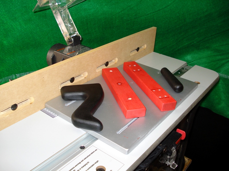

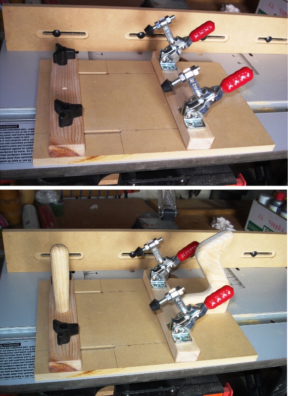

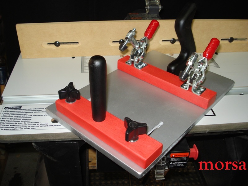

There are lots of models of router table coping sleds, both commercial as homemade (https://www.google.com.mx/search?q=c...HXx6D9AQsAQILg)
This Project was made in april-2013.

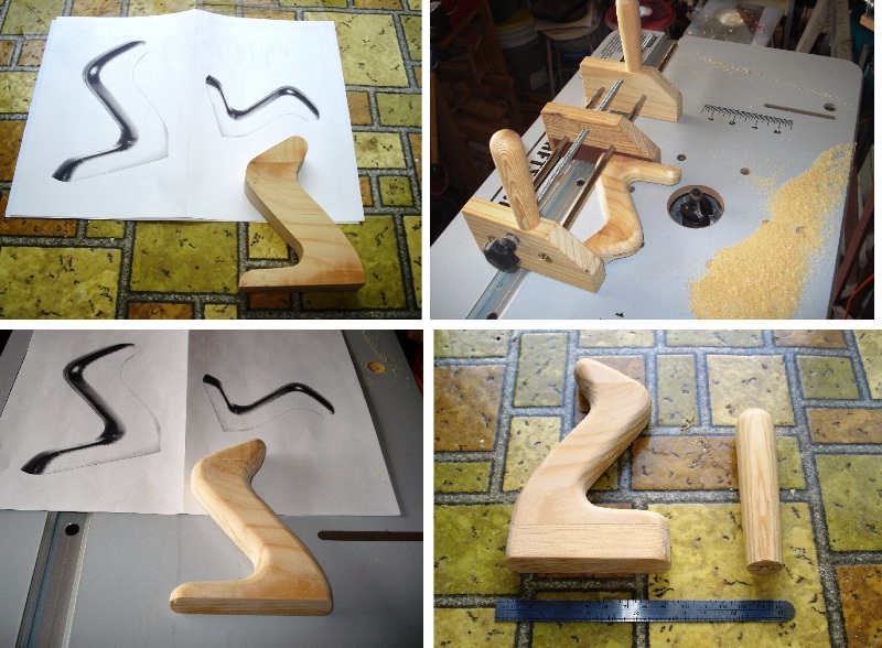

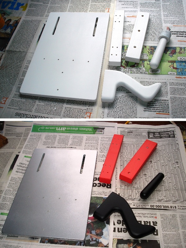

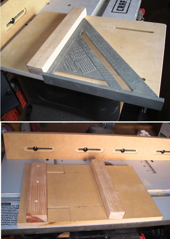

The base is 1/2” mdf; handles and stops were made with scrap wood.
Finish is primer and lacquer.
