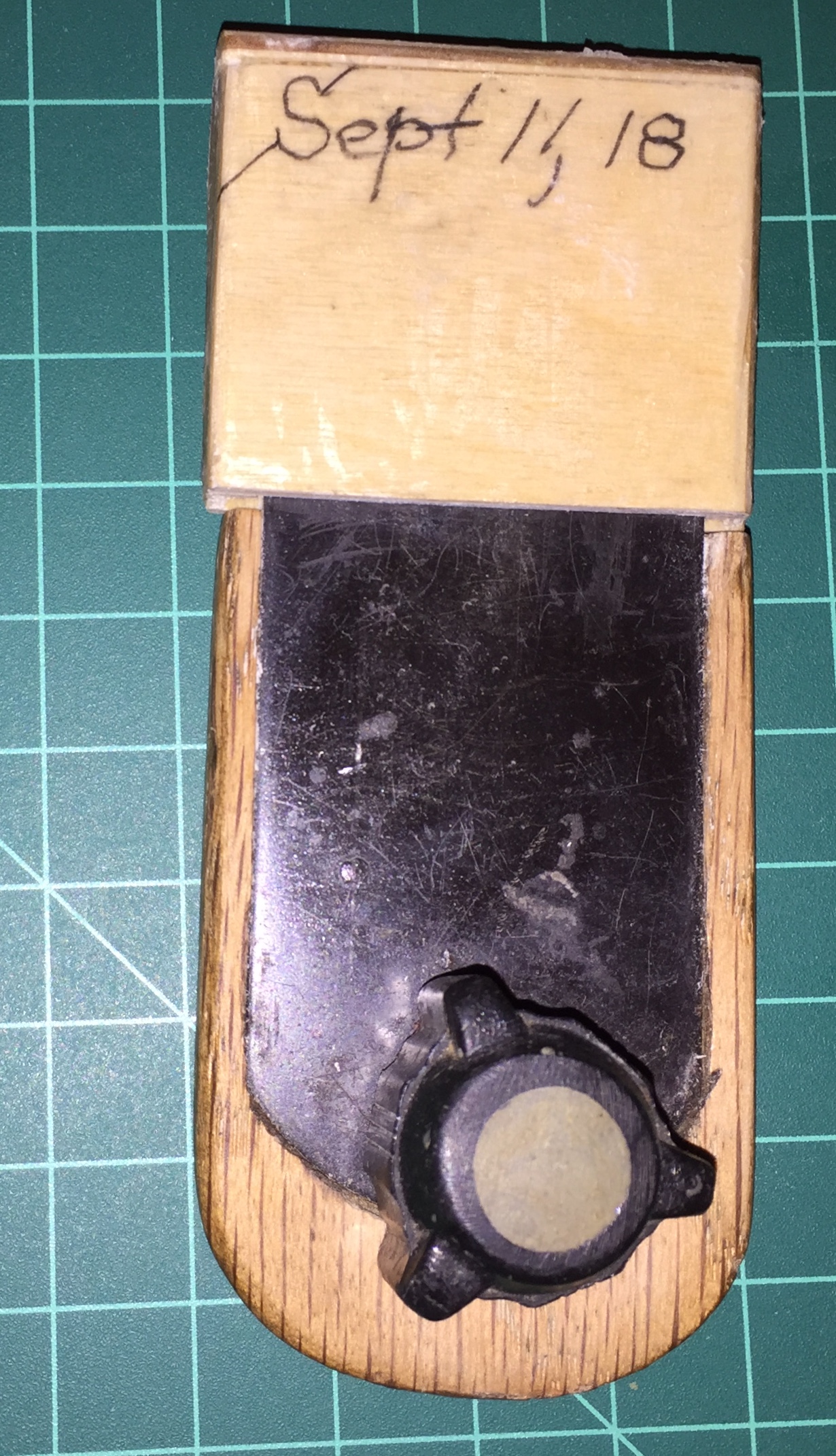

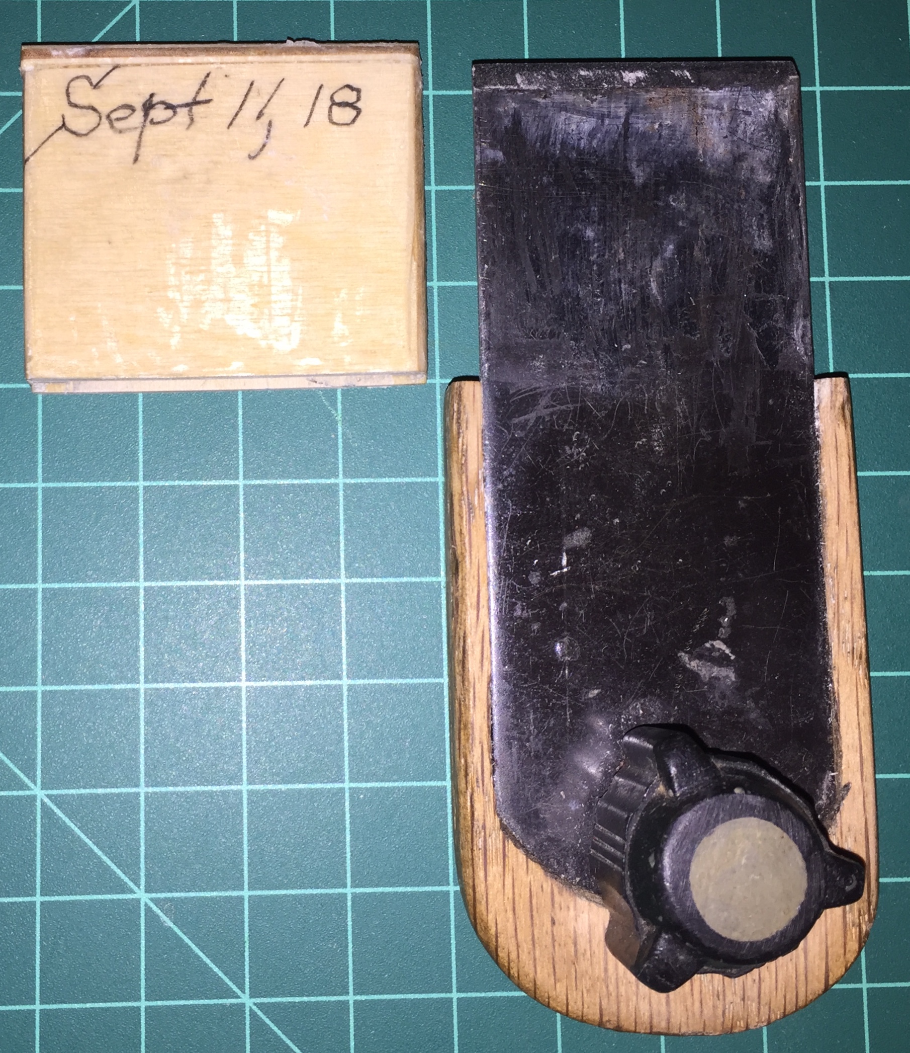

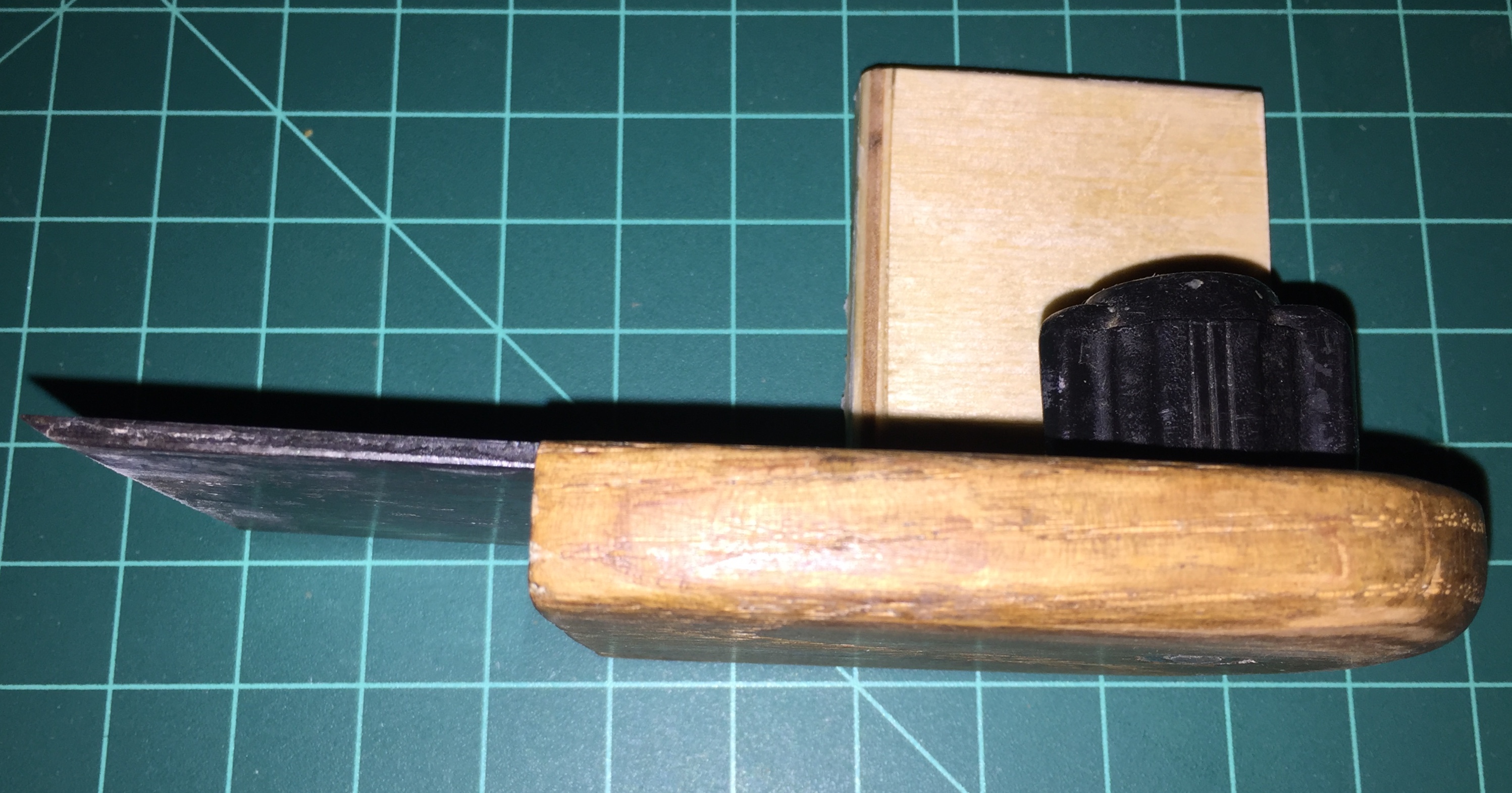

Here is a tool I made just for working on the Corners of Floors: they are difficult to develop to the same "Plane” or level that the floor is Sanded to.
The blade is simply a “replacement" for a Block Plane, made by Buck Brothers. I took a piece of Scrap Red Oak, cut off the bottom "grooves" from the wood, penciled in the shape of the blade, and used the largest Forstner Bit in our drill press to remove the wood to the depth of the blades thickness.
After testing the blades fit (a tight fit by the way) I then drew the hole of the blade, and then drilled it for the tri-star knobs thread.
I used a small Forstner Bit to cut the size of the hex nut, then simply chisled out the six corners. IIRC, the nut is Super Glued in as a "fail Safe" that it can not fall out, if I disassemble to sharpen the blade.
Unfortunately I have misplaced the Original Cap I made to cover the blade: It was also Red Oak, This new one is all Baltic Birch, including some Baltic Birch "Fines"
I learned to Save Sawdust from Every Species I work with, and Sift it until only a ~fine~ Flour like powder remains. Old Timers would mix that with Shelac to fill nail holes, knot holes or splits, etc. I usually pack the "Fines" into the problem, then a drop or two of Thin Super Glue fixes the dust into the pores of the wood Body!
