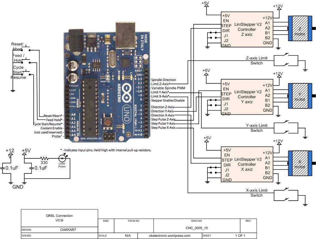

Attachment 12557
Image taken from
https://okelectronic.wordpress.com/category/grbl/
all Credit toOakkar7
This is perfect as its based on the Arduino Uno as a controller.
So you have 3 stepper motors and drivers for each axis, limit switches to stop the machine wandering off piste and that’s enough to get you started really.

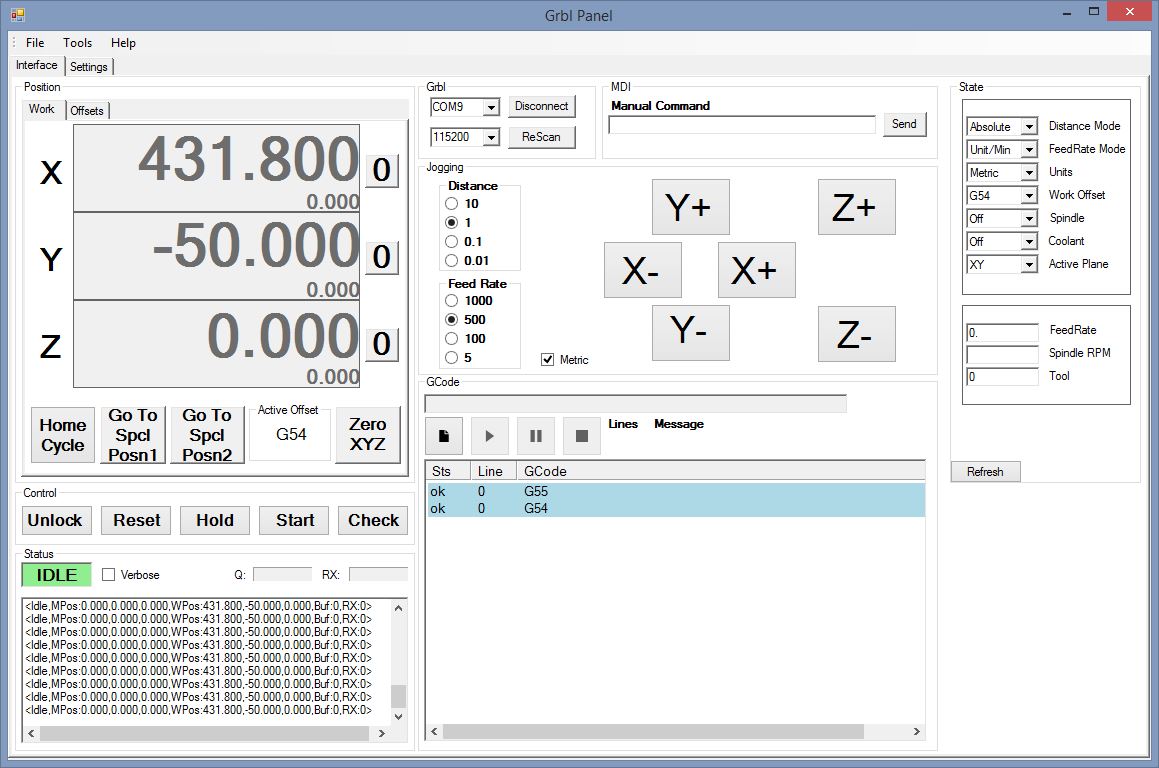

Install GrblPanel-Release-1.0.9.3
You should get a screen like this
Attachment 12558
In the top centre of the screen you can select the port where your Arduino is connected and underneath the baud rate for the communications this must be set for 115200.
When you press the connect button it should connect and make the remaining parts of the screen active.

Now what you are supposed to do is type in your values and just hit enter, I cant honestly say it worked so the alternative is to go back onto the Interface tab/button and enter the command manually ie type $130=330 into the manual command text box at the top of the page and click on the send button.
