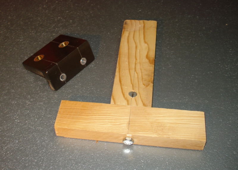

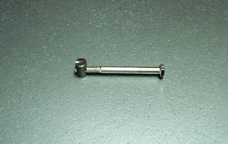

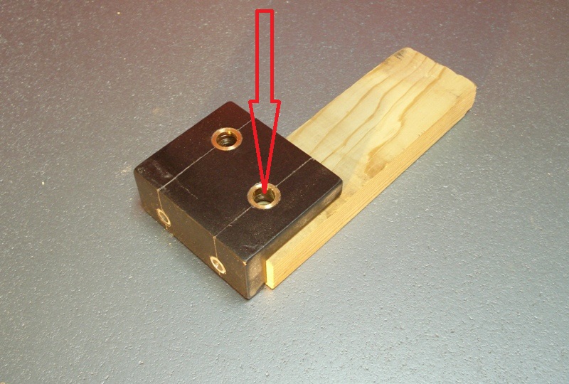

Cross dowel joints represent an easy, strong and practical way to assembly wood pieces, especially when knockdown joints are required.
There are commercial jigs for drilling the required holes (Cross Dowel Drill Jig). This jig allows drilling the holes for the barrel nut and bolt in perfect alignment.

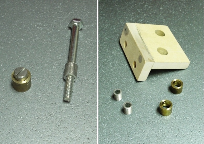

Here I show my homemade version. It was made in june-2011, with 1/2” MDF, with aluminum (ID 1/4”) and bronze (ID 13/32”) guide bushings.

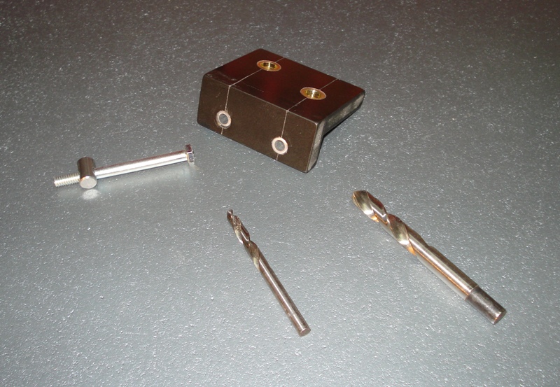

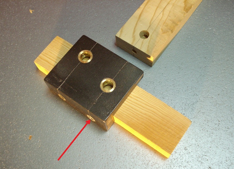

PROCEDURE:
1- Mark the centerline where the cross dowel joint will be located (both pieces). These lines will serve to align the lines in the jig.
2- Part A (inner): drill a 1/4" end hole for the bolt.

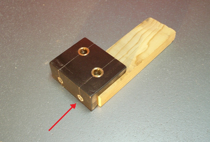

Attachment 17429
3- Part A (inner): drill a 13/32" face hole for the barrel nut. The center of this hole can be at 3/4" or 1-1/4" from the edge of the piece.
Attachment 17430

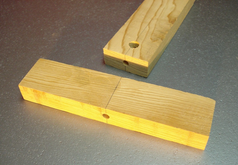

4- Part B (outside): drill a 1/4" hole for the bolt.
Attachment 17431
5- The joint is ready to assemble.
Attachment 17432
