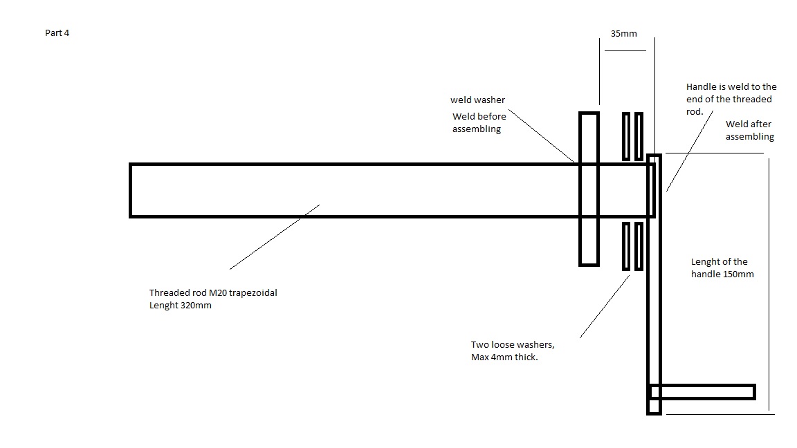

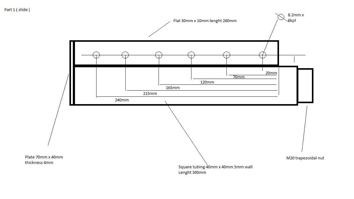

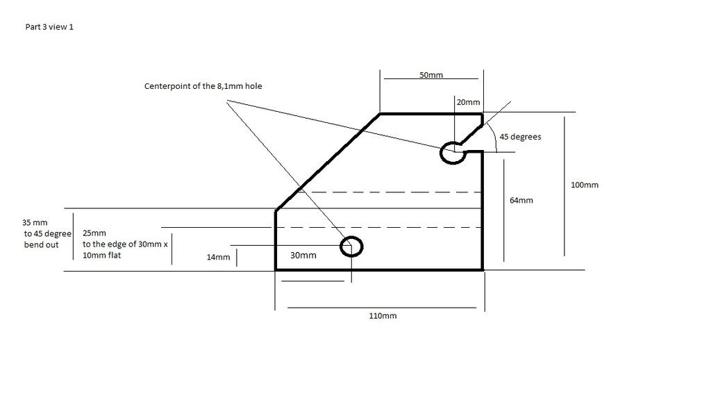

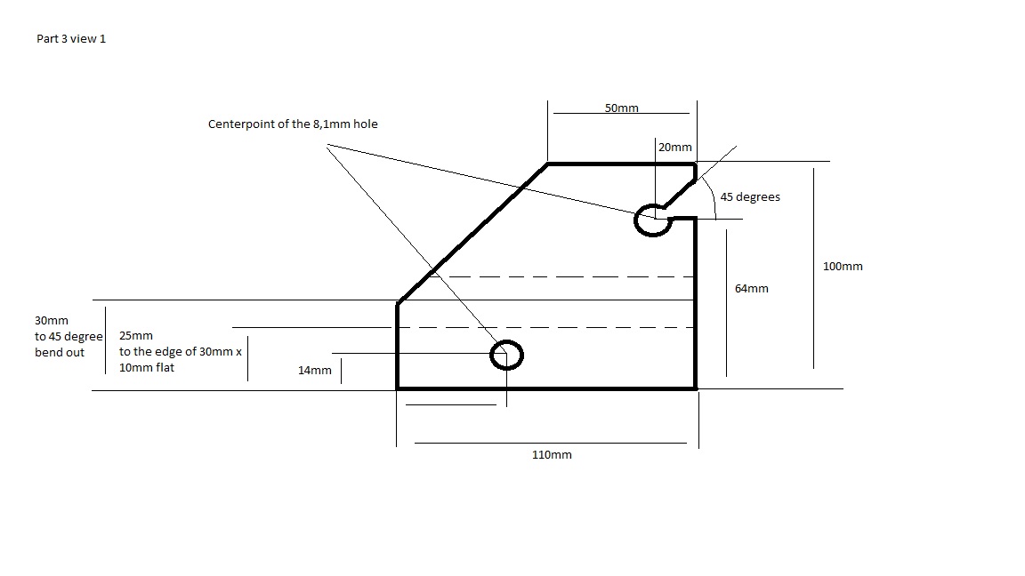

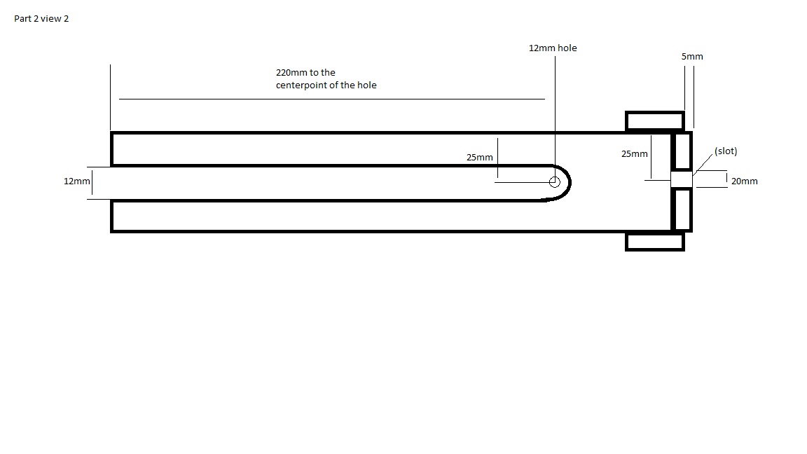

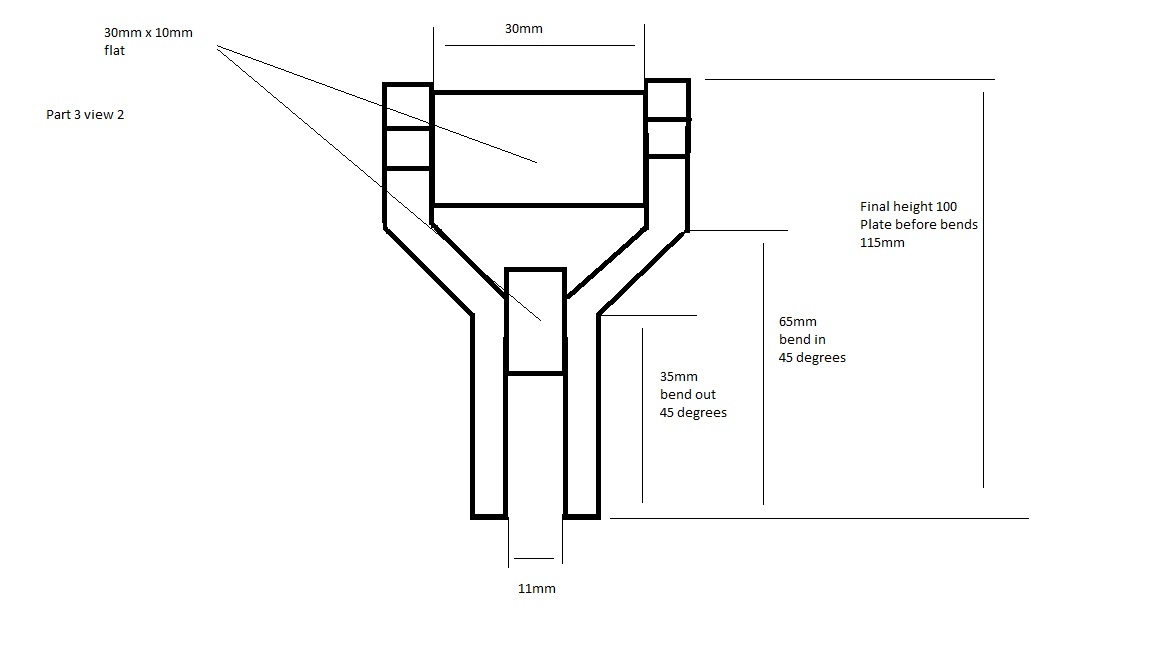

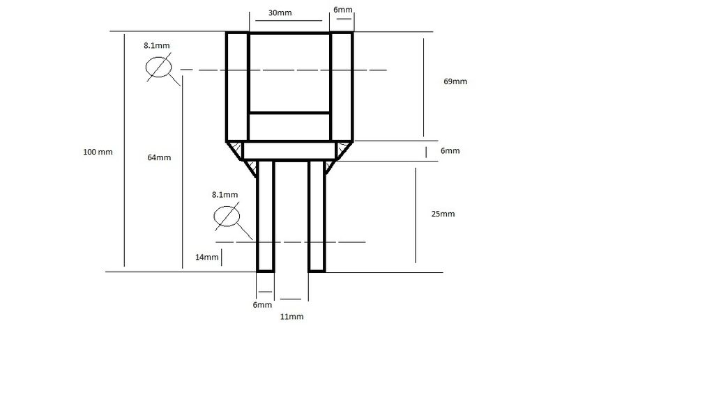

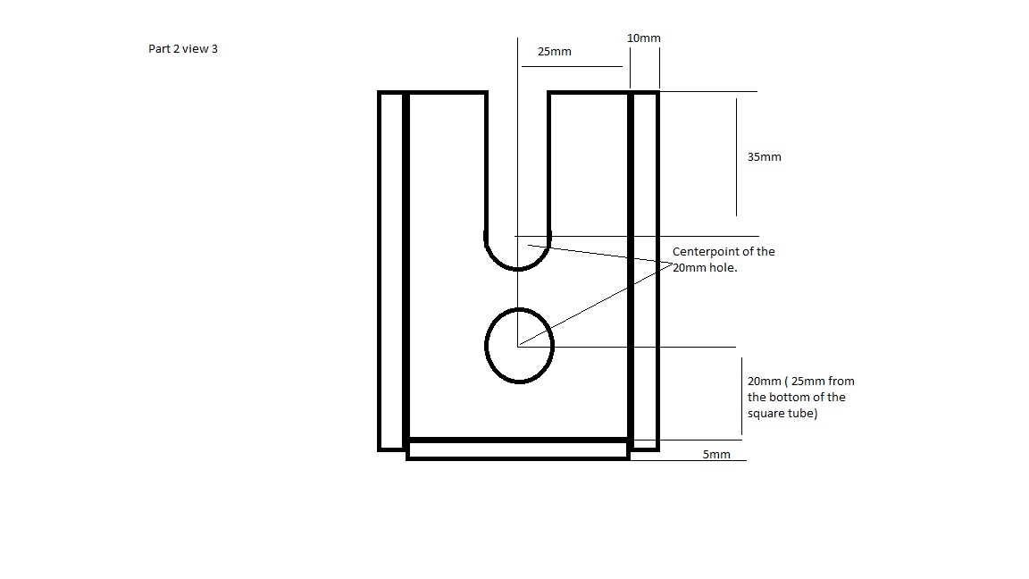

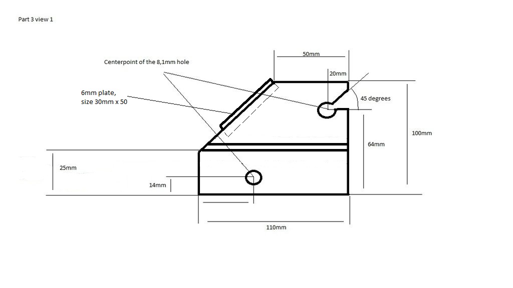

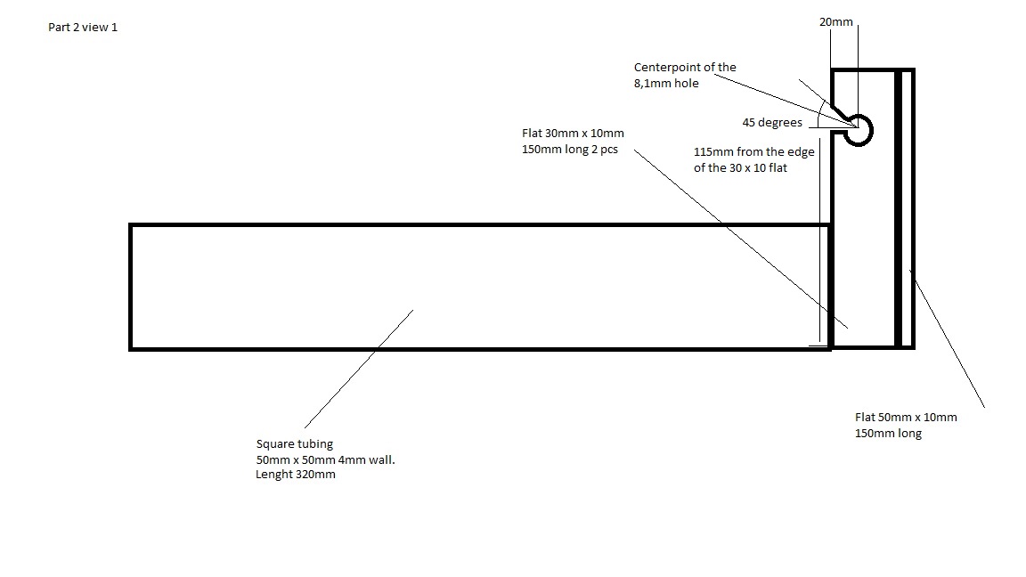

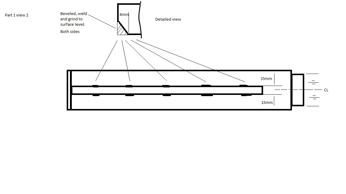

    Plans: https://www.instructables.com/id/Cut...7KQ0JNK930ZIOB
    Attached Thumbnails Attached Thumbnails Cutting bench / vise / clamp-part1.jpg   Cutting bench / vise / clamp-part-1-view-2.jpg   Cutting bench / vise / clamp-part-2-view-1.jpg   Cutting bench / vise / clamp-part-2-view-2.jpg   Cutting bench / vise / clamp-part-2-view-3.jpg
    Cutting bench / vise / clamp-part-3-view-1.jpg   Cutting bench / vise / clamp-part-3-view-2.jpg   Cutting bench / vise / clamp-part-4.jpg   Cutting bench / vise / clamp-part-3-view-1.jpg   Cutting bench / vise / clamp-osa.jpg
    Cutting bench / vise / clamp-fbvs0mlk8zzazpx.large.jpg   Cutting bench / vise / clamp-jpegkuva.jpg

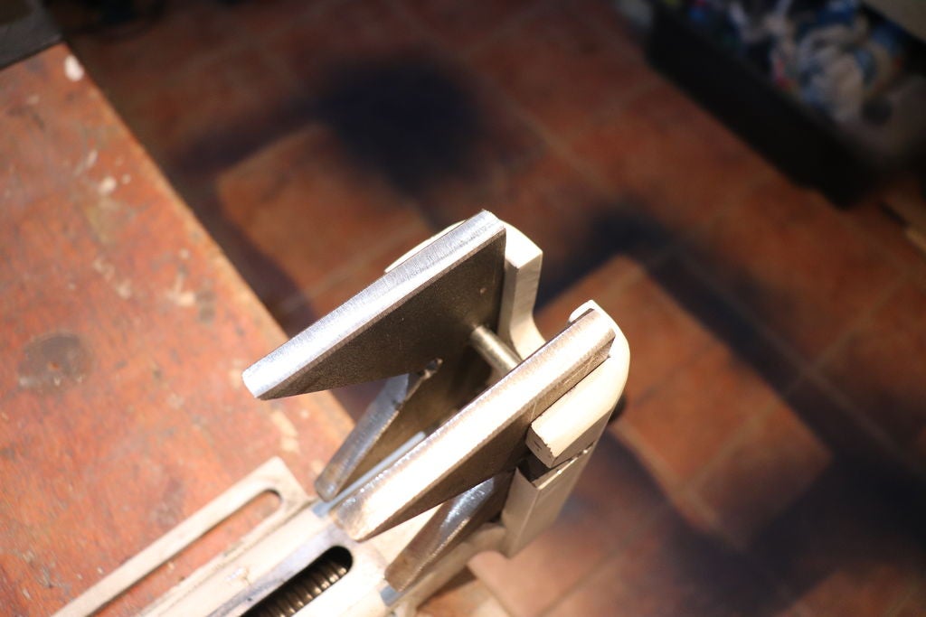

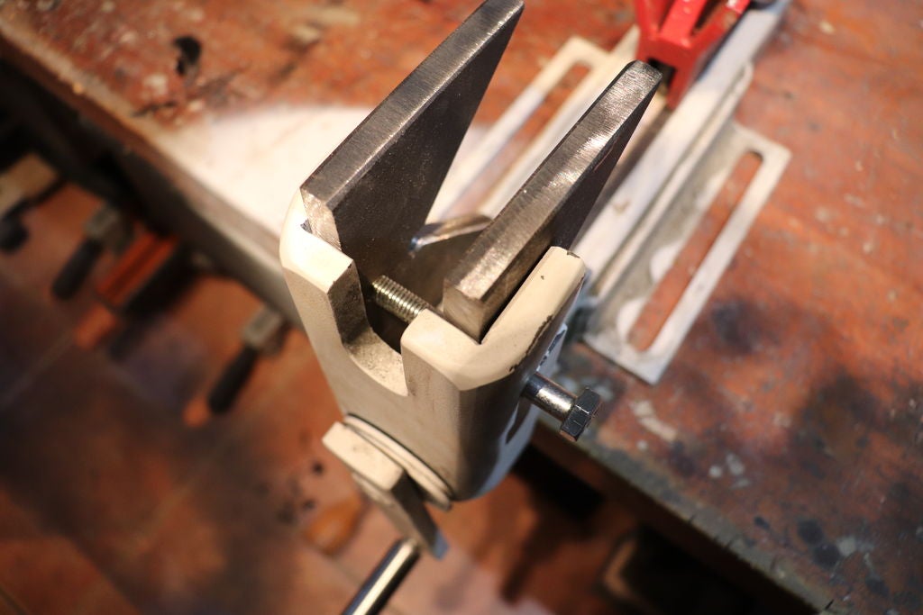

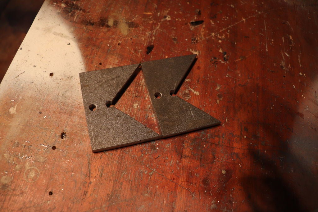

    Here is the firsts optional jaws.
    Cutting bench / vise / clamp-fk83fvxk9310ihf.large.jpg
    Attached Thumbnails Attached Thumbnails Cutting bench / vise / clamp-ffcnxlgk9310ihj.large.jpg   Cutting bench / vise / clamp-f9moas8k9310ihg.large.jpg   Cutting bench / vise / clamp-fkbqpk3k9310j4j.large.jpg

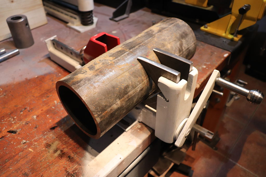

    Quote Originally Posted by Tuomas View Post
    Thanks. Its simple to make too.
    Hope that fever is gone, it isn't something you want to get right now.
    This might be a simple machine but it could easily be one of the better ideas I've seen on here for anybody involved in fabrication. The problem with traditional vises is that they really don't hold structural shapes well. I can see where your half Vee jaws would make for a far more secure hold on square tubing, especially lighter stuff you don't want to deform.
  11. #19
    Jun 2016
    Jyväskylä Finland
    832
    558
    Thanked 1,841 Times in 507 Posts
    Tuomas's Tools
    Quote Originally Posted by wizard69 View Post
    Thanks. I am fine now.
    Half v works with plate's too. It could work nicely in drill press vise.
    Machined & hardened jaws with accurate half V slots could be useful in machining too.
