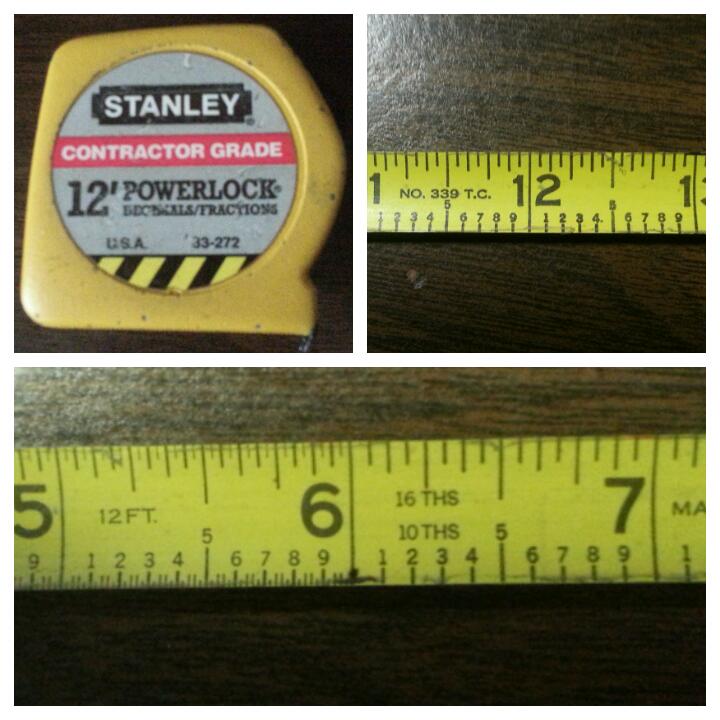

    Hi Rick, I have had the "contractors grade" 33-272 (yellow, better case) and it is graduated fractions on one side and decimal on the other. The fractional side is in 32's up to 6" and 16'ths there after. On the decimal side it is in .020 up to 6" and .1" there after. Mine does Not have "Foot" marks. I love this thing and had it for years because I think in decimals and is great for shop eyeball use...otherwise I use a 16R scale. To me the 20thou scale is what I grew up on in board drafting back in the early 80's and easy to use.
    If you read the review at the bottom of the the Amazon link the guy named "woodworker" from 4/1/07 states the above but seems confused about the first foot?
    Here are a couple of links for the one I have. Prices are all over the board, but could not find it on Stanley's site. Think I got mine at McMaster at least 12 years agoż
    From BisonOffice
    From Overstock.
    Not sure of the relevance of the video. Even with the foot markings it is still in 10ths and think the foot marks just confuse the issue. If I have to measure anything over 144" I break out the big guns and really don't want to know decimal inches. LOL
