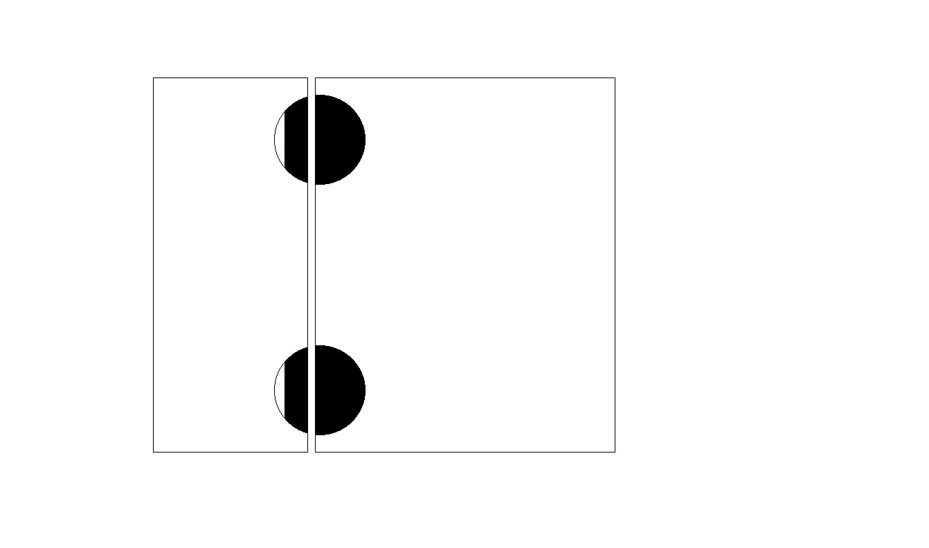

Also here is something to consider with these round dovetails.
We are reaming the holes so the hole will be ever so slightly bigger than the rod.
Attachment 18554
Exaggerated the size difference for show, you see the pin and groove mate in one area.
Now having assembled the toolpost, what if I rubbed the side with the pins on a piece of wet and dry on my surface plate?
Attachment 18555
By making a flat on the edge of the pin the groove now seats on the rod in two places instead of one.

Distributing contact is a good idea, such you might get flattening the front of pin. I'd think reaming pin size plus .0005 or .001 will be very good alignment and repeatability.. With access to CAD or some calculating offset of the reamed contour/ pin size would reveal ideal combinations. By offset, I mean percentage of 'hole' remaining and protrusion of pin. Clamping has to be on the Radii, not face of post. .030 clearance wouldn't hurt a thing. Reamers by the way are available in near every diameter desired.
[edit additional] occurs to me that enough flat to get contact at 45 degrees would be worthwhile.

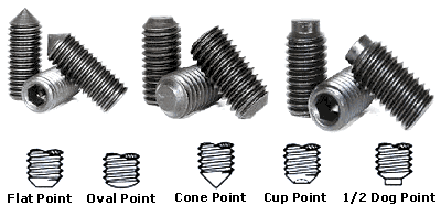

Retention of bits in general, coarse threaded set screws are more common, but my preference leans to fine; more secure with the same amount of torque. I'd want 3, spaced for the bit length you use, corner obviously works either direction. Use dog or flat points not cupped, they mar tools. Advantage to dogs, when they mushroom and they will, they're still removable.
If you use square heads and a nice little wrench, it's better than a socket filled with chips. Possibly better feature is durability, the square head employs far greater wrench engagement. Ever round out a hex socket? Ever see a worn square; sure, from horrible abuse.
Attachment 18556
Buy a whole box if you can, they don't go stale or shrink, but cost is sure to rise.
"Advantage to dogs, when they mushroom and they will, they're still removable."

Somehow I neglected responding to the question...It seems one of two things.
1 is only the block shown doesn't extend beyond side of post, inhibiting a parting tool. Yes, the drawing focuses more on the mechanical QC aspect, not block features.
2nd, the minimal alignment in two parallel lines of contact almost guarantees binding when pressure pushes down on block/ toolholder combination. I'd still ream size for size with 60% something offset of the pin in post. That will retain them [dowels are +.0001 or .0002] in post. The holder cavities will then engage outer extreme remaining 'edge', reducing movement perhaps 400%. Clearance would remain at face of post and holder, .010 sufficient. Flats on pin faces directs alignment to wider point of diameter, without gripping the full half.
I've prepared an exaggerated sketch.
Attachment 33015
