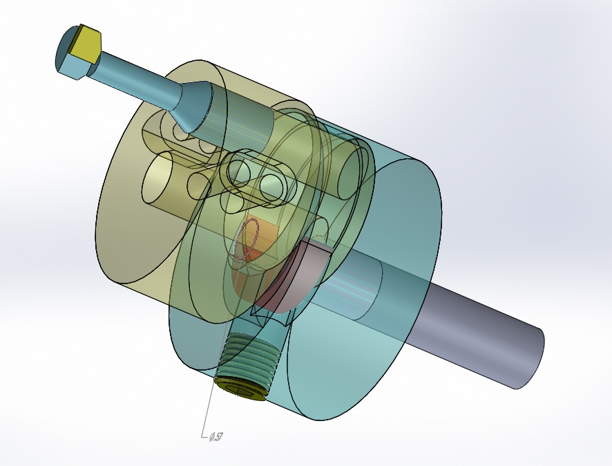

    I did a cad model of the boring head in Solidworks I looked at trying to use a bolt to lock the 2 parts of the head together but with a double eccentric there is no common center-line so the crescent lock key was about the only solution tapering it would not have improved it but placing 2 spaced 120° apart would have done some and if I see there is an issue later on I may add another groove and a 2nd lock as the head is figgley to make fine adjustments

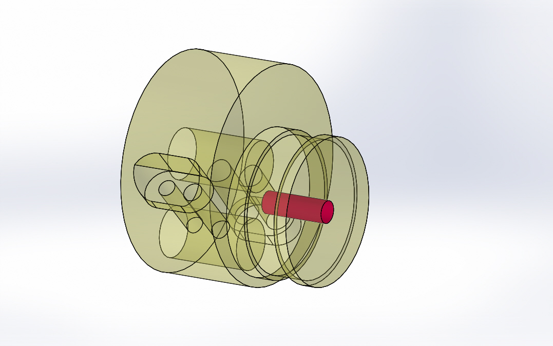

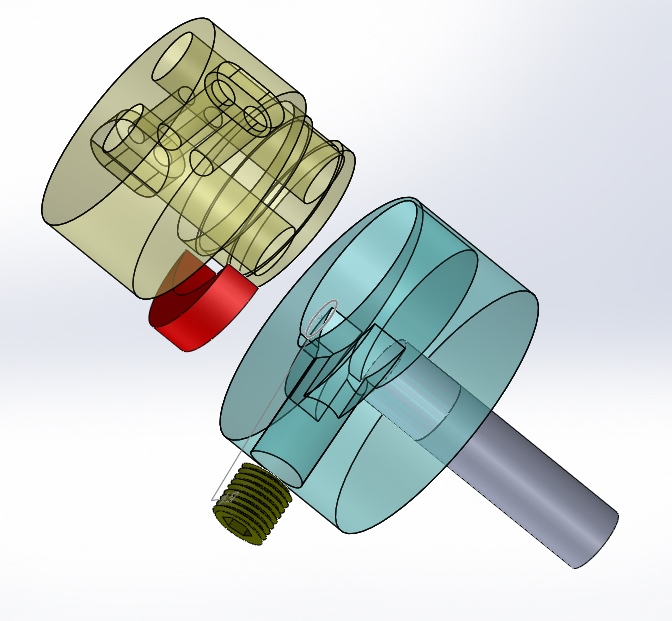

    the jpegs of my drawings may help to see how the assembly is put together
    You are correct if I were to drill through the main body on the center line of the bore for the tool head there may be just enough room to place a socket head bolt and drill / tap the tool head on that center-line as well
    Thanks sometimes we don't see the forest while standing under a tree

    the tool head toes not have the tooling locations drilled all the way through so it is possible to add the set bolt
