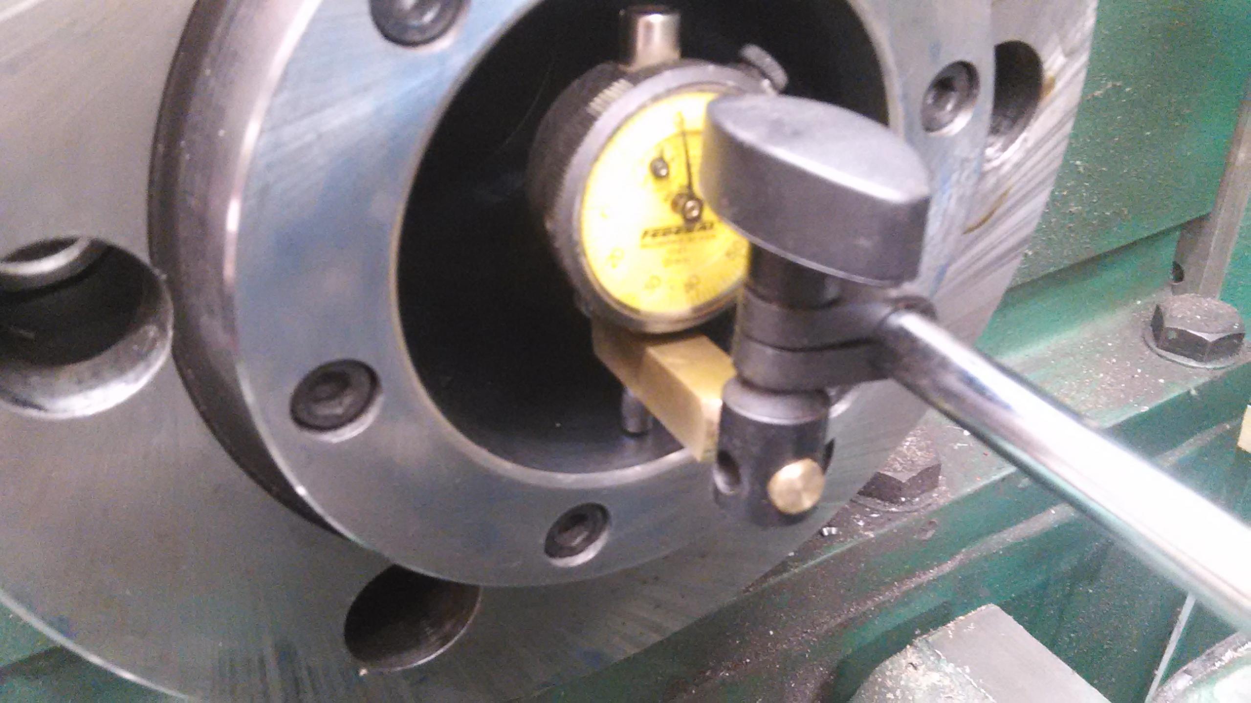

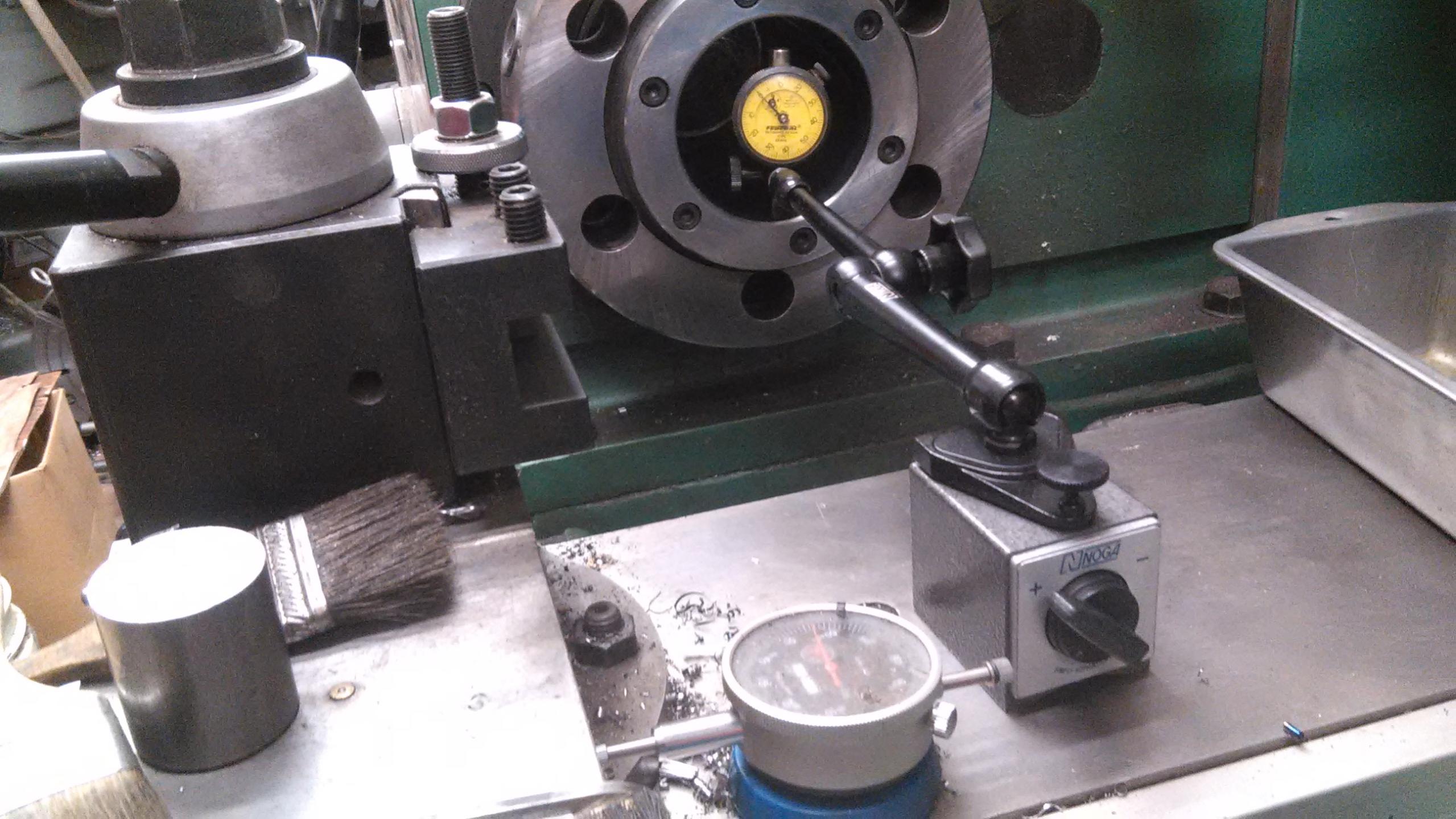

    My recent work with measuring the taper of my lathe spindle drove me to purchasing the Noga as it has the stem clamp.
    Noga which let me see the indicator during the sweep of the spindle taper:
    Digital or dial indicator on height gauge-2017-03-29-noga-indicator-holder-002.jpg

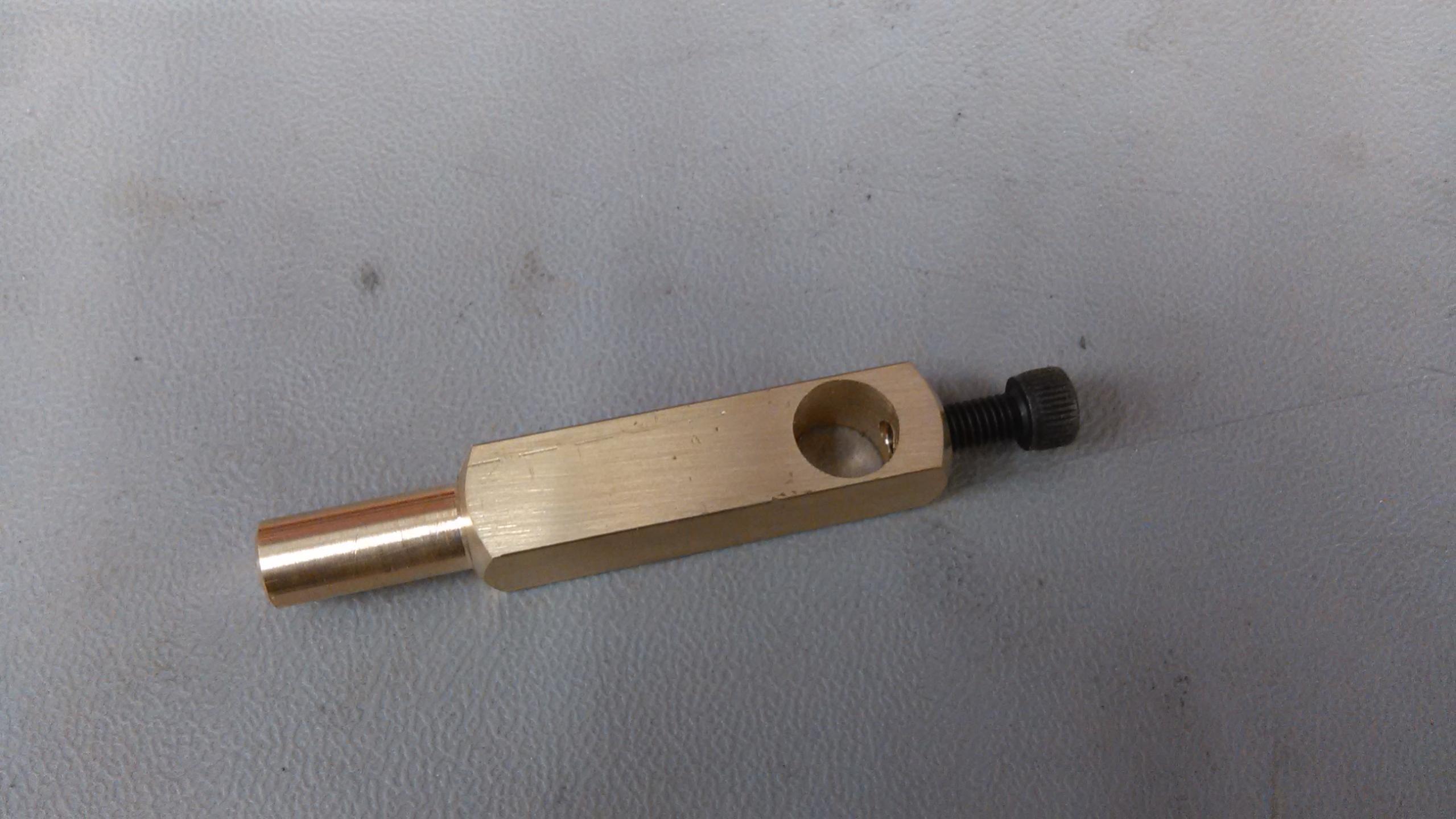

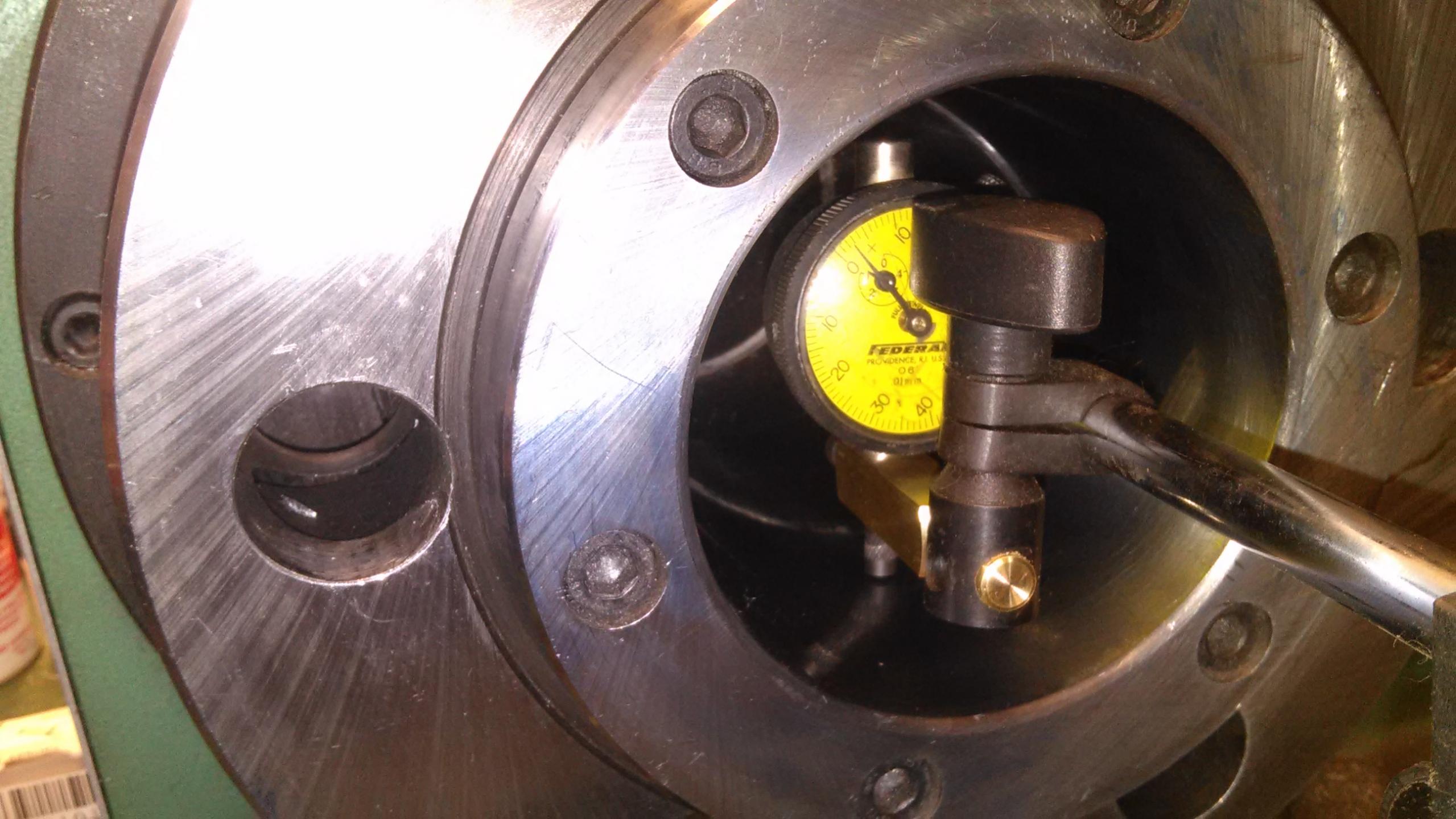

    This was the previous attempt, so I made this tool with a 3/8 hole for the AGD indicator, but a metric round end for my existing mag base.
    Digital or dial indicator on height gauge-2017-03-27-3eighths-adapter-ebay-order-angles-038.jpg
    This made reading the indicator during the sweep difficult. That damn snug in the way. But real problem was the cheap holder, which was too compliant, and as the indicator spring forces increased, the compliance produced measurement error. This indicator only has 2.5mm of travel. It's a bastard AGD-1 but metric reading (Federal brand green dial indicates metric). It does not have a lug on the back, but that mount would not work for this use.
    Digital or dial indicator on height gauge-2017-03-27-3eighths-adapter-ebay-order-angles-047.jpg
    I learned a few things, I found a youtube video of a guy in Australia that was regrinding his mag bases as his complaint was every one would 'rock' on a surface plate. I also had this problem, as mine were from the same manufacturing location (and low cost, ~$12). For simple runout measurements, it's all relative but make a absolute measurement where you need to know the error, and I found cheap to be avoided. So I splurged on the Noga (could buy 5-10 China imports for it's cost). But they only sell AGD Noga in USA.

    I finally got so discussed with my China import holder, and seeing the many reviews on youtube with extreme positive Noga, eBay had best prices $98 for DG10533. The bottom zero is worth every penny. And using it the first time to measure the taper of the lathe spindle made me a believer. I'm trying to find the same size equivalent but European standard DG10503, but the price I'm seeing is $228, too much for me.
