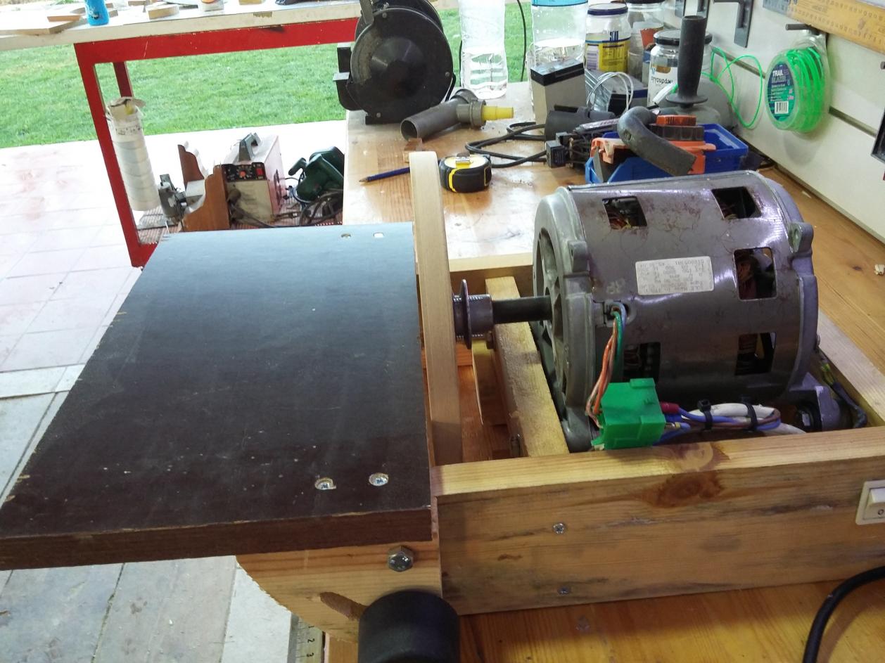

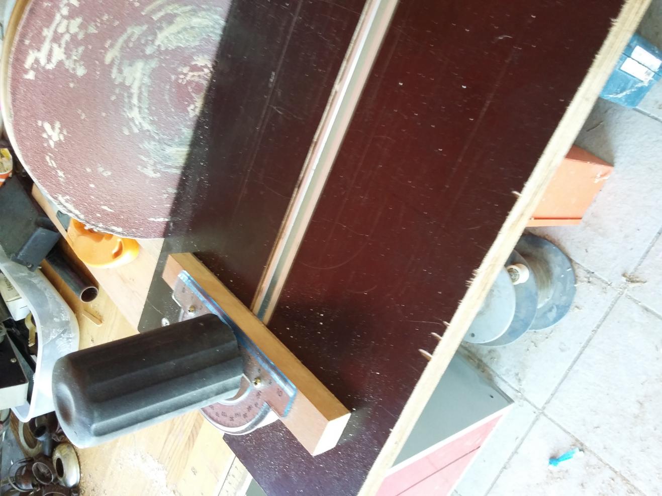

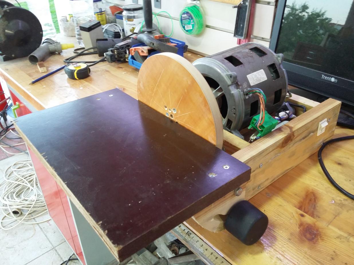

    disk sander from motor of old washing machine.

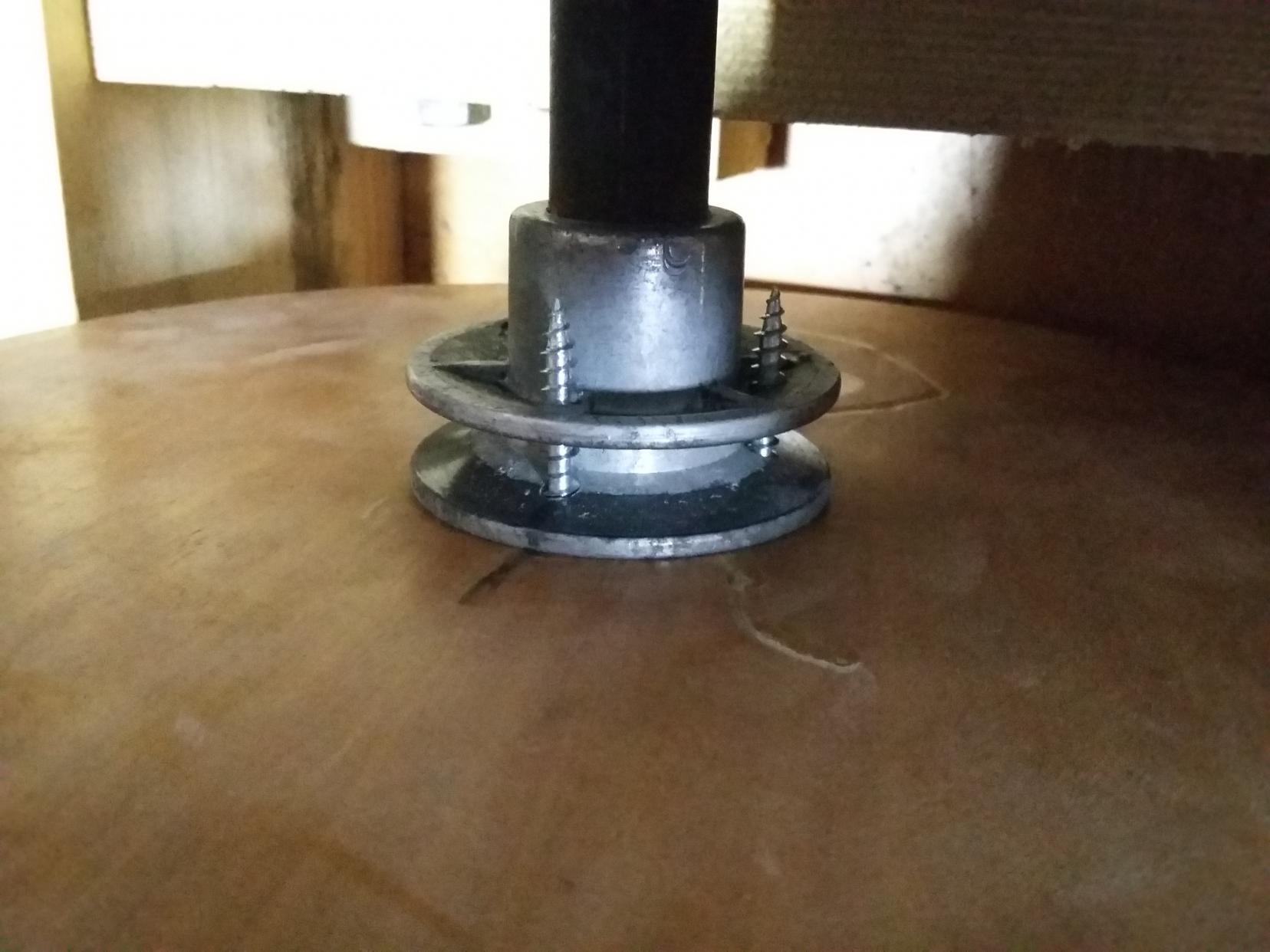

    Quote Originally Posted by rep View Post
    Nice! How did you attach the disc to the old motor? I have a dozen old motors like this & would like to use one or two of them for something like this.

    Quote Originally Posted by Edward Norton View Post
    screw a cut piece of wood to the driver, and I did lathe to smooth the perimeter
