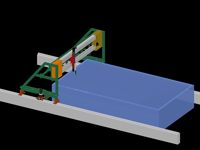

A few years ago, I made a CNC oxygen cutter. More than three years ago I worked without problems.
X = 12m
Y = 2.2m
Z = + 300mm
* Mach3
TB66000
NEMA 23 495 oz
Construction weight about 700kg
Attachment 19284

can you share the plans or how its built?
