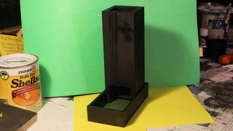

FREE PLANS in pdf format (BOTH IMPERIAL & METRIC DIMENSIONS) – Download Info Below.

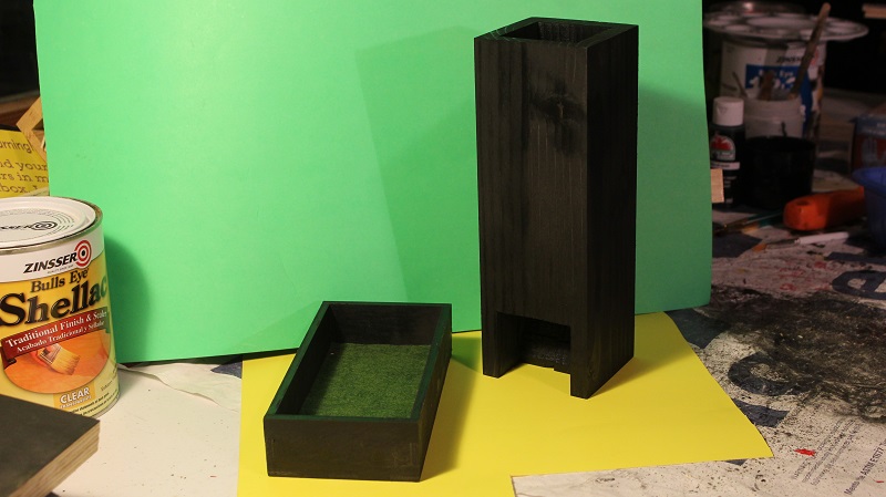

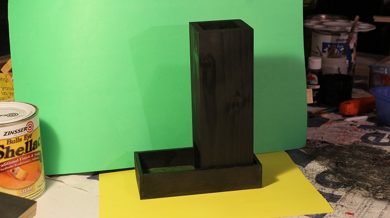

Dice Towers are a gaming accessory that has become quite popular these days among gaming enthusiasts. A gaming tower contains a series of baffles that cause the dice to rotate and spin randomly when the dice are dropped into it. The dice emerge at the bottom of the tower and into a dice tray.
I made this one at the request of a local friend, and I’ll show you how I did it in the video I made while building it. This particular dice tower was made using 2 pieces of 2x4 framing lumber, each 9” long. The pathway and baffles for the dice were carved out of each 2x4 (mirrored images) and the two pieces were then glued together. The dice tray was made with ¼” plywood underlayment. I used box joints, but this is not necessary. Butt joints with glue will work just fine.
I used my X-Carve CNC router to help make these items, but I have drawn the plans for use of conventional wood working tools. If you do have a X-Carve machine or other CNC machine and would like the files I used to make this set of gaming accessories, I will publish the files on the Inventables web site under their PROJECTS heading. The link to these files will be posted below as soon as I am able to publish them with Inventables. IF you don’t have Easel, it is available free through Inventables.com
