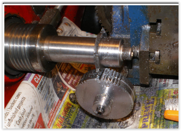

A very nicely made example of this tool, I enjoyed your video and explanation of the workings of it. I have the Ivan Law book but have not yet made the Eureka tool, I have been using the 4 tooth offset method you mention at around 15 mins and have made many usable cutters with that system the last ones were for my milling attachment.Attachment 27850
Thanks tmoore4748...Ivan Law's book Gears and Gear Making has a set of plans on the last 3 or so pages of the book. I used these drawing to build the tool. There are no building details there though. The project is pretty straight forward. I am putting a construction video together right now as I took lots of video while I was building. It will be a "show and tell" video as there are lots of approaches to this build. Then I am going back to my grasshopper clock build for a bit (see my U Tube Channel) but will then make a 3rd video on the Eureka tool where I'll make an involute gear cutter with a button tool and the Eureka tool. Thanks again for your interest...bob
