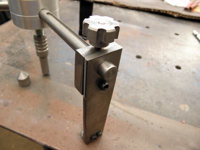

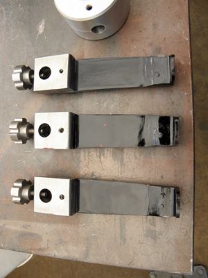

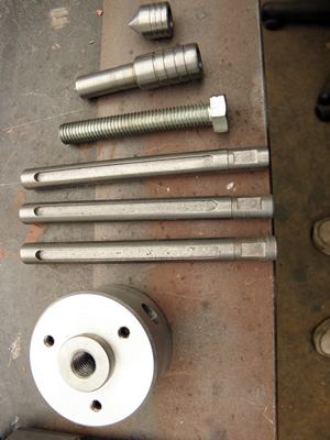

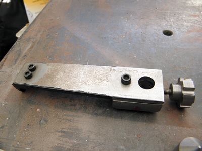

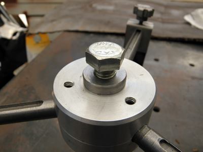

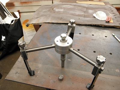

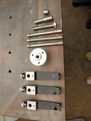

Adjustable DIY Machine Pulley Puller
This is made of Cold Rolled steel,aluminum on the lathe and mill.
Attachment 2181Attachment 2182Attachment 2183Attachment 2184Attachment 2185Attachment 2186Attachment 2187

Yes, nice, I need one for my metal lathe, the gears are difficult to change, this would be perfect !
hi this looks great! is there any drawings i can use? Thanks
No drawings but I can give some basic measurements.
center aluminum with metal insert is 2 inches dia. the center bolt is 1/2 inchs 3" long.
the three round connecting rods are 1/2 inch x 6 inches with grove of 1/4 inch wide and 1/4 inch deep.
the claws are made from 3/8 inch x 1" steel tapped and screwed to the 1/8th inch extension that have the claw, the rest you can get from the photos. ENJOY>......:O)
