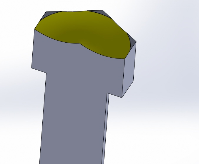

    Interesting idea! Now you've got me wondering, to get more assortment in hole sizes, if using the head of a grade 8 bolt, properly dressed on a grinder, pressed into a six point impact socket, could punch a hex shaped hole in the same sheet metal? If so, I think there are sockets made for square head bolts, too. That could provide an assortment of square hole punch sizes. With reference to how the punch for a rotary broach is ground, would grinding a concave in the socket-extension punch (or bolt head bunch, if that gets proven to work) help the punching operation? It would extend the 4 or 6 points of the tool out into piercing points to start the punch penetration.

    As long as the material is softer than the punch and die this will work the correct profile of the punch would resemble the picture below
    thick wall impact sockets would be best even if they were Chineseium and the material was not too thick
    Function-wise and incidental usage yes. From a practical viewpoint, almost. I haven't much time this morning but offering a few details.
    1. The hollow grind [punch] will cut, though suspect a short service life. More common shape is a shallow 'rooftop', or angular punch and stripper.
    2. Top of socket [die] will need a shearing edge as well. Condition of die has more to do with result than punch.
    3. Actual dies are tapered some what under shear-edge to release the slug. Parallel area is termed die life, to sustain repeated sharpening.
    4. Without taper, the slug will stick in the effectively blind die. An undersize slug atop a stout spring may eject it. A lot like the plug retained in a hole-saw.
    5. Decent cut and limited burr achieved with correct clearance; difference between punch and die, usually described 'per side'.
    6. Means to secure orientation of both hexagons will be needed; rounds aren't so particular.
    What advantage comes from raising the center of the bolt head, as you are showing?
