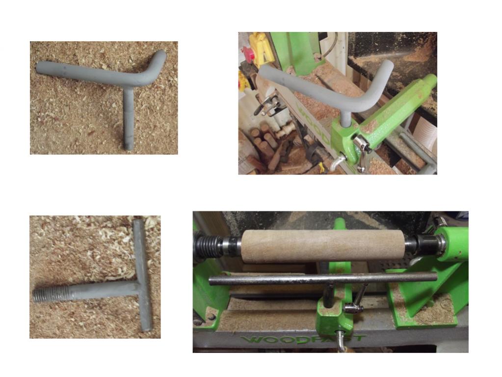

    Hi everybody.
    As I've mentioned before, I'm a wooden toy maker/wood worker and pretend wood turner. Since recently aquiring a small workshop area (3m by 3m shed) just for metal work, I decided to make a few tool rests for my wood lathe.
    The steel was cut to size (the bent piece was already that shape) and then cleaned - wire brush/grinder and arc welded (?stick welded??) to a bolt that fits my lathe banjo.
    The top two piccies are of the same rest - about 200mm on the longest side. The bottom left is a small T rest of about 100mm and the long doodad rest is about 350mm long - allows me to turn a wand without moving my banjo - yeah, I'm lazy
    When I welded each piece I also ground back the welds to check to make sure that I had plenty of melted steel (forgot the correct terminology) - welder friend of mine suggested it. He said if I do that often enough I'll turn into a decent welder rather than the best metal grinder
    Anyhoo, enjoyed myself playing with a welder. A bit addictive, non?
    Regards
    Doc

    Well done Doc, I have to do some also, but makes me thinking that I have already done one, a piece of art of brazing job
    I have to show it !
    The shape I would like to do is a rounded shape to get inside bowls.
    But for the moment, I have some difficulties to find some good diameter round stock (without purchasing)
