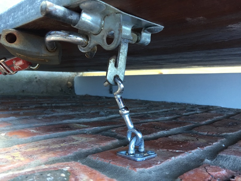

With the windy season starting I needed to put a latch on the workshop door and did not want to go out and buy something .
Found a very short hook and soon established that I would not be able to hook it into the conventional eye you get with this type of hook
:headshake: :idea:
My solution. Drill a hole through the locking bolts tab
Attachment 24554
I did turn that picture the correct way before saving and posting it :headscratch:

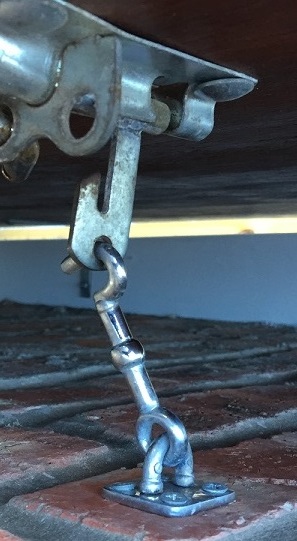

Attachment 24600
Even made it landscape shaped....It still jumps 90 deg :headscratch:
Pictures sometimes have a mind of their own when posting them. A lot depends on the width versus height ratio.
Nice work. Hope your winds are not as severe as ours or your brick is cactus. Guess those are solid bricks in SA where trees are few except 4 all the olive tree weeds.

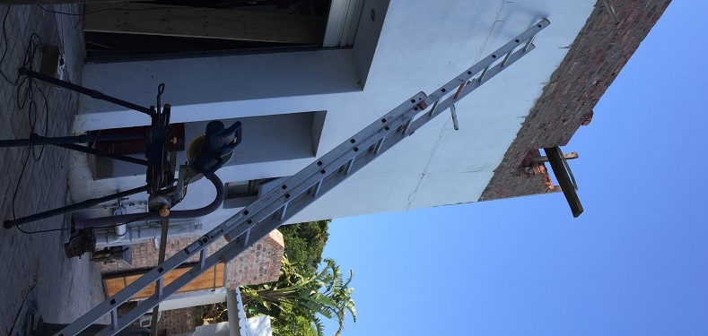

We use a lot of cement bricks here as well. Due to the fact that they have almost the same expansion coefficient as steel and with Our fairly large temperature shifts between summer (45 Deg) and winter (0 Deg) here at the coast even more severe inland, that is important to prevent cracks when combining the building materials.
My point was the cent bricks are also heavy on the hands. 2 sets of gloves to move 1000 bricks from ground level to the next.
Attachment 24587
Did it all myself with one or 2 guys to help with mixing and holding :lol:
Again one of this pics that falls over by itself, hopefully not my building
Sounds like your building/home would withstand cyclones/tornados. I used to labour for brickies on weekends (had three jobs to repay a debt, cleaning at night and admin during weekdays) and would destroy a pair of short welding leather gloves each weekend.I learnt quickly to get the "mud" mix right. On my first day, as I started on the top floor of a highset and throwing the mix up to the mud boards needed the perfect ratio:too sloppy & I would need to clean the wall below as well as myself & too dry; it would stick to the long handled shovel in midair or go "karplonk onto the previous mix. I was pretty fit keeping 3 brickies going: mixing mud & throwing bricks & cleaning & raking/round jointing etc. Very good LIFE-LESSON.

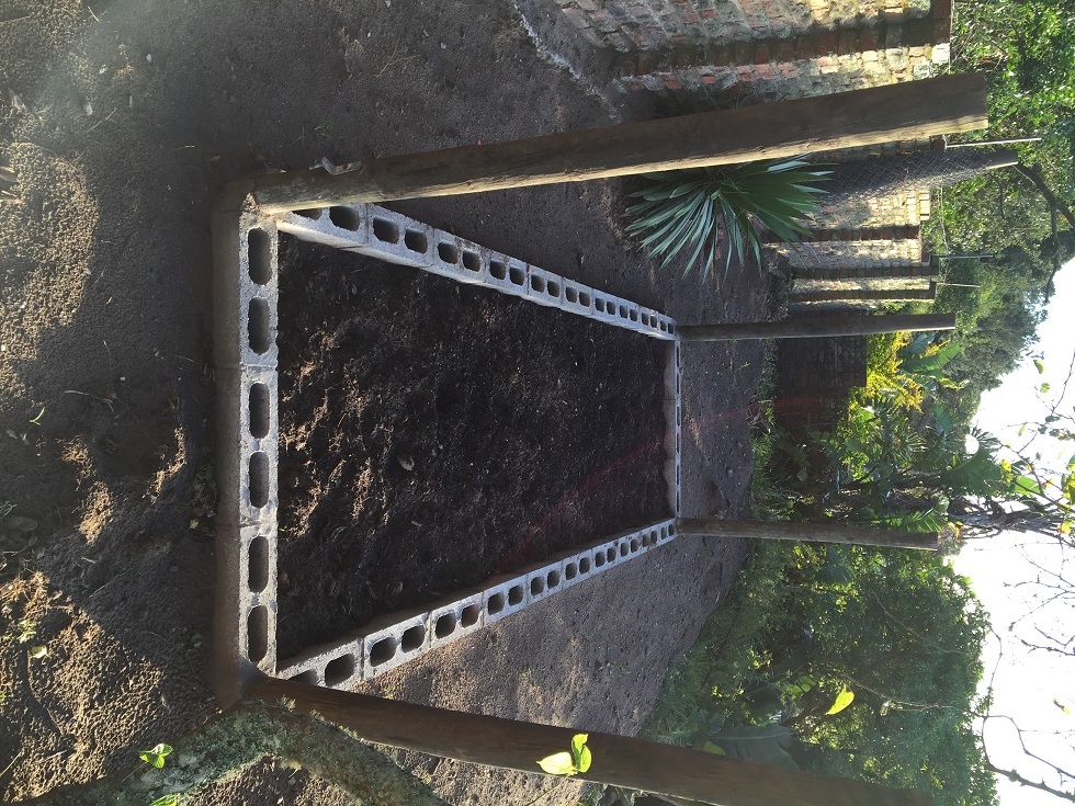

We also use cement block here about the size of 1.5 bricks long and 2 high. Here I used then for a vegie pad.
Attachment 24599
In winter I cover it with thick plastic sheeting.
