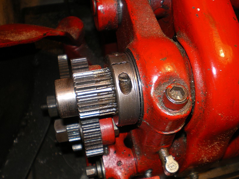

    Hi Canobi, you must have a guardian angel to find that quill on ebay. Had you not been so lucky could something like this have been an option.
    It is the end float adjustment on my SB lathe and has worked fine for over 60 years, it is a split threaded nut.

    That's a great idea actually, good call olderdan
