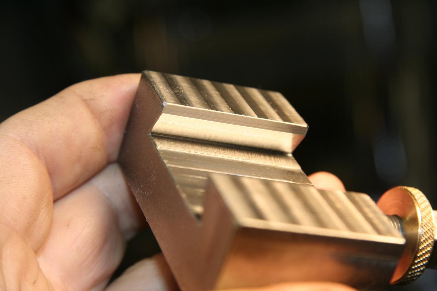

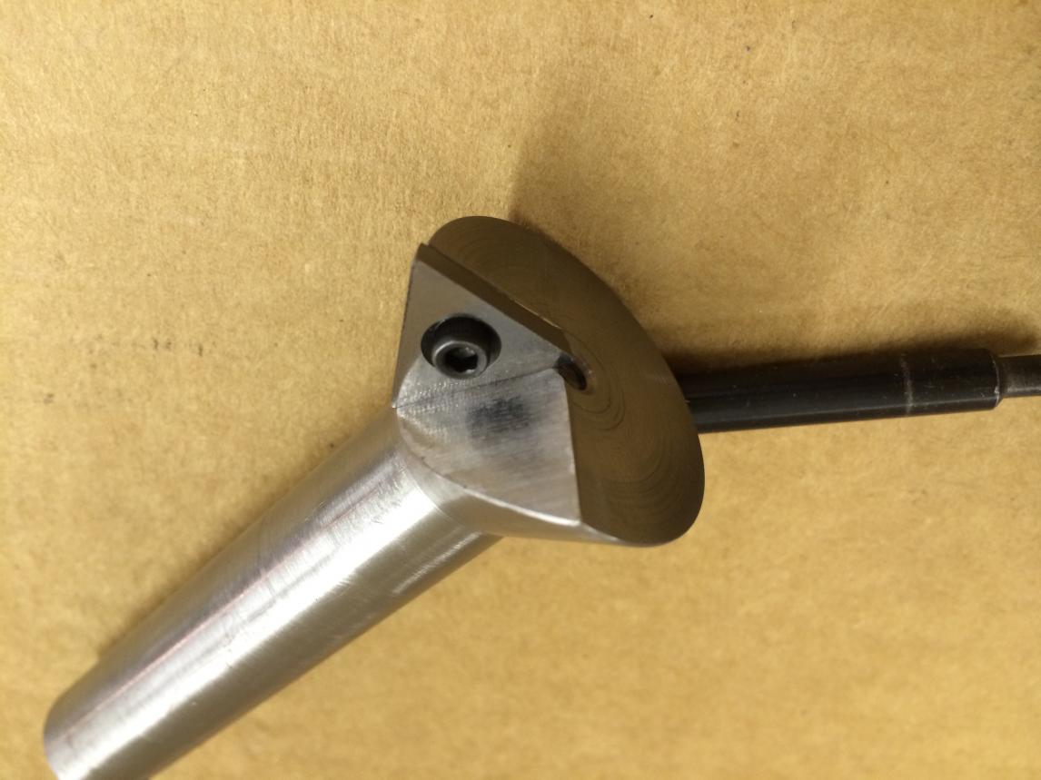

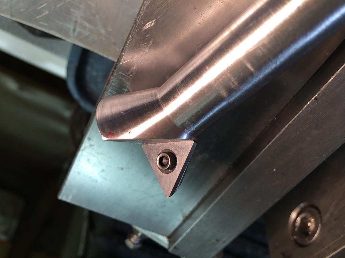

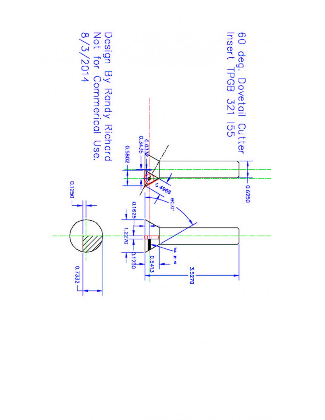

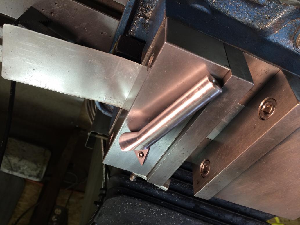

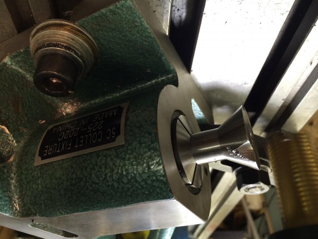

60deg. Dovetail cutter using a TPGB 321 insert. Tool made from a chrome moly alloy, landing gear bolt from an S-64 helicopter. The bolt was a NAS 636A 1" x 3.125". Shank 0.625, Base Dia. 1.227". Attachment 1800Attachment 1801Attachment 1802Attachment 1803Attachment 1873Attachment 1874
