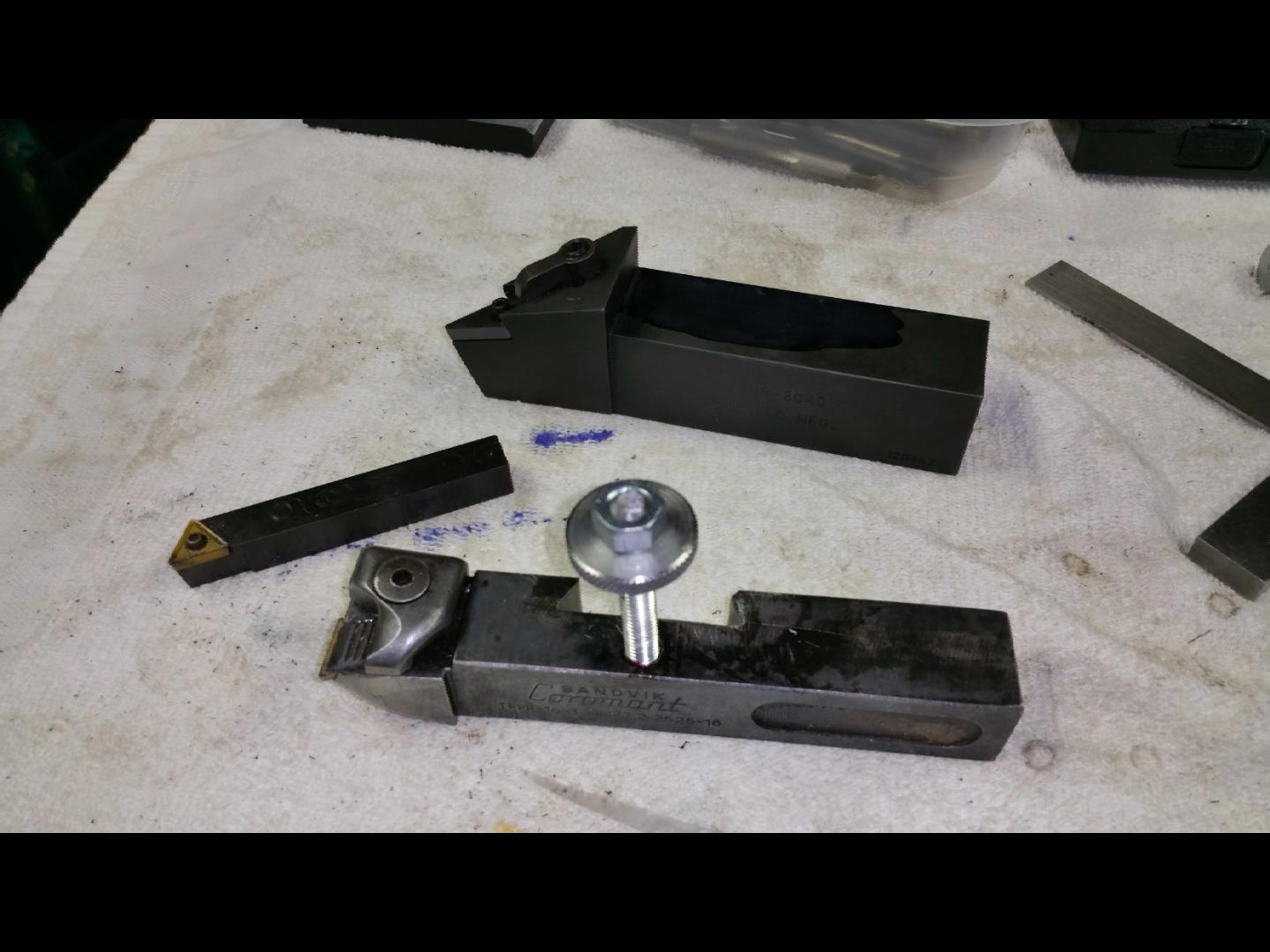

Cut a dove tail too large a little TIG welding fixes it right up

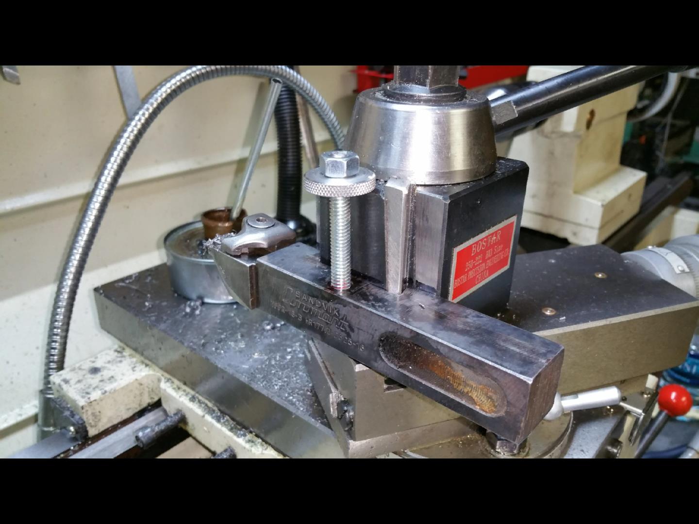

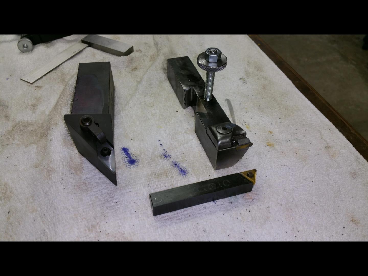

Credit goes to John Mills and James Dedmon for the idea to dove tail these large tools
Drilled and tapped for 5/16-18 made a 1 inch knurled nut
