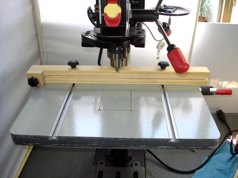

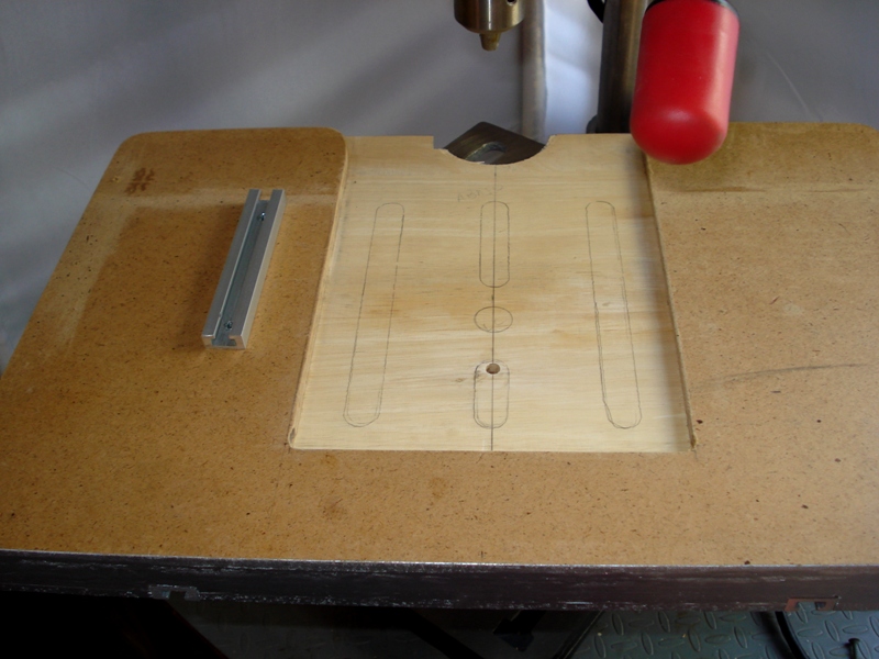

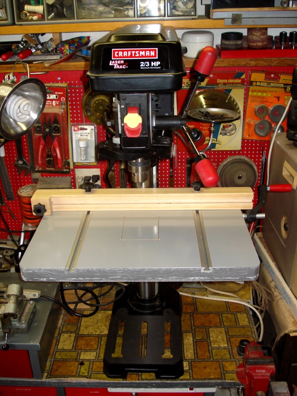

The table (45 x 30 cm.) was made with three layers, a top 1/4" melamine (leftover), a core formed by 1" slats pine (reuse), and a bottom layer 1/4" macocel (reuse). The two T-tracks serve to set the rear fence both as the material to work.
Attachment 13734
Attachment 13735

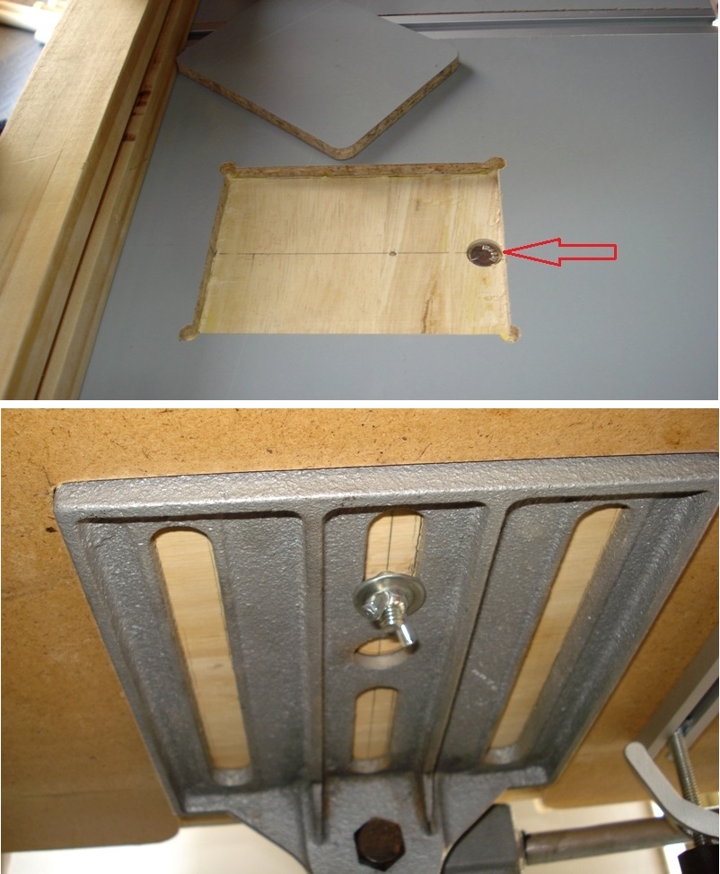

The bottom layer of macocel has a cut that fits snugly the drill metal table; a screw through the table (arrow) and a wing nut secures position of the auxiliary table.

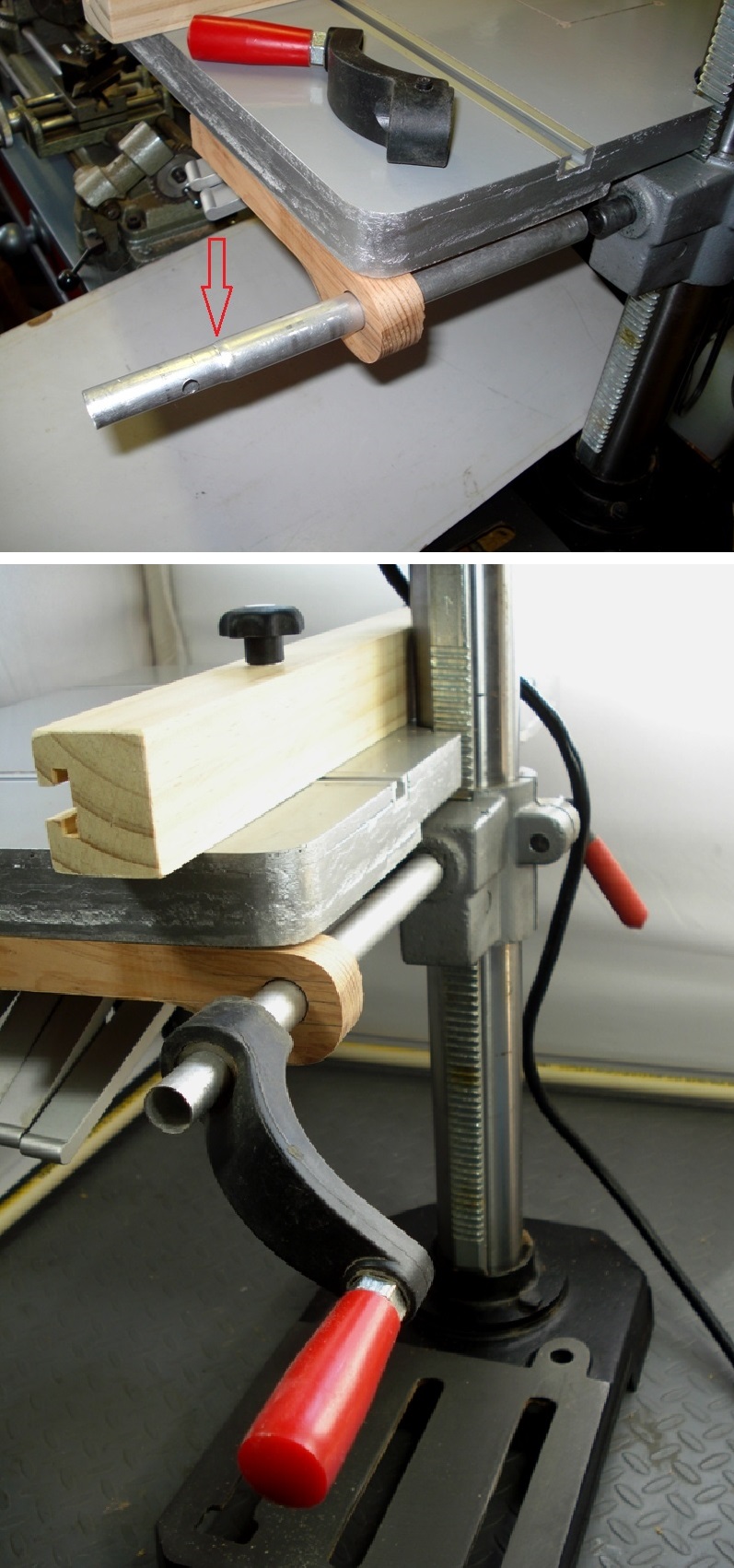

The table-elevation crank needs an extension in order to surpass the table. It was made with an aluminum pipe (reuse) with a 17/32” I.D. in one end, and a 17/32” O.D. in the other end (arrow shows transition point). A support bracket, attached to the bottom of the table, stabilizes the extended handle.

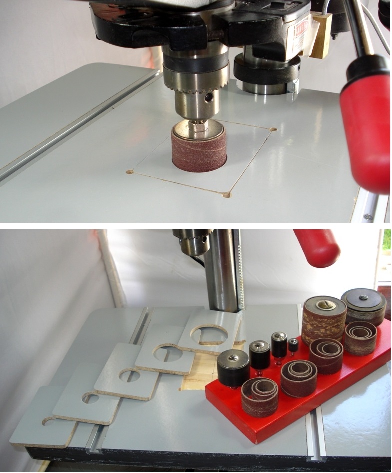

The top melamine layer has a hollow, 3 x 4 ", to place sacrifice inserts and sanding inserts.
Attachment 13739

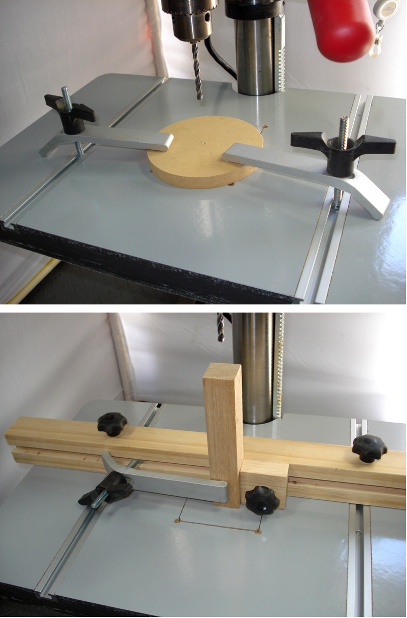

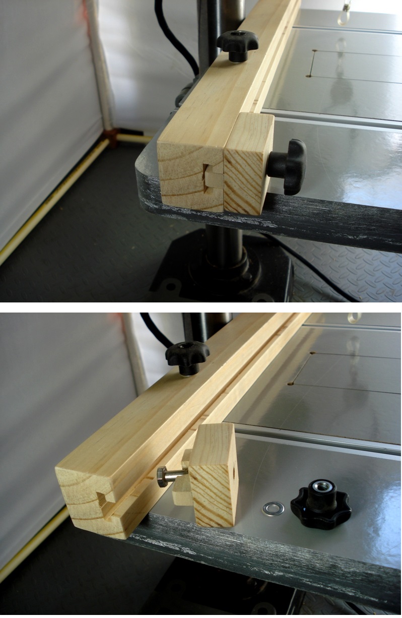

The rear fence features a homemade T-track and a stop block.
Attachment 13740

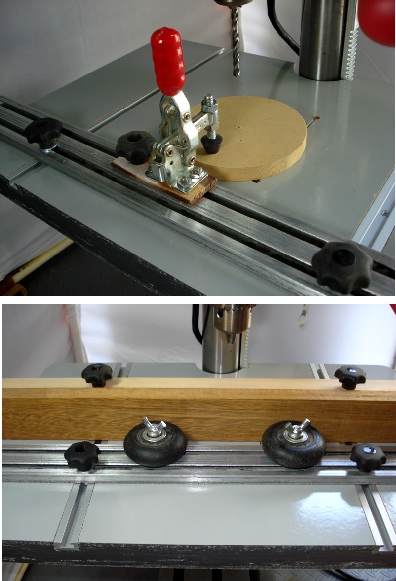

At T-tracks in the table and the rear fence can be placed various implements for fixing material: hold down clamps, toggle clamps, etc. In Oversize material it is possible to use fast acting clamps in the edge of the table.
Attachment 13741
Attachment 13742

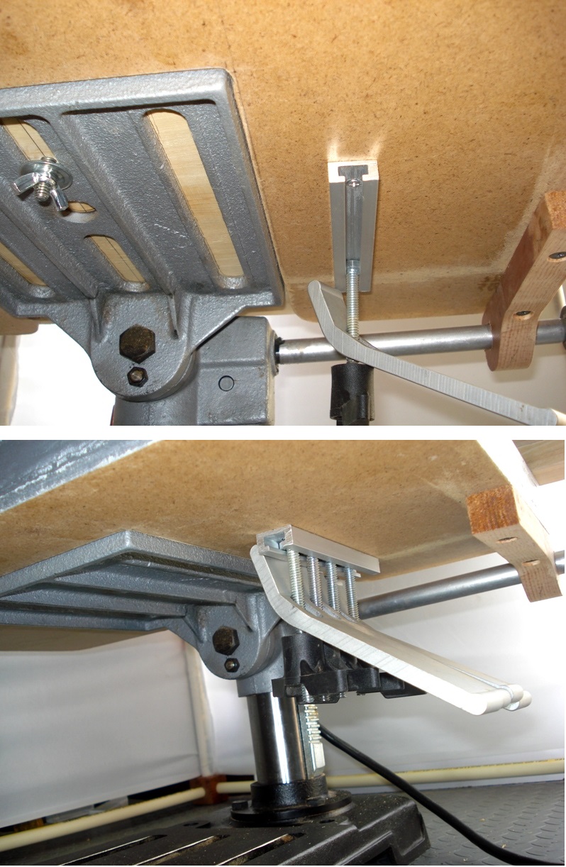

A leftover t-track placed at the bottom of the table serves to keep these clamps at hand.

Thank PJs. Indeed, the T-track adds versatility to the table; besides adjusting the fence, they offer many possibilities for fixing the work. Inserts with holes for drum sanders are useful if you don't have an oscillating sander.
