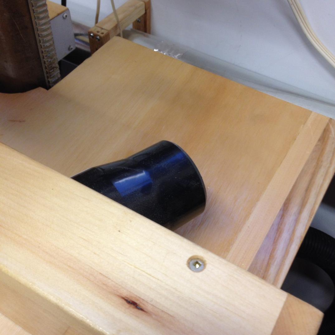

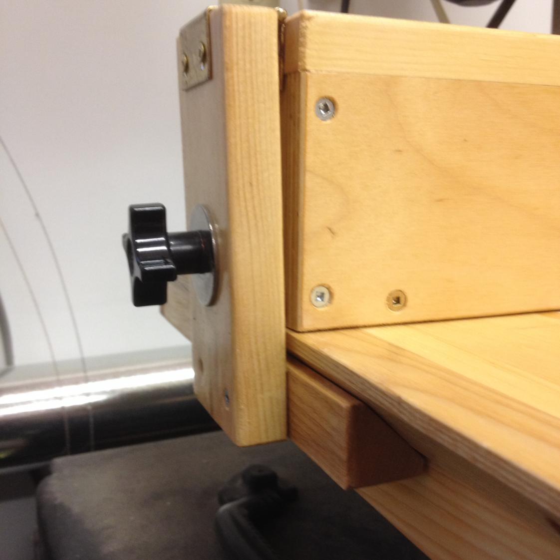

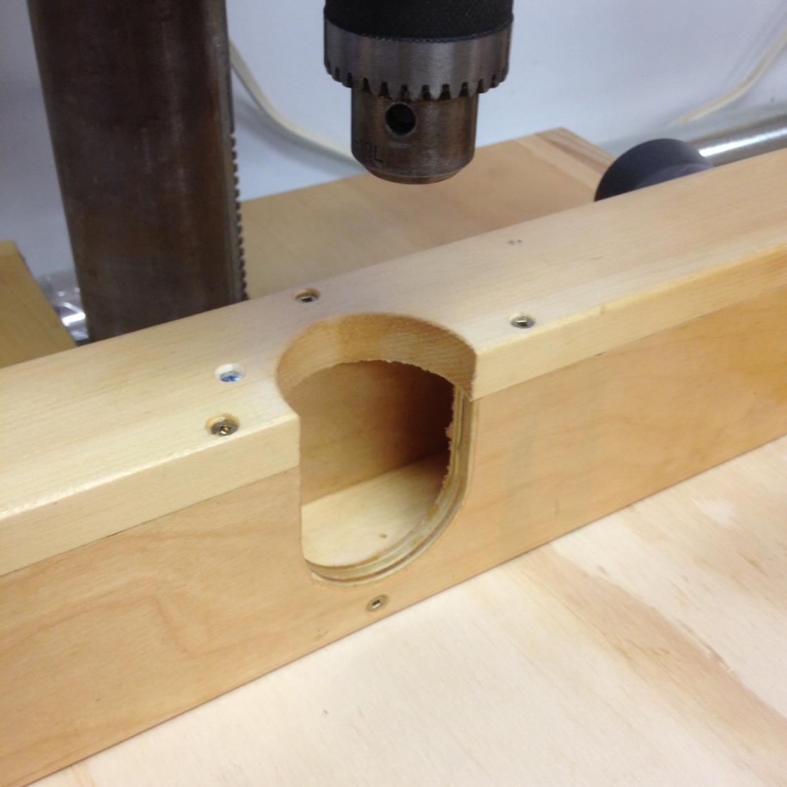

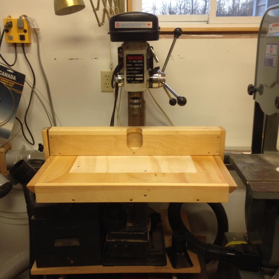

Drill press table with dust collection fence.
This table not only expands the top of the drill press (can sub as a layout- workspace for my small shop) but the fence works remarkably well at removing 90% of th debris, chips and dust from drilling wood. As long as the drill speed is low it even removes the chips from forstner bits (no small feat). The table has a dust collection port and channels in between but my first attempt at drilling holes to collect table top dust wasn't as successful. The centre portion comes completely out by removing 3 screws. I plan to add a replacable sacrificial piece in the drilling area.Attachment 2570Attachment 2571Attachment 2572Attachment 2573
