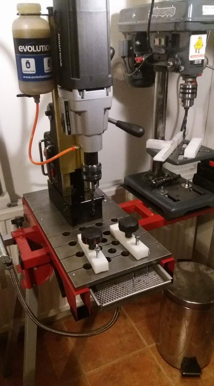

Wanted to get more space to my workbench.
So i placed my drills to my old miter saw stand.
Attachment 20090
Drawer under the mag drill collects drilling fluid and debris.

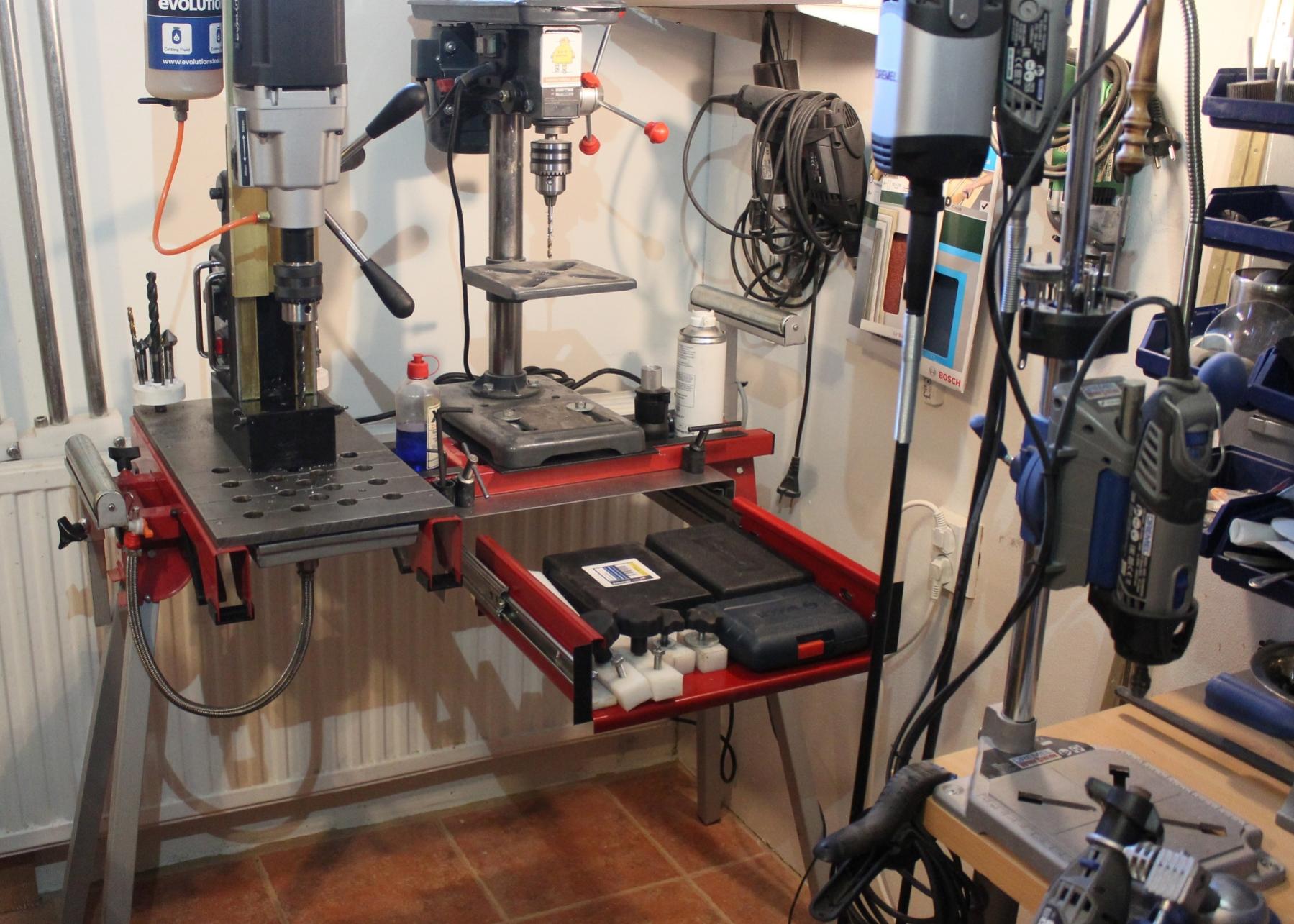

Continued with this:
Attachment 20316
Made a drawer where to keep clamping gears and stuff. No front- or back plate to keep it easier to clean.
Made from left over sheet metals. 2mm mild steel, 1,5mm acid proof steel (upper part) 8mm flat bar.
Bends made with my diy brake and riveted with steel pop-rivets.
