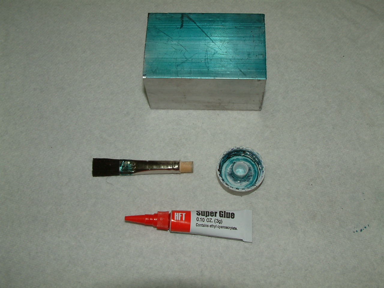

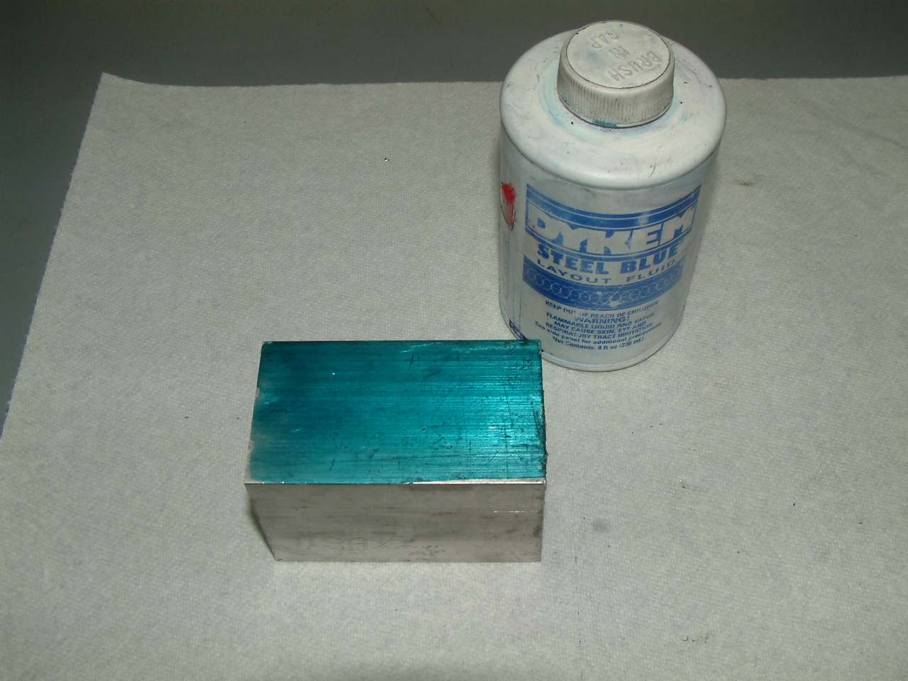

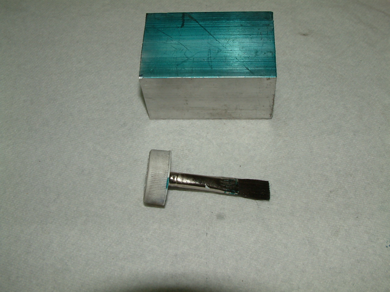

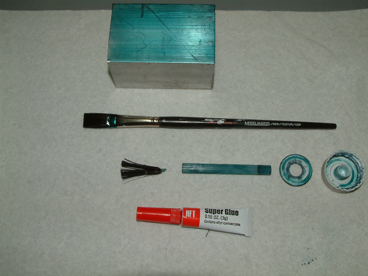

    Dykem Brush In The Can Fix
    Thanks to all for all the great comments in this thread.
    Ok, I think this will be a great Dykem brush in the can solution. The Dykem brush is just a plastic tube with some very coarse bristles pushed in the end and the other end just pushed into a short shoulder built into the cap. Why not just put a good quality brush in the can. We discussed this in an earlier post. I also had trouble with that lid seal. It would always stick to the can and then I would have to grab it and put it back in the lid. Blue Finger Again!..
    Pictures show the story. Remove that plastic tube with bristles. Put some CA on the gasket and then glue it to the cap. Get a good camel hair fine bristle brush. Cut to length, I like mine short so the metal brush holder does not fill up with Dykem. I can always tilt the can. Turn down the end of the brush so it fits the lid and put it in with some CA. Very nice fine layer of Dykem. So now we have the best of both. A refillable felt tipper and a good brush in the can.....
    Cheers, JR
