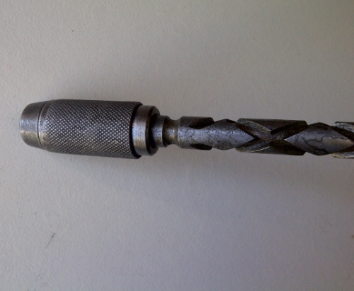

Seeing this chuck taken apart brings to question the dismantling of these small chucks - do you have any advise on the dismantling of a Yankee Screwdriver Chuck for servicing? Any information on taking these small chucks apart would be most appreciated?

Have previously searched all links offered in your comment without success of finding any related info on the CHUCK - Info is very informative in dismantling and servicing the Yankee Screwdriver but nothing about dismantling of the chuck ie. Taking the CHUCK apart?
If I have missed something your enlightenment will come as as most appreciated.

Jacobs makes a pin chuck I have one in my tool box. If you need to disassemble a chuck open the 1/2 way and press the outer sleeve off. So if the clamping range of the chuck is from 0- 1/2" open the chuck 1/2 way I usually use a rod the proper dia. and clamp it lightly so you can remove it. Don't beat on with a hammer be gentle

The chuck is spring loaded and very difficult to hold open.
If this is not too an inconvenience - do you by any chance have any diagrams or pictures for me to see in detail what section is clamped to work it apart?

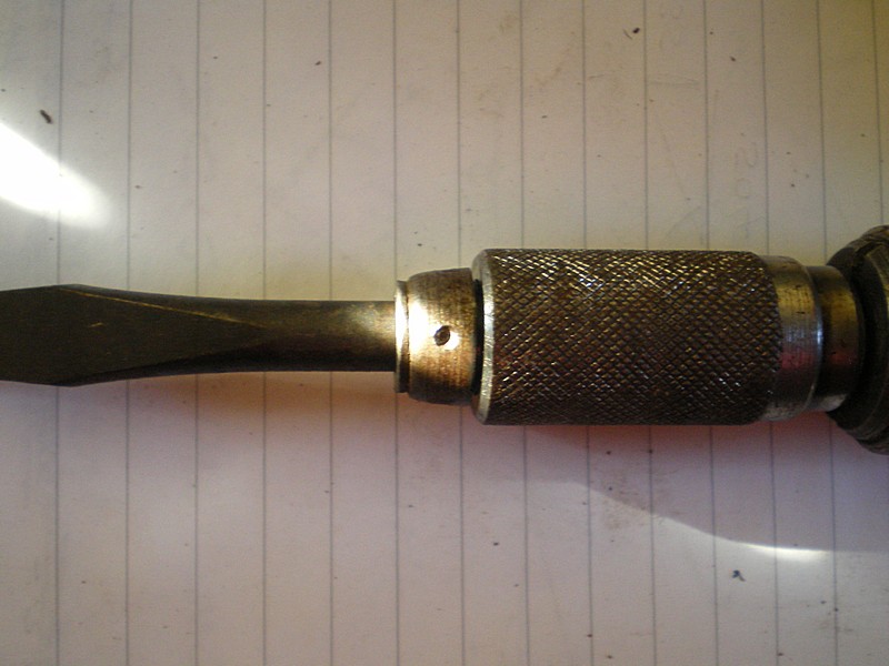

These chucks are not meant to be user serviceable but having a closer look at the one I have I noticed a small pin fixing the front collar to the chuck body which stops the collar from sliding forwards, this appears to be a blind pin so would need drilling out and replacing with a new one and I am guessing not the easiest thing to re-assemble.
Attachment 23832
I know the urge to repair can border on obsession sometimes (I speak from experience) but these screw drivers are so cheap on Ebay is it worth it?, power tools( namely impact drivers) have made them an unwanted item to most but I still use mine for those stubborn screws.
