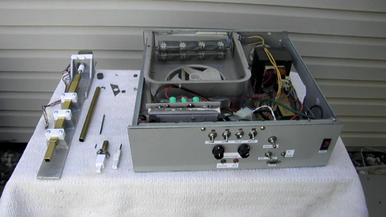

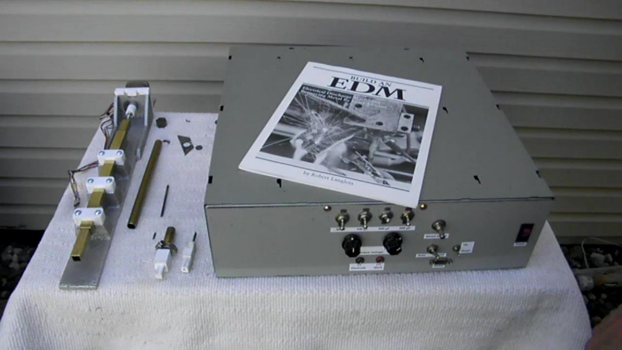

I deviated from the book in a couple of ways. First I sourced some of the components from scrap electronics and an electric clothes dryer that I picked up for free on the side of the road. The main transformer came from a microwave oven along with a cooling fan. A smaller transformer was sourced from an old stereo. The heating coil that I used as a power resistor was also taken from the old electric clothes dryer. The motor from the same clothes dryer is still in use on my http://www.homemadetools.net/forum/g...9966#post41061.
Additionally I used a sand cast aluminum part to support the linear actuator components and finished the whole thing off with a few custom 3D printed parts to fasten the linear actuator parts together.
Here are a couple pictures of the major components with and without the case cover installed:
Attachment 10526 Attachment 10527

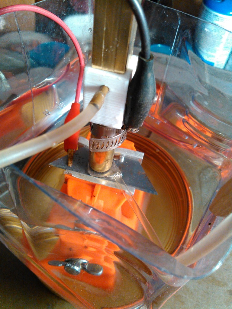

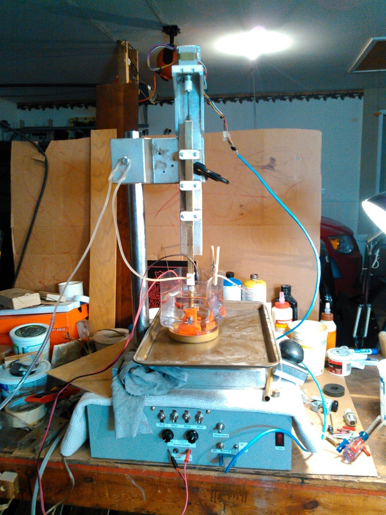

Here is the machine setup for cutting a part:
Attachment 10529 Attachment 10530

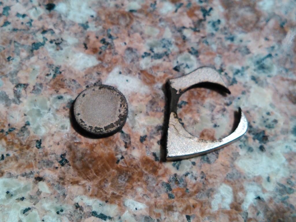

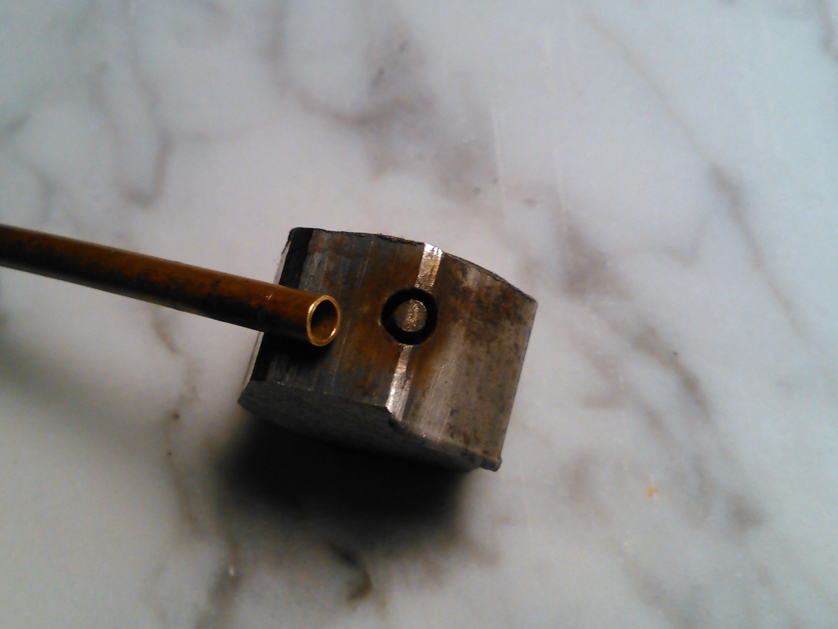

These are a couple of pictures of items that were machined using the EDM. On the left is a piece of hex stock that I machined with a small electrode. On the right is a neodymium hard drive magnet that I cut a circle out of.
Attachment 10528 Attachment 10531
