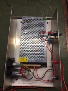

The power supply is 240V AC input 12V DC output.
Attachment 22986

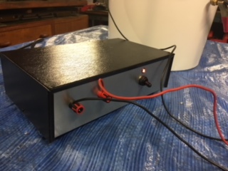

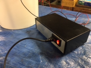

Back of control box
Attachment 22987
Front of control box

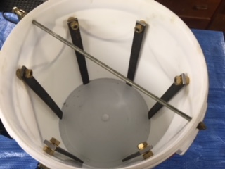

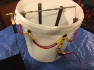

Photo showing bucket with six anodes linked together
Attachment 22989
Six steel anodes (+) and cathode (-) across bucket.

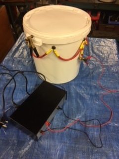

Attachment 22990
Complete set up. NOTE: The lid will not be in place when the process is taken place, when not in use all items can be stored in side the bucket and the lid will keep eveything together.
