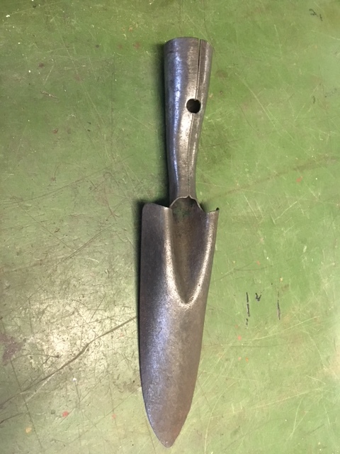

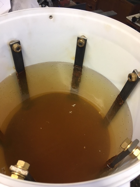

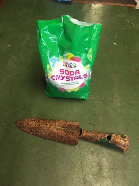

    Hi All

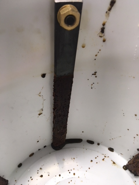

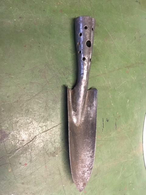

    Following on from the post http://www.homemadetools.net/forum/e...-removal-67148 I have managed to successfully clean up an old garden trowel from my late mother’s garden which she used all the time. The following photos show the process in cleaning up the trowel which has now been painted and back in service. The trowel is very old and is well made so pleased to have recovered it and give it a new lease of life. The trowel was left in the solution for 15 hours the ratio of crystal to tap water was 1.5 table spoon to 1 Gallon.
    Electrolysis rust removal results using a garden trowel-img_1555.jpg Rusty garden trowel and soda crystals
    Electrolysis rust removal results using a garden trowel-img_1556.jpg Process working
    Electrolysis rust removal results using a garden trowel-img_1559.jpg Rust removed

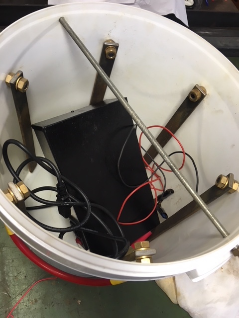

    Electrolysis rust removal results using a garden trowel-img_1561.jpg Bucket waiting to be emptied

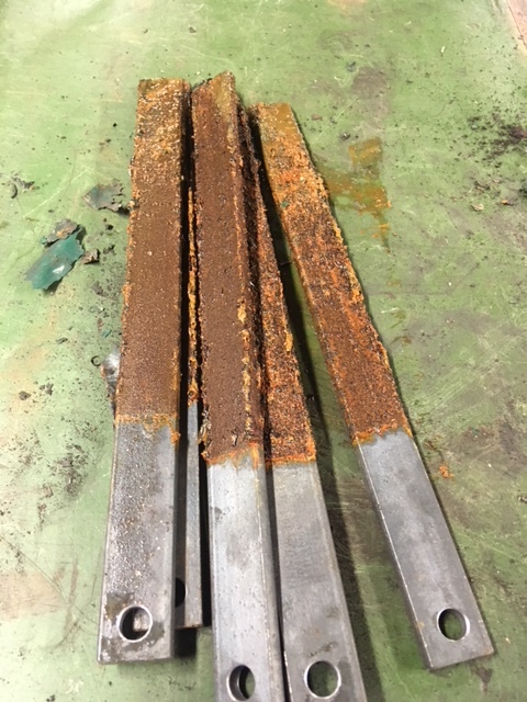

    Electrolysis rust removal results using a garden trowel-img_1562.jpg Anodes covered with unwanted rust from trowel

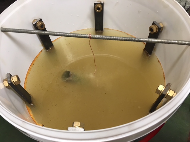

    Electrolysis rust removal results using a garden trowel-img_1563.jpg Anodes removed for cleaning
    Electrolysis rust removal results using a garden trowel-img_1564.jpg All cleaned and stored ready for next rusty item.
    Thank you for viewing and if you have items you are thinking of throwing due to rust have ago it could safe you a lot of money.

    Hi
    After researching this subject washing powder does not work, it has to be soda crystals to create the electrolytic path between the anode and cathode. The supply is also important and needs to be DC. I use a 12V DC power supply. This was, then rigged up in a project box to keep everything together and allowed a little but more control with an additional on/off switch. I have since also put a digital volt/amp meter as well but this is not essential, as is the on/off switch. You can also use an older style battery charger I believe the new ones sometimes do not work.
    There is a lot of information on this subject and better-qualified people than myself to advise you on HMT on this topic. But, if I can help further please ask.

    I left the trowel in the bath for 16 hours so shot blasting is quicker and the surface finish is uniform and gives good key for paint. I think this method is great for tools, that require miniimum surface finish change i.e. Morse taper tooling etc.
    Hope this helps your decision on which method to use in the future.
