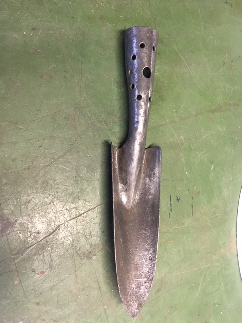

Hi All

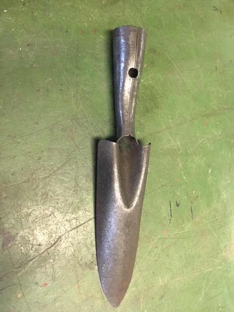

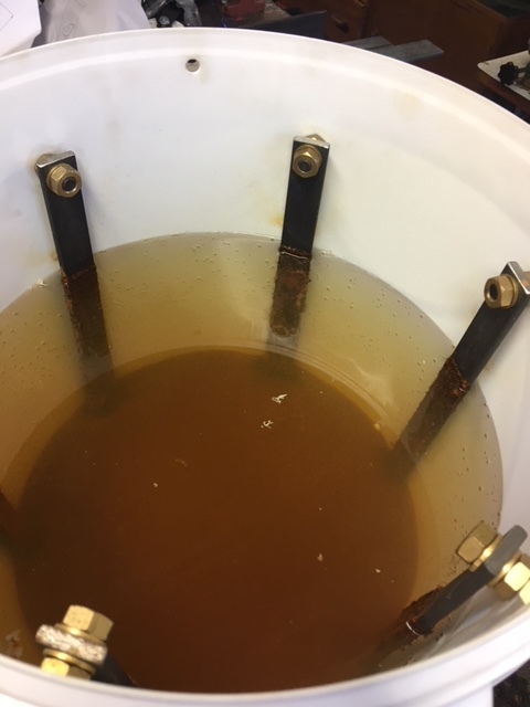

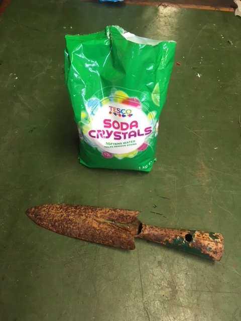

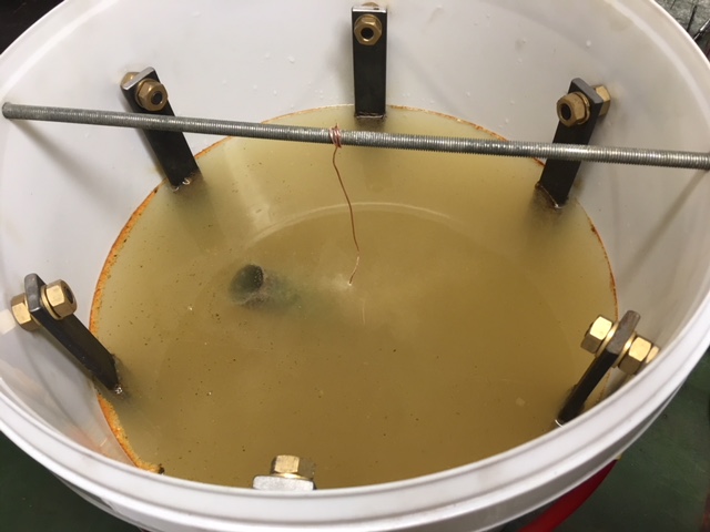

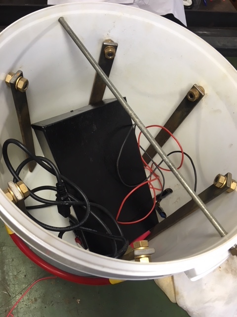

Following on from the post http://www.homemadetools.net/forum/e...-removal-67148 I have managed to successfully clean up an old garden trowel from my late mother’s garden which she used all the time. The following photos show the process in cleaning up the trowel which has now been painted and back in service. The trowel is very old and is well made so pleased to have recovered it and give it a new lease of life. The trowel was left in the solution for 15 hours the ratio of crystal to tap water was 1.5 table spoon to 1 Gallon.
Attachment 23018 Rusty garden trowel and soda crystals
Attachment 23019 Process working
Attachment 23020 Rust removed

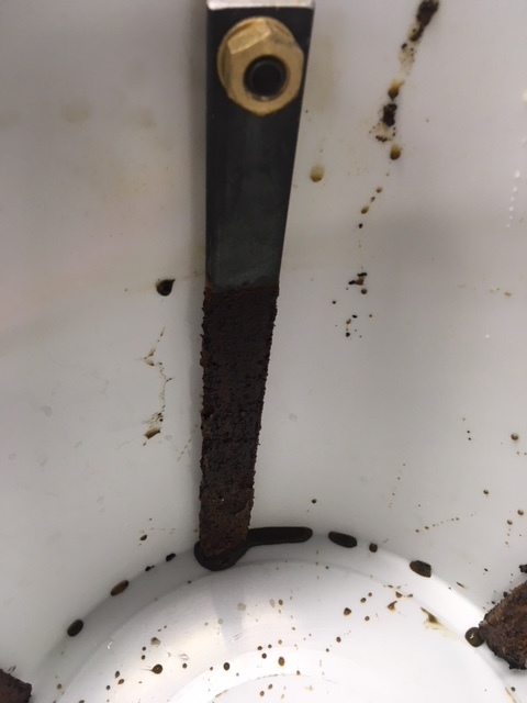

Attachment 23022 Bucket waiting to be emptied

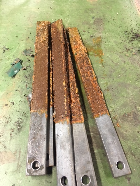

Attachment 23024 Anodes covered with unwanted rust from trowel
Attachment 23023 Anodes removed for cleaning
Attachment 23025 All cleaned and stored ready for next rusty item.
