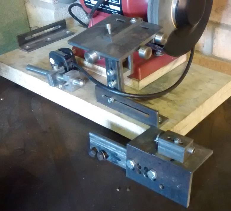

Endmill Sharpening device, end cutting edges only
Sharpening an endmill has two quite different edges to sharpen. Those on the side which is difficult and need relatively complex equipment, and those on the end which are easy with quite simple tooling. Sharpening the end edges only is well worth doing as it will considerably improve the finish achieved when being used to surface a workpiece.
The video which I am introduceing here shows a device for sharpening the end edges, being easy to use and easy to make in just a few hours.
