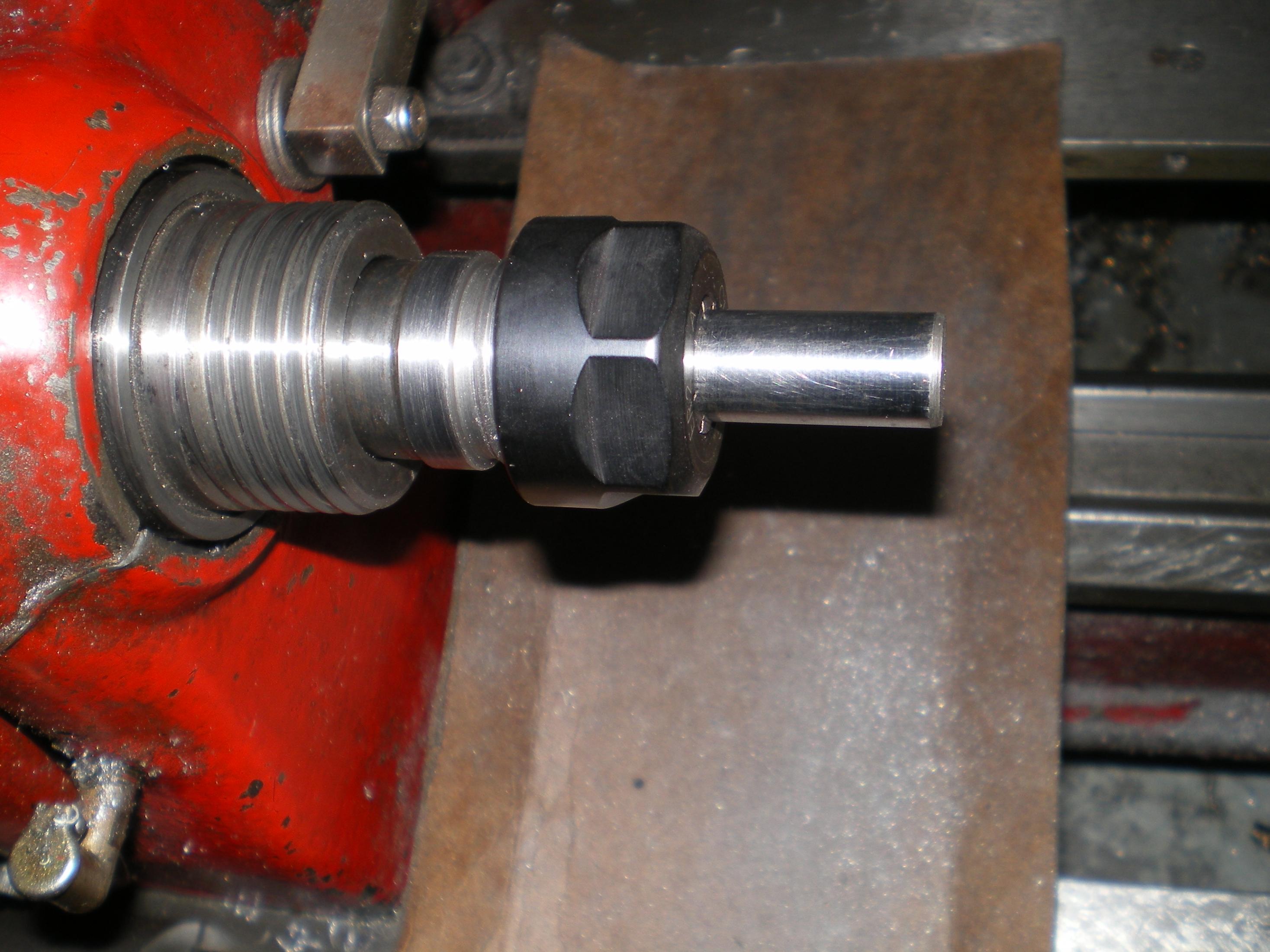

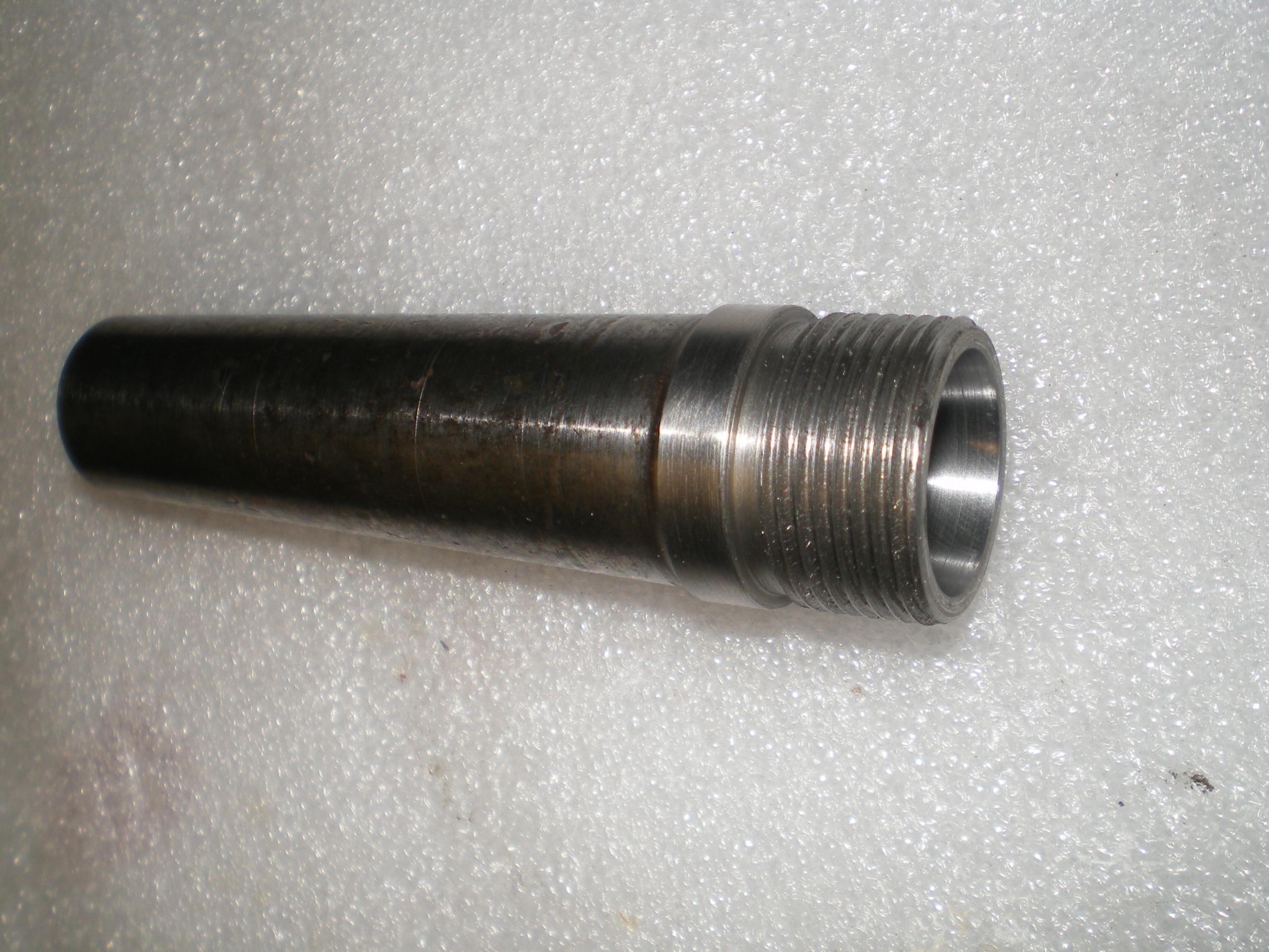

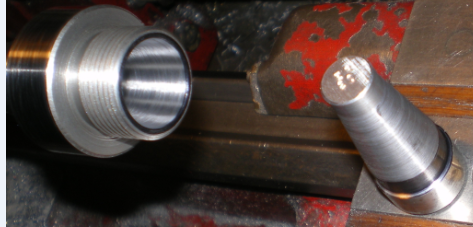

I had a No 3 MT drill that was beyond redemption and the shanks are machinable (same size as my lathe mandrel) so I decided to make an ER 20 collet holder from it.
Easy job really using a standard closing nut and drilling through clearance for 13mm.
This is the most accurate form of mounting and quick to use and is proving very useful.

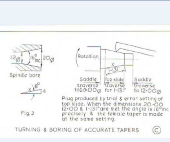

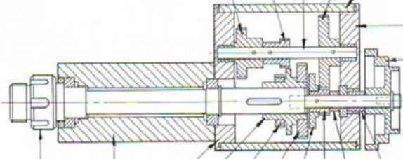

The 8 degree taper is the only critical part so I made a taper gauge for that which I will use again as I am in the process of making a 3 speed geared milling spindle on the lines of the Quickstep mill.
