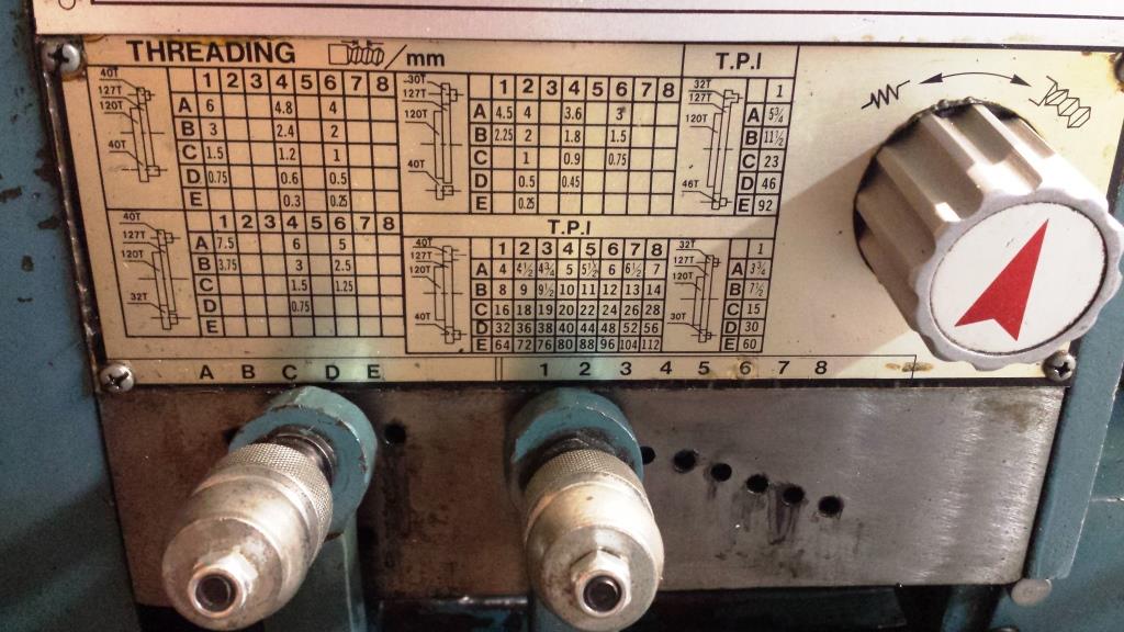

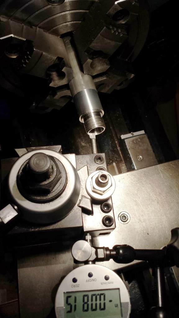

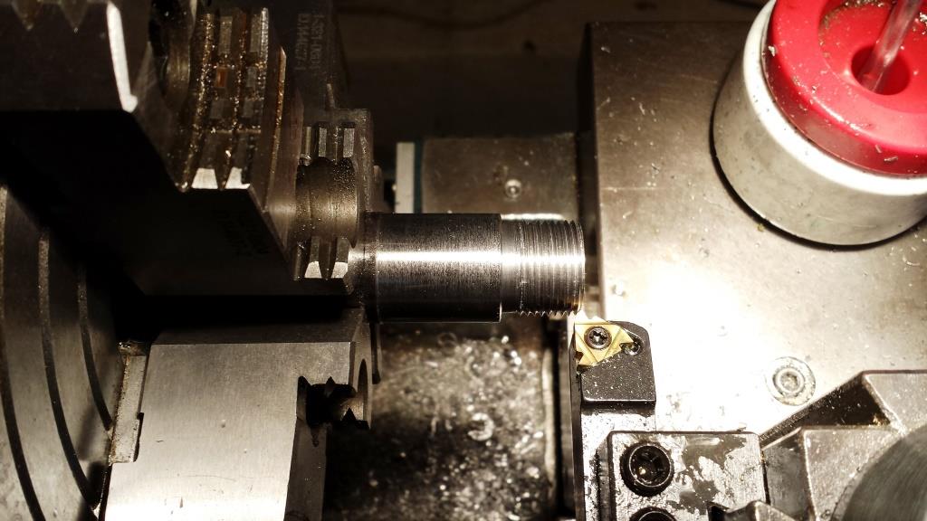

I used the 12” swing lathe for the single point threading the M22X1.5 thread required for the collet nut. This lathe is designed to cut inch threads using a thread dial and engaging/releasing the lead screw half nut. Metric threading requires leaving the half nut engaged and reversing the lathe for each cutting pass (there are other ways to do this but this was the easiest way for the 0.700” length of thread). On the back side of the headstock, the lower 40T gear has to be reversed and adjusted to engage the 12OT gear (see the upper left hand Metric threading diagram in the lathe threading plate photo shown below).
Attachment 9220

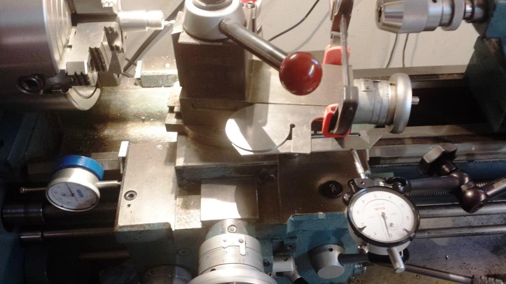

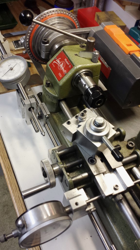

Next I set up the lathe compound for boring an 8 degree taper required for the ER16 collets. I used a +/- 5 minute Vernier 6" precision angle protractor (made by Helios in Germany) and 0.0001” dial indicator to set the compound angle. A soft jaw adjustable clamp held the protractor and a 1-2-3 block ensure the protractor remained parallel to the lathe compound axis of cutting. An alternative would be a 5” sine bar and gage blocks for setting the 8 degree angle.
Attachment 9222

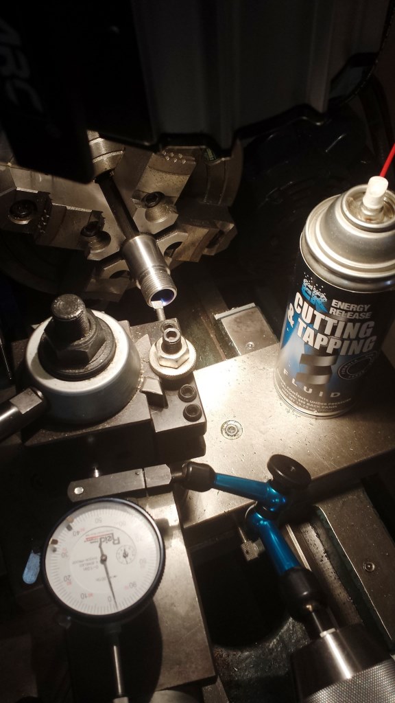

The collet was drilled and bored the full length to 11 mm dia. hole for starting boring and later to tap a M12X1 thread. The “rough” 8 degree collet opening was bored with a cobalt HSS boring bar and the depth of bore measured with a 1" travel dial indicator to avoid crashing the boring bar.
Attachment 9223

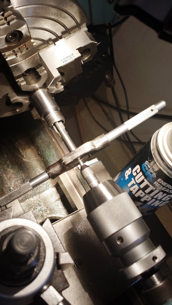

Next the M12X1 tread for the 3” swing Unimat lathe was tapped to full depth from the open collet end to ensure the threads were very close to concentric and aligned with the collet axis. The lathe cut-off tool removed the roughed-in collet and the collet was then mounted on the Unimat lathe spindle after counterboring the threaded end to 12 mm x 4 mm deep.

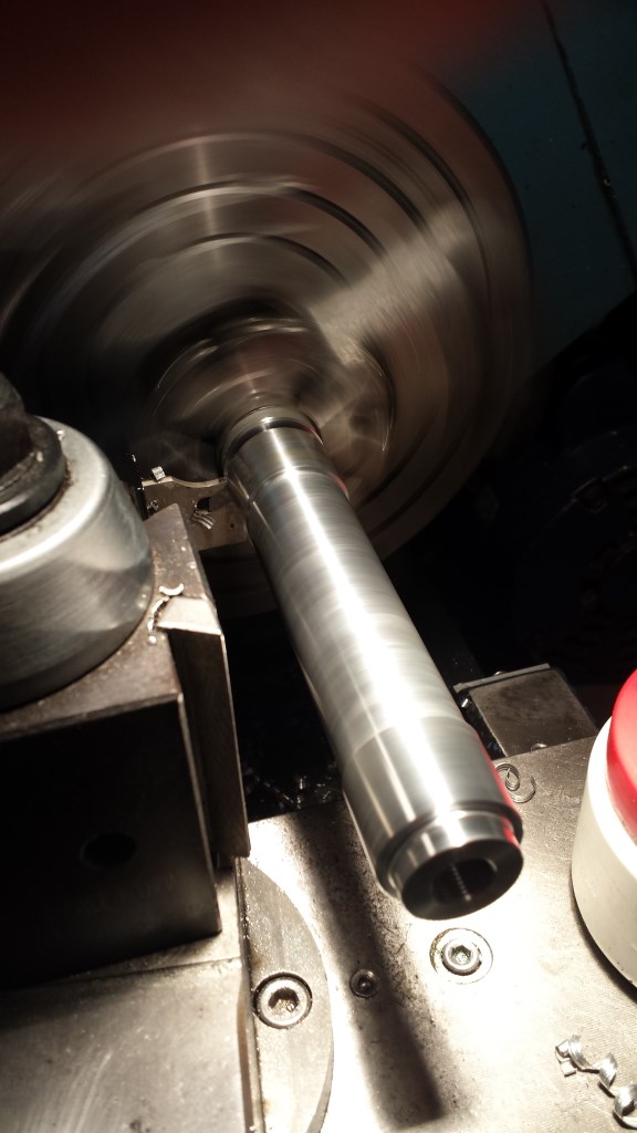

Next I mounted the collet chuck back on the Unimat SL and used the Unimat lathe to true-up OD of the collet body to be concentric with the threaded lathe M12X1 spindle before returning and finishing the work on the larger 12"swing lathe. Before mounting the collet chuck in the larger 4-jaw chuck, I used 6061 aluminum bar stock to create a light press fit temporary chuck to hold the collet chuck back on the larger lathe while taking a final 0.004” skim cut off of the collet 8 degree opening. Using a temporary aluminum chuck allowed the ID to be bored concentric for holding the collet chuck and also prevented tool marks from 4-jaw chuck jaws.
Attachment 9225

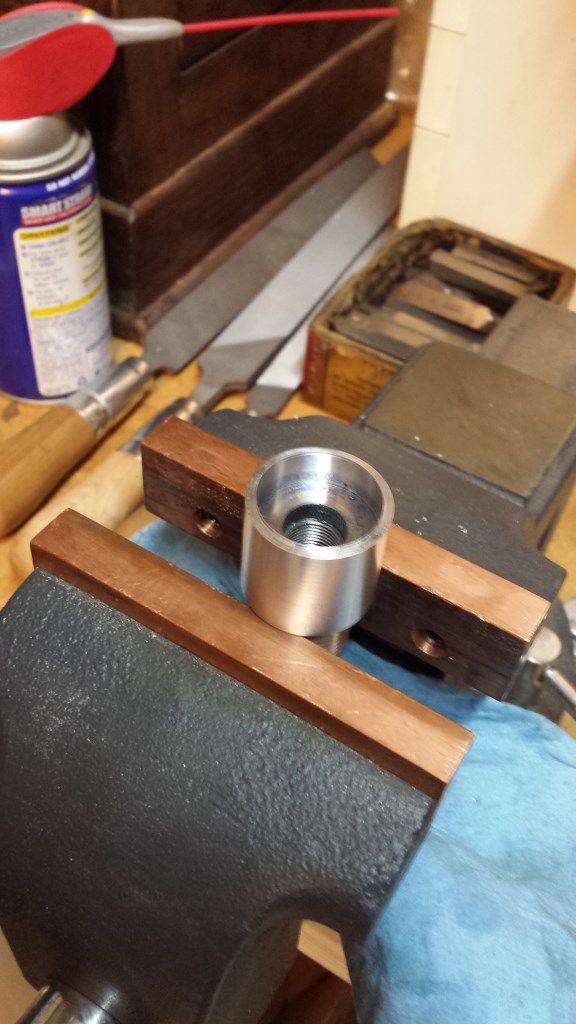

After taking the skimming cuts, I used the lathe cutoff-tool to remove the collet with its surrounding press fit aluminum chuck “jacket”. The jacket was easily removed with a small brass hammer while holding the collet in the soft copper jaws of a bench vise.
Attachment 9226

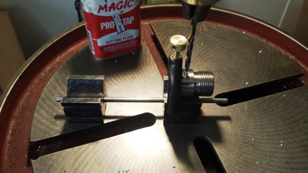

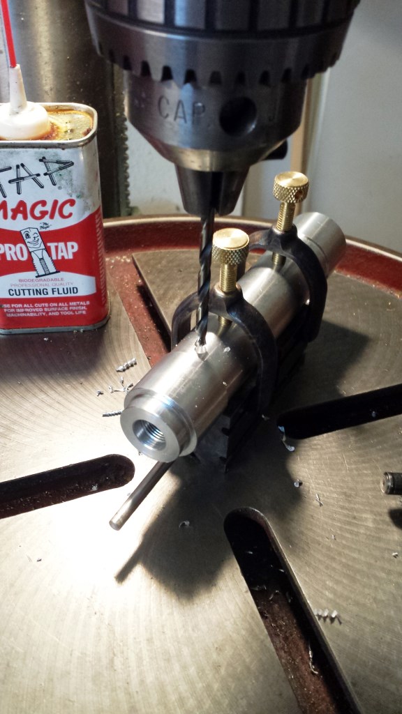

Finally, 4mm tommy bar holes were drilled in the collet for removing the collet chuck from the Unimat spindle.
Attachment 9227

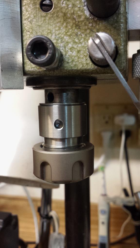

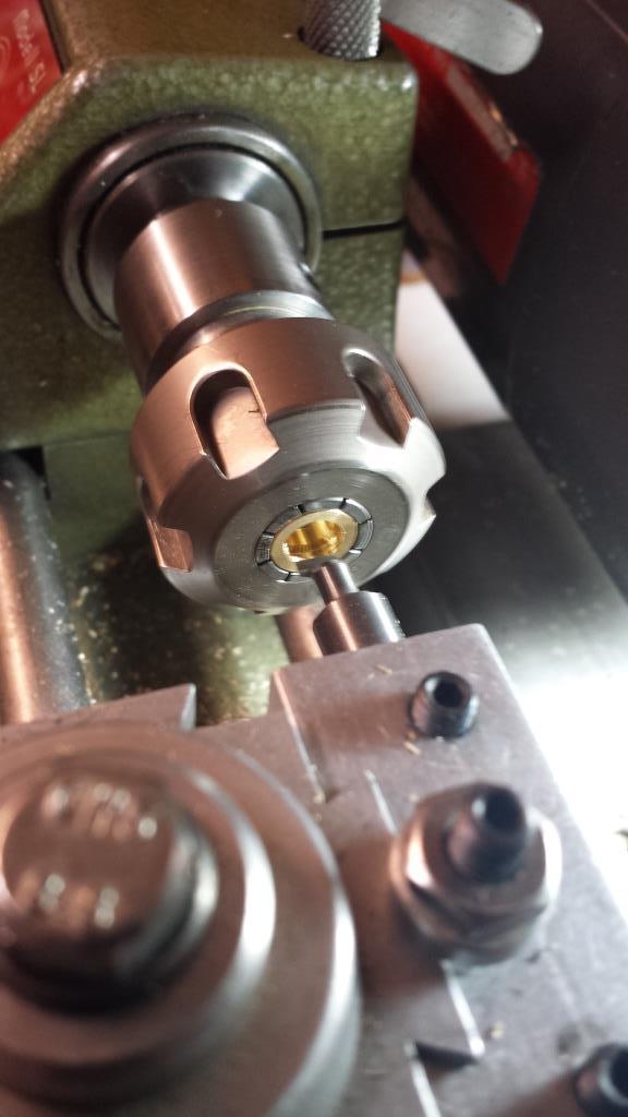

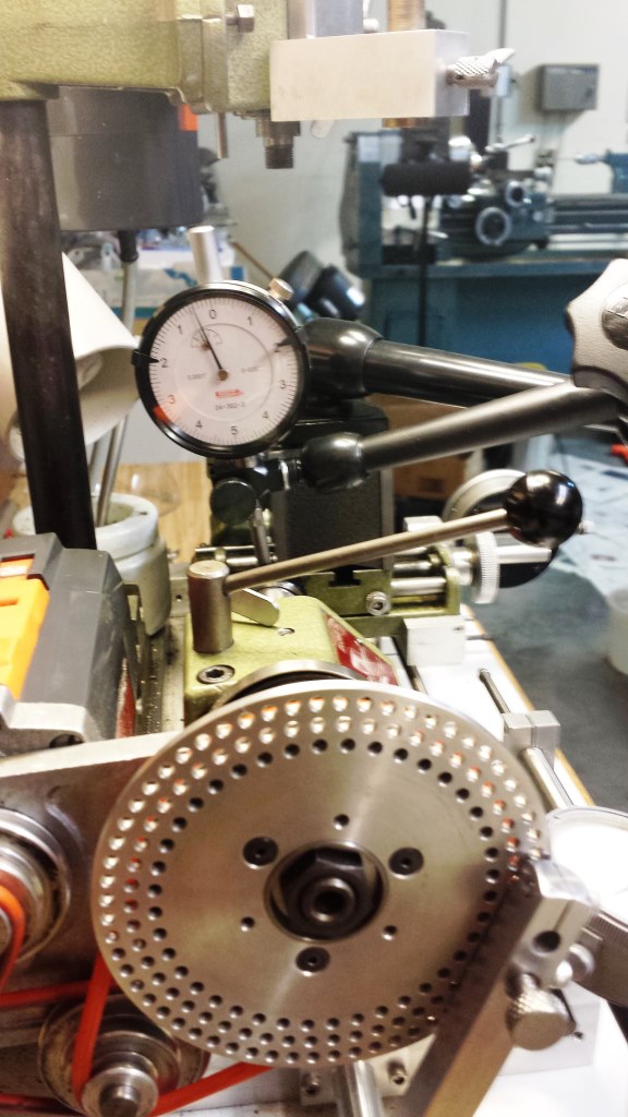

The ER16 collet chuck is also used for milling operations on the Unimat. Below is a close-up photo of the collet chuck using a Shars ER16 collet nut. The Shars product is precisely made and not very expensive.
Attachment 10525

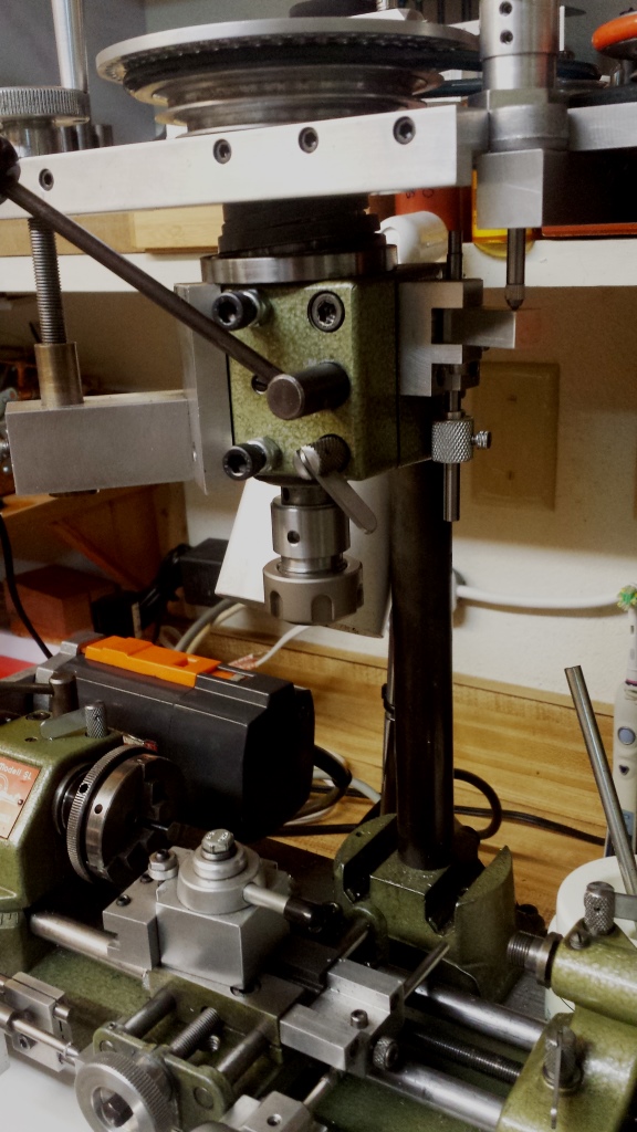

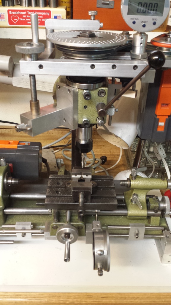

The photo below shows the setup for milling with a 3/8" dia. four flute HSS cutter.
Attachment 9375
The photo below shows the ER16 collet chuck installed on the Unimat SL1000 lathe and where it is used the most.
Attachment 21810
