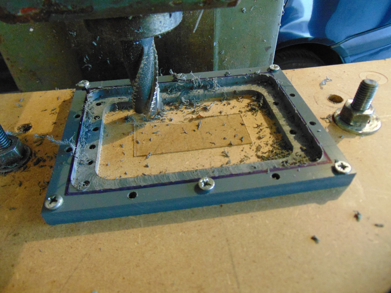

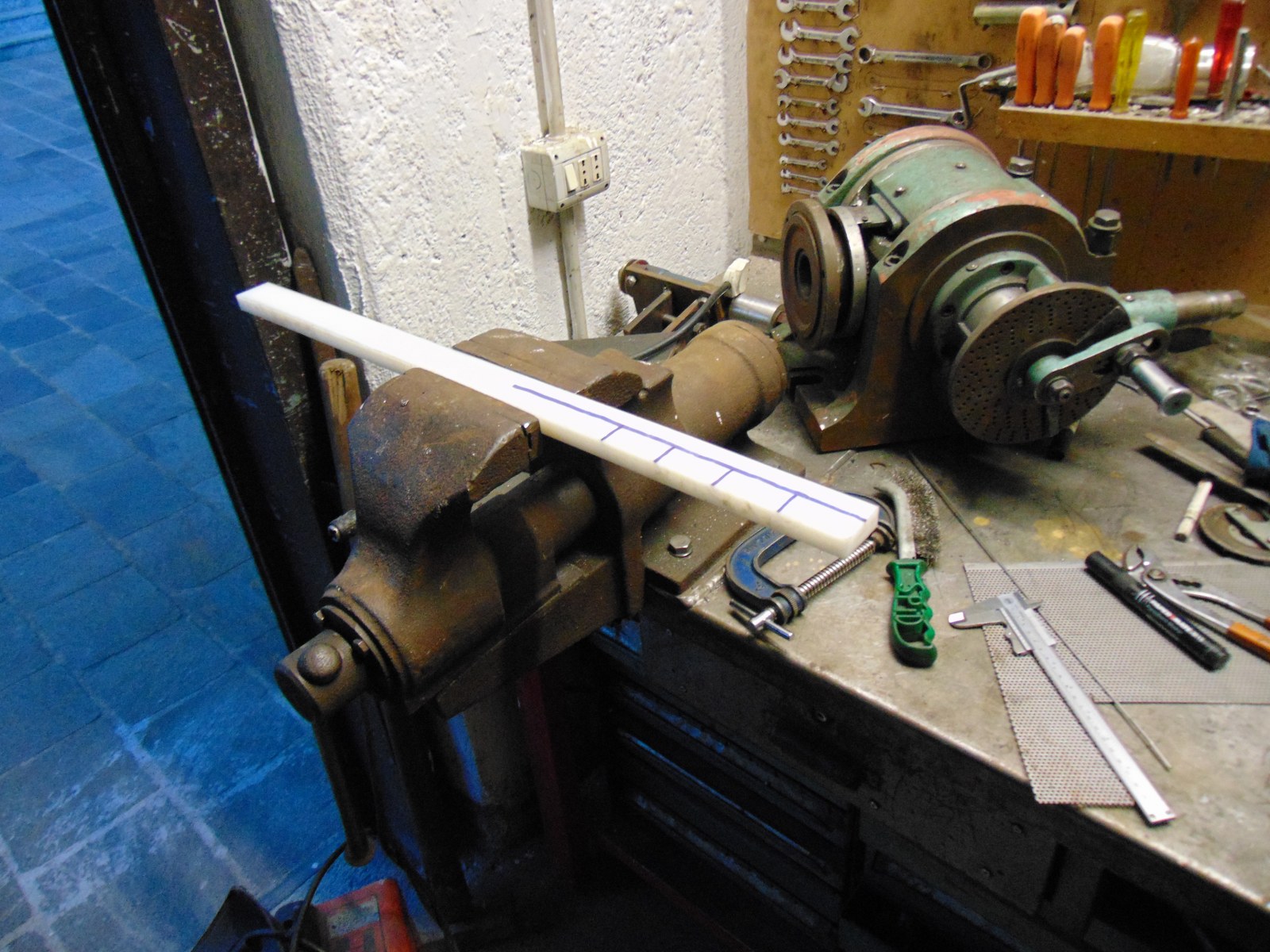

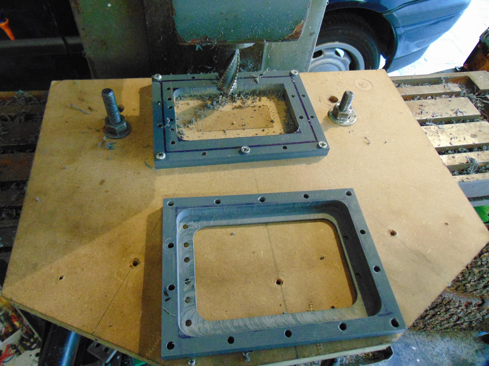

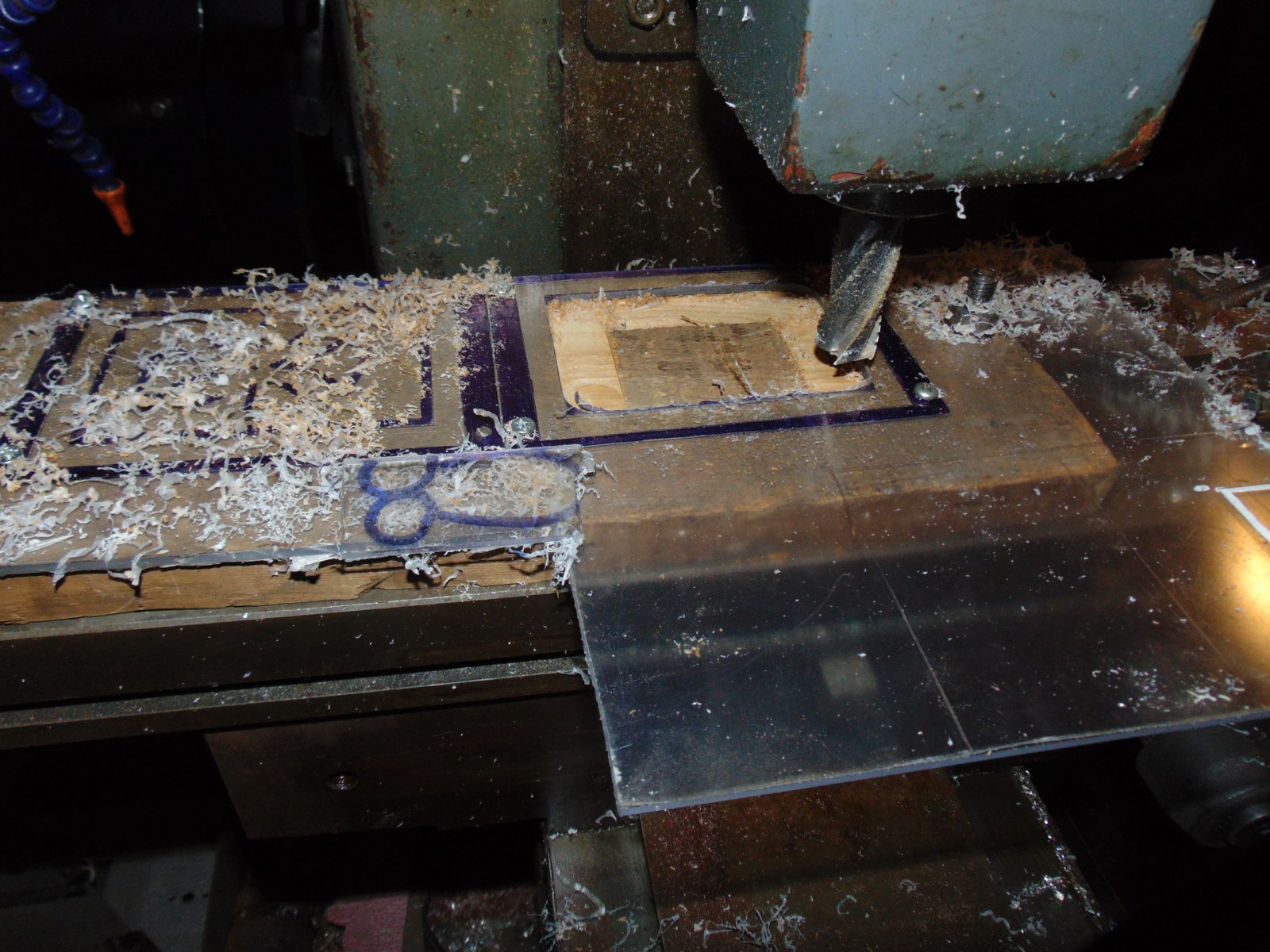

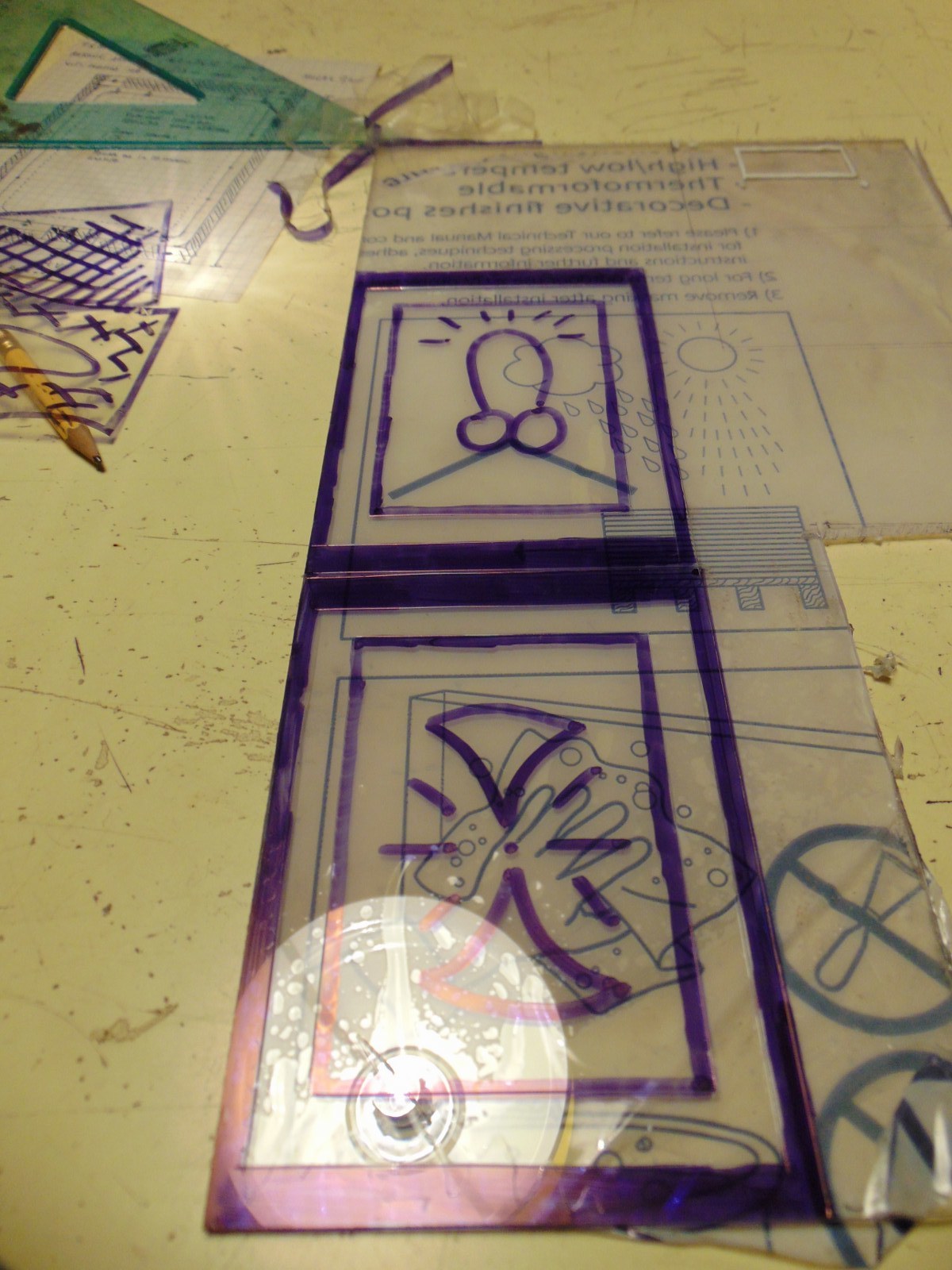

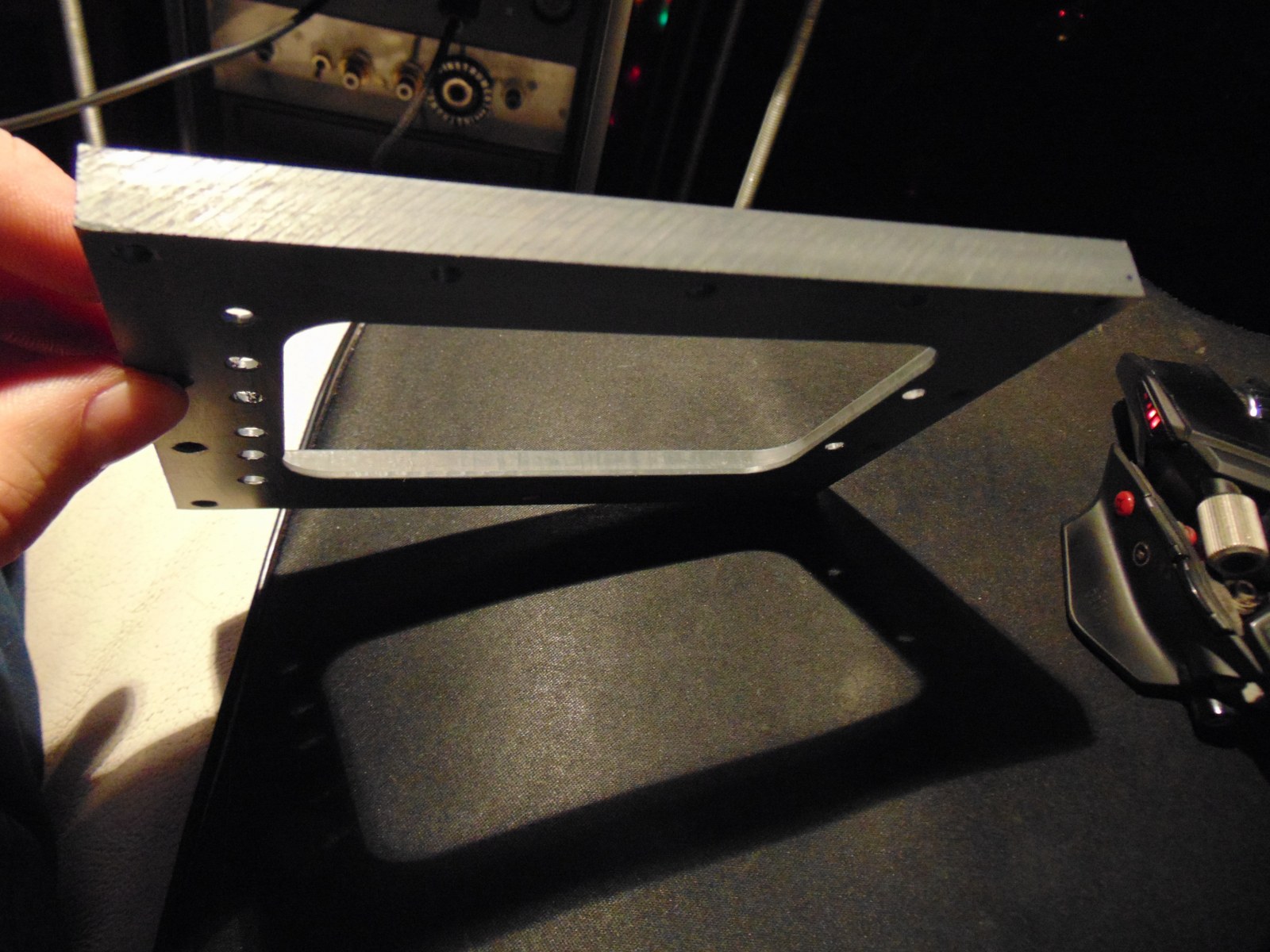

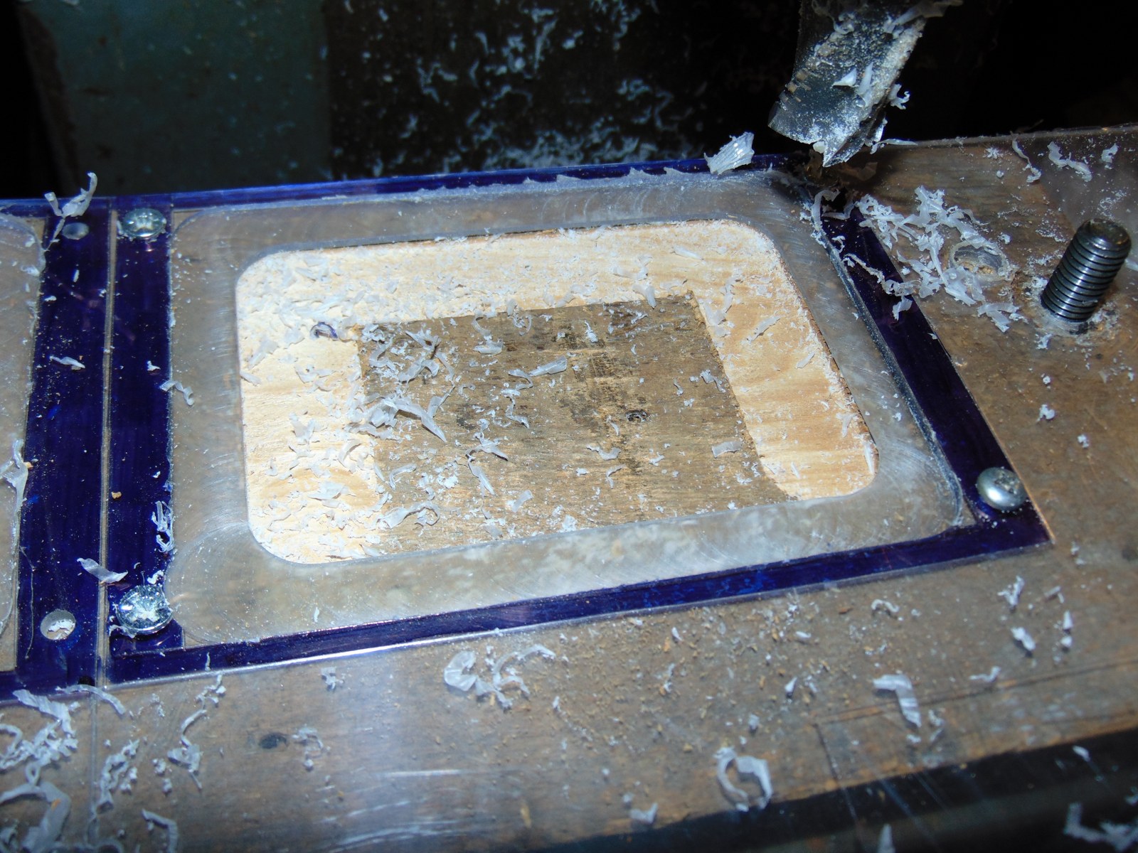

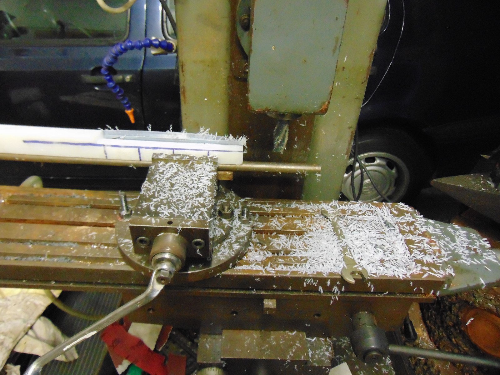

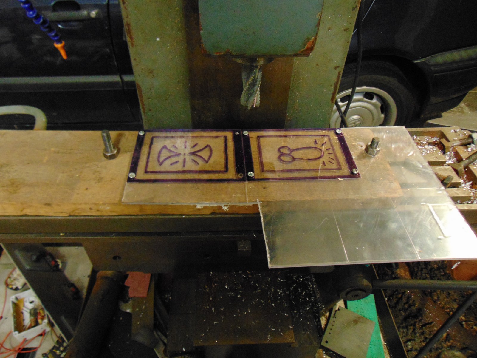

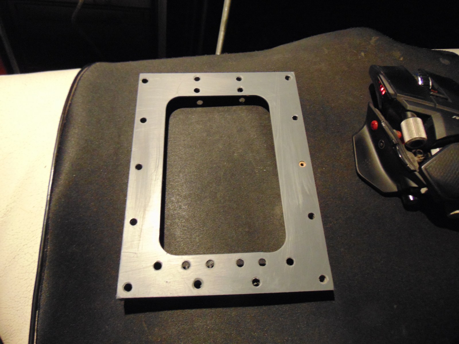

I'm trying to build a couple of electrostatic panels for headphone.
I'm reading a couple of books and opinions in internet about the right "rule" about size, polarization and materials.

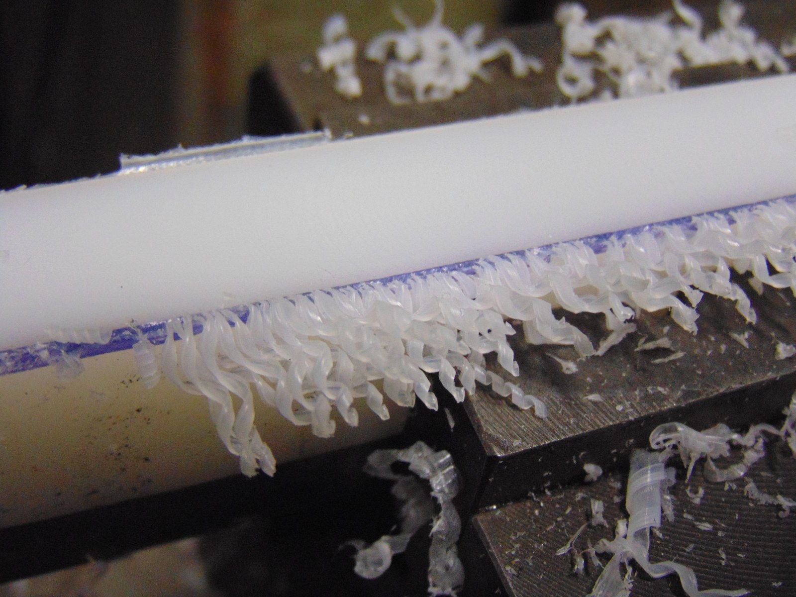

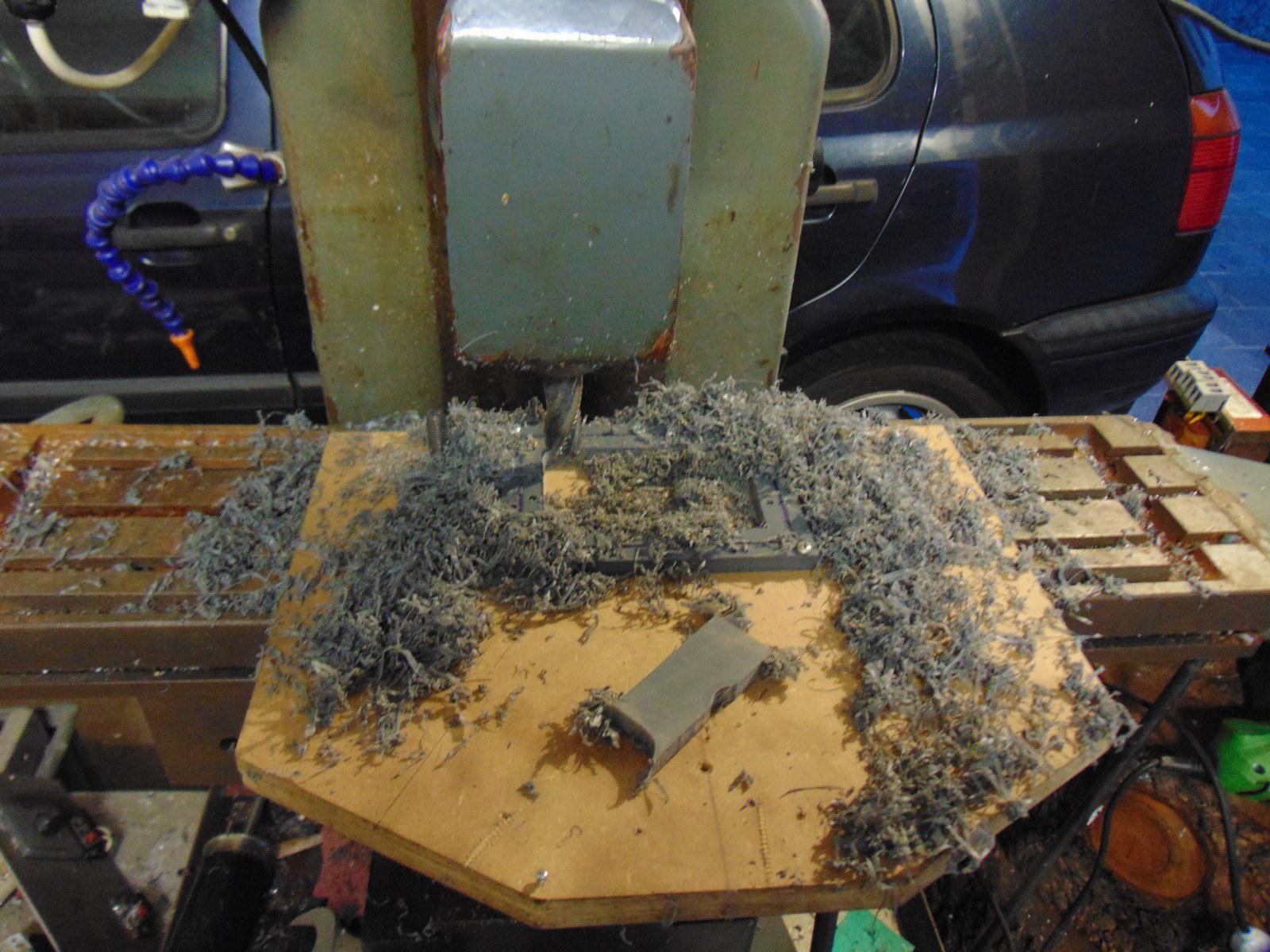

I'm building frames for stators and diaphragm from 10mm PVC bar.
I'm not sure about type and thickness of diaphragm, normal film for food should be polietilene or pvc about 12 micron. Someone in audio forum tried 1 micron film with very short distance from dia to stators.
I tried first frame in thin lexan, but it wasn't good, too flexible!

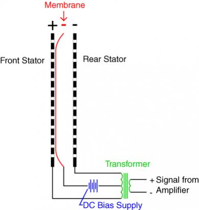

Here a picture of Esl operation
http://www.justrealmusic.com/images/..._animation.gif
Attachment 20629

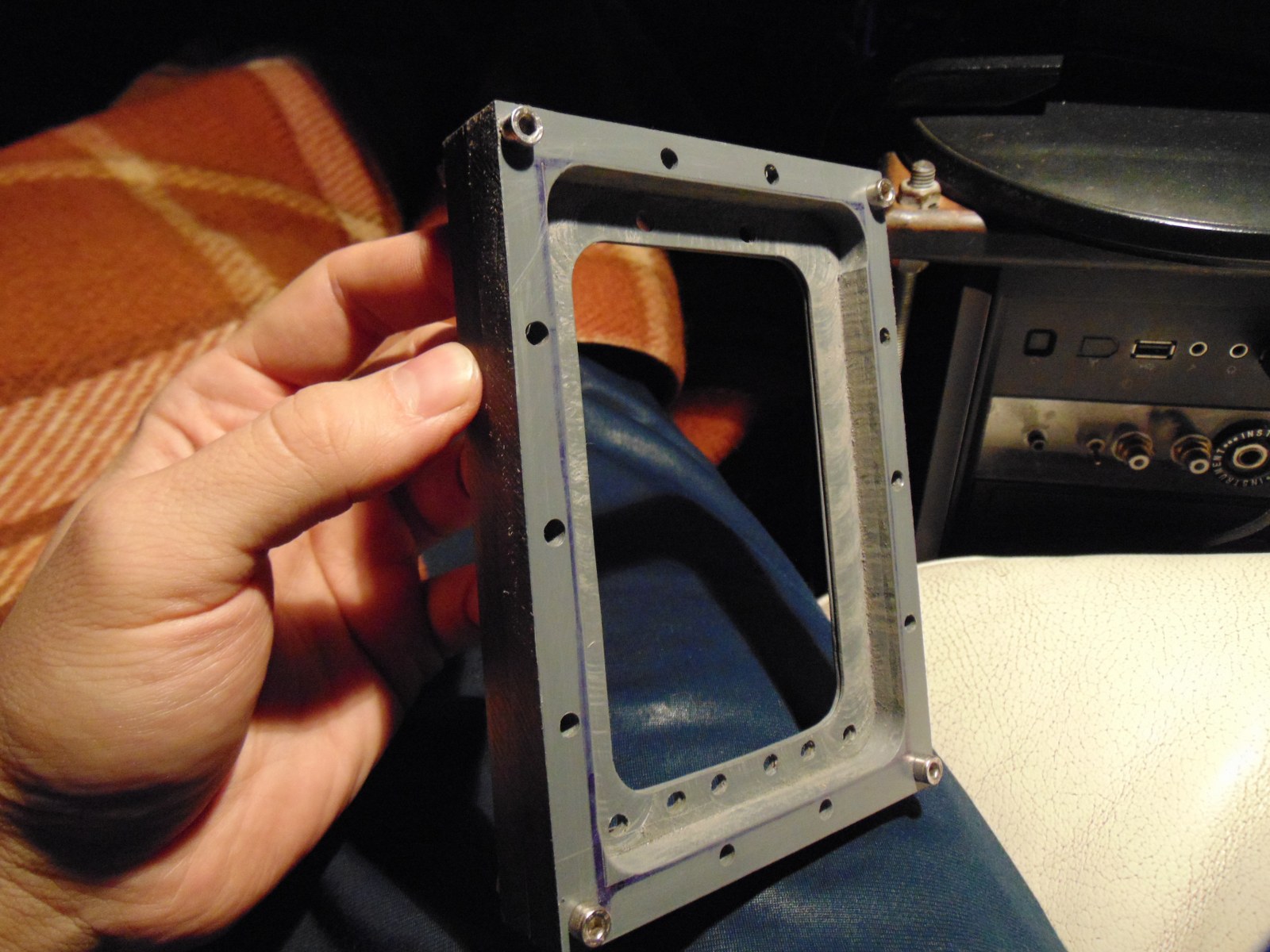

Here the good frames in PVC
Attachment 20630 Attachment 20631 Attachment 20632
Attachment 20633 Attachment 20634 Attachment 20635
Here the bad old frame, I made a wrong choice with the not perfect wooden plank
Attachment 20636 Attachment 20637
Attachment 20638 Attachment 20639

5 Attachment(s)

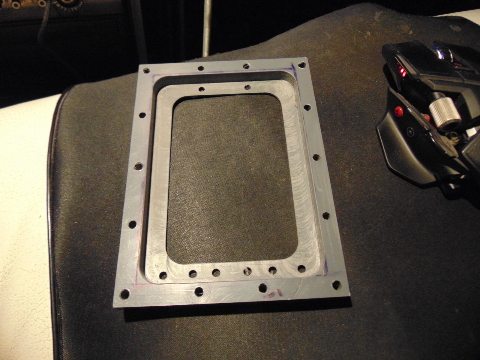

Thank you!!

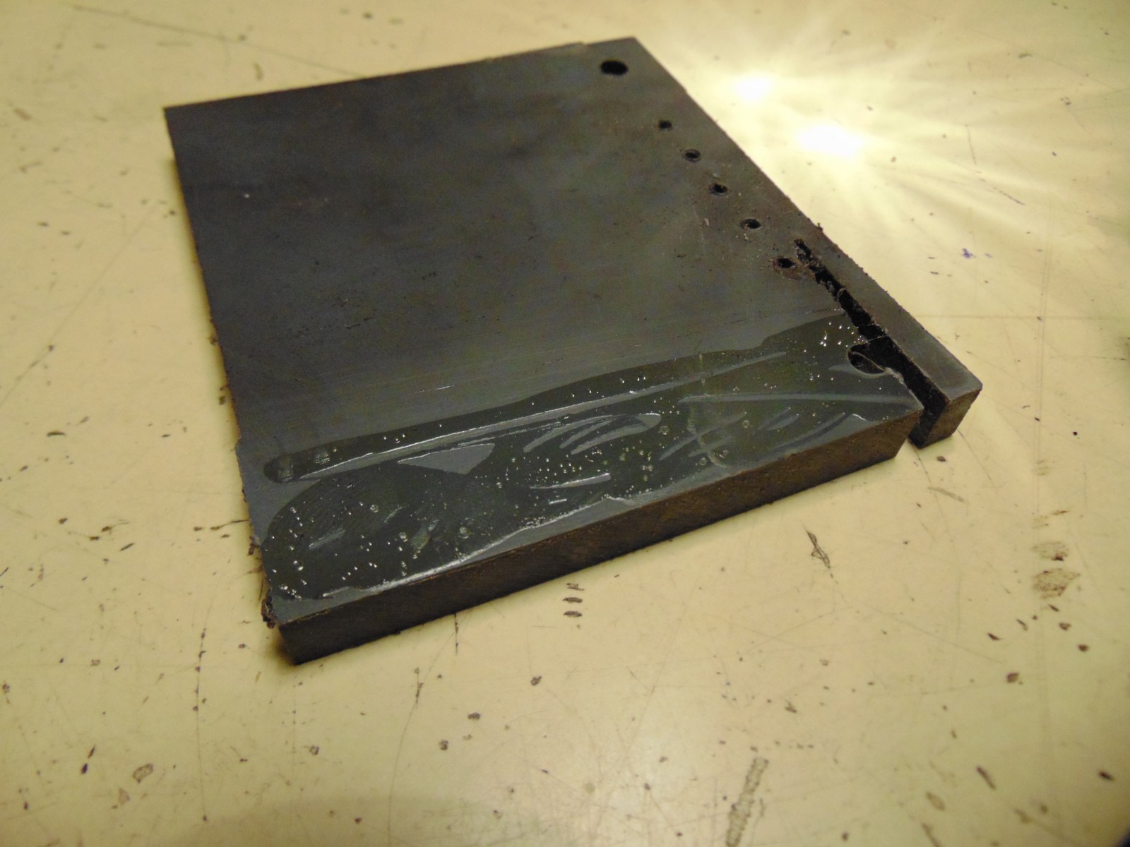

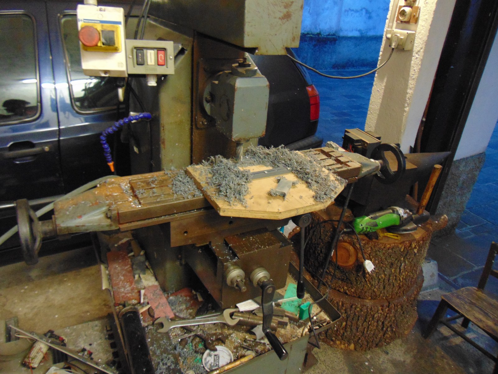

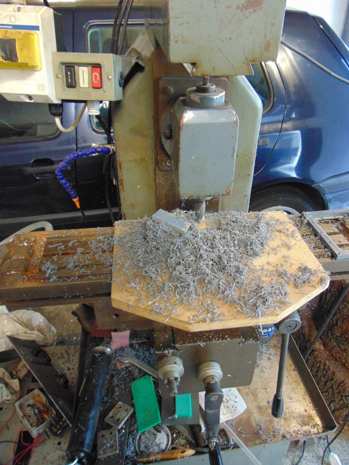

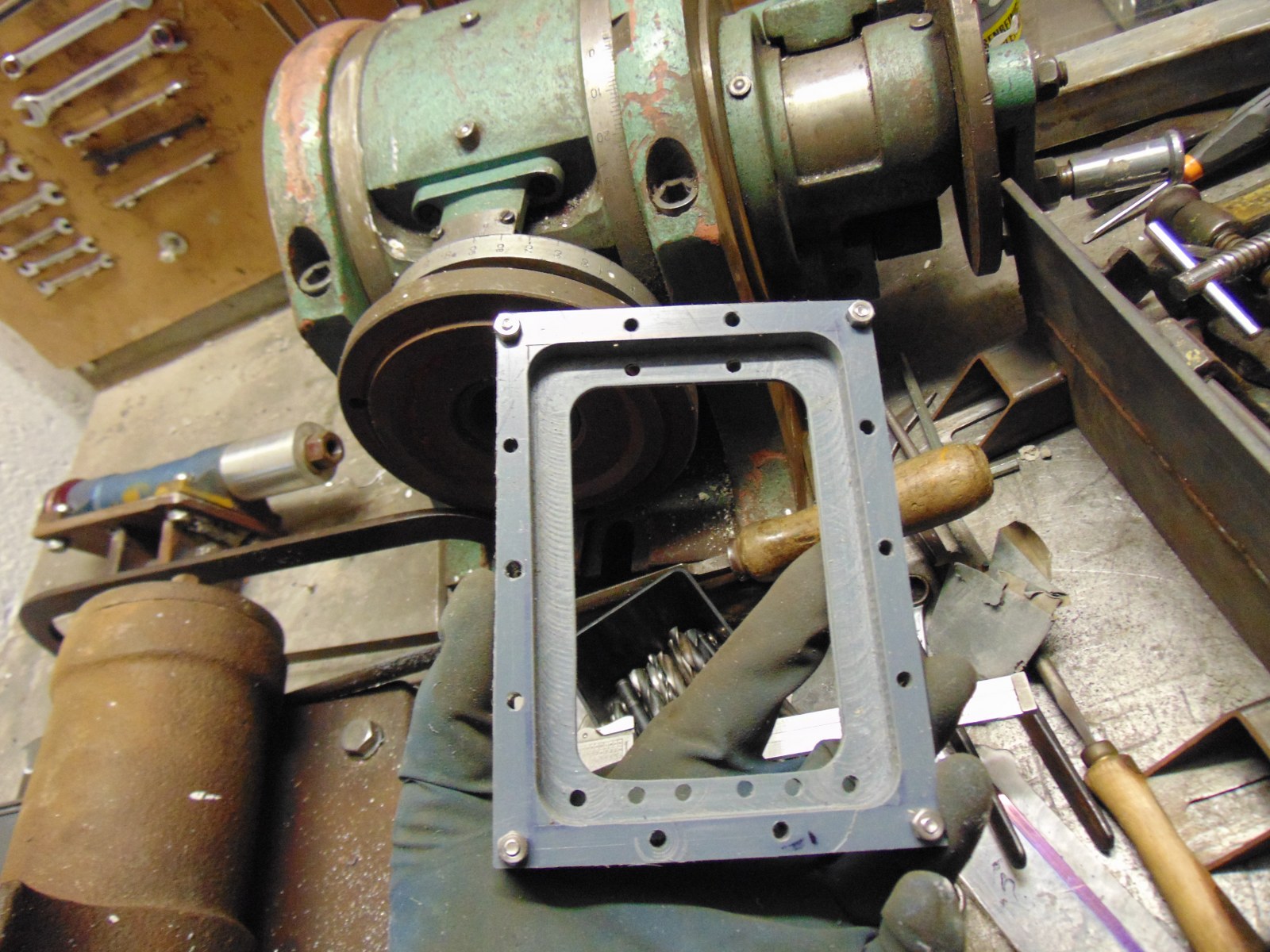

Test frame for Esl is almost finished. I modify a little the spacers, now they are 1mm. Thinking afterwards, I would not have made the holes near diaphragm, but you always think about it later.... Not a perfect job, but still usable.
It's time to model 316 stators and connections!
Attachment 20648
Attachment 20649 Attachment 20650
Attachment 20651 Attachment 20652

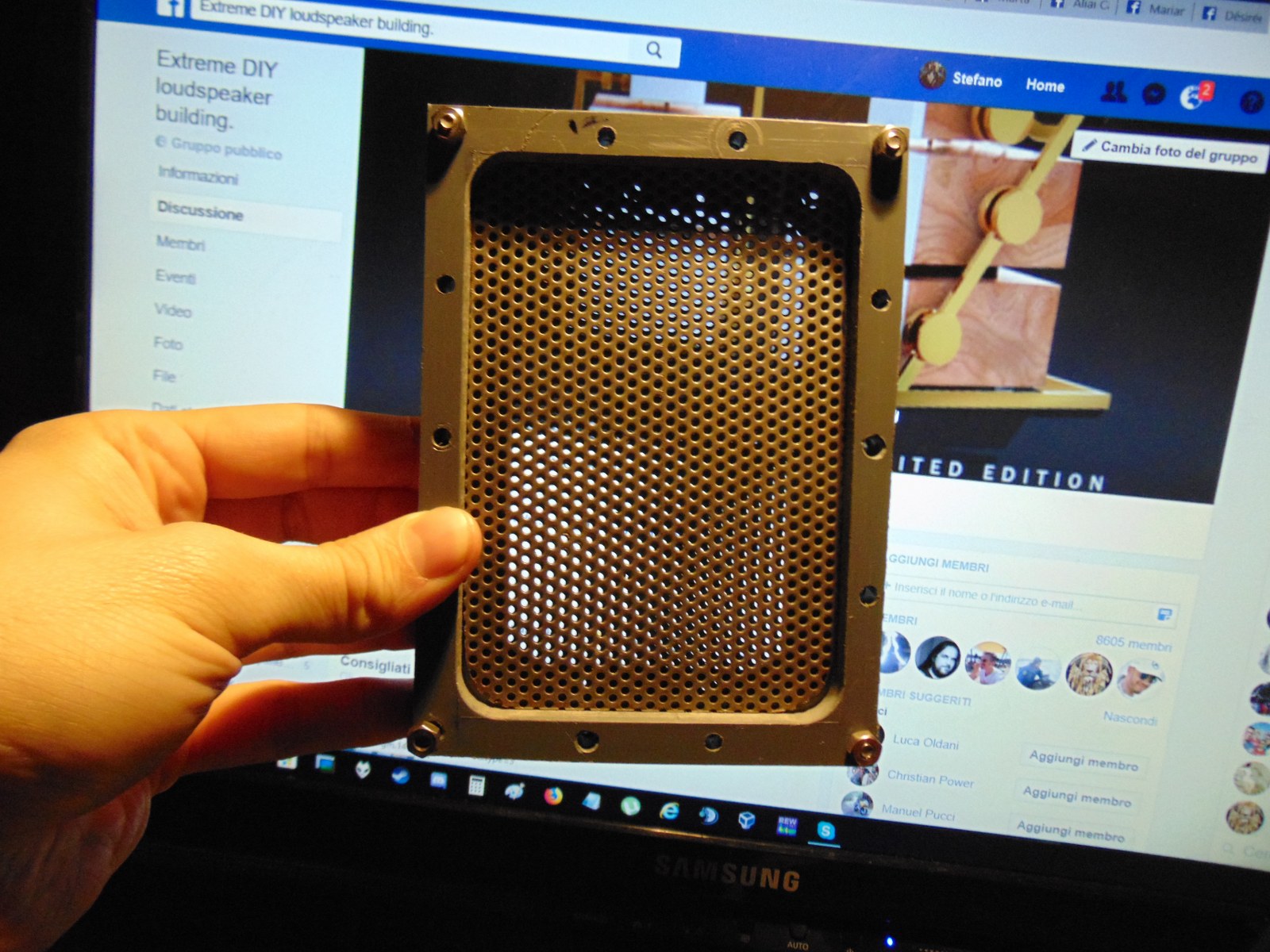

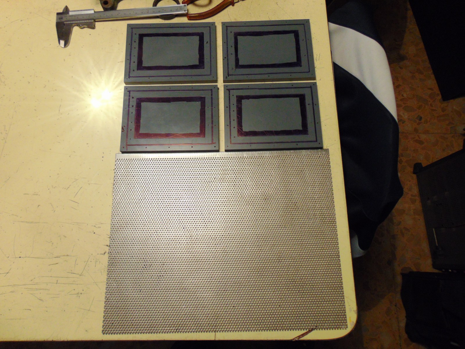

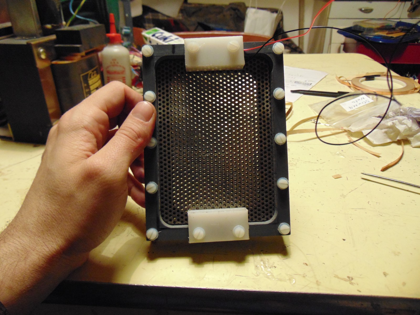

2 Attachment(s)

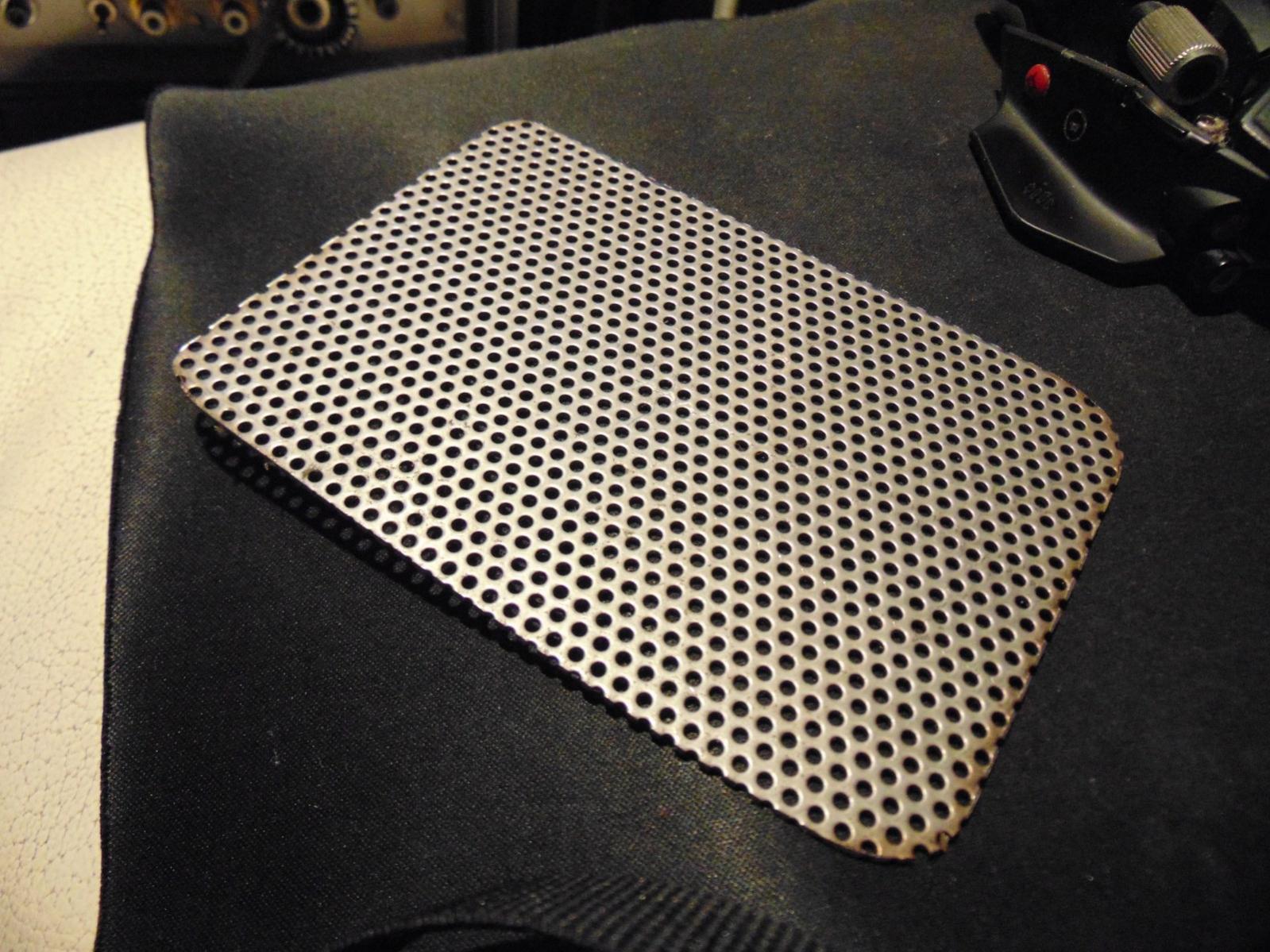

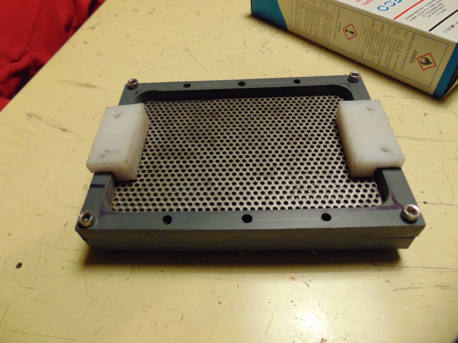

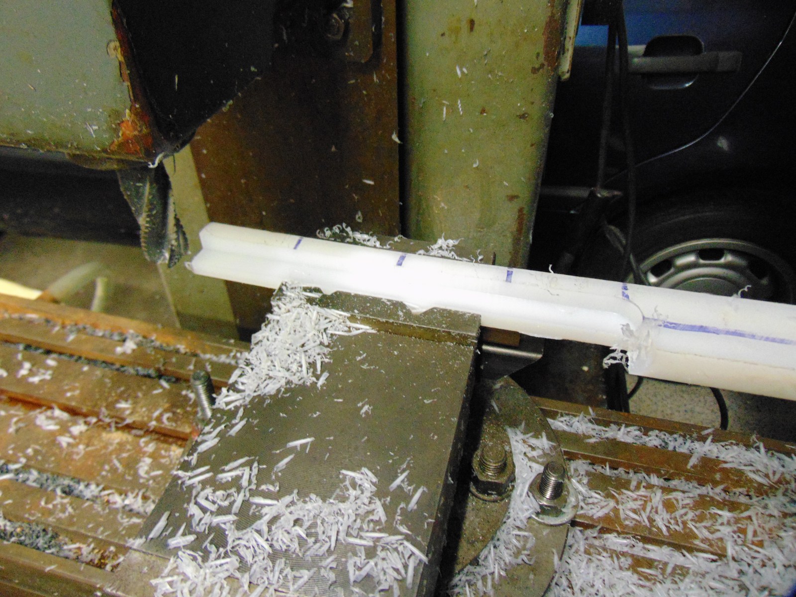

I just cut and ground a couple of 316 steel for stators. Unluckily I'm not able to weld connection without specific flux for oxi-acetylene torch, it's impossibile to use old ac trasformer welder at low current, I will go for mechanical connection for test with some plastic clamps and nylon screws. Next : diaphragm connection
Attachment 20923 Attachment 20924

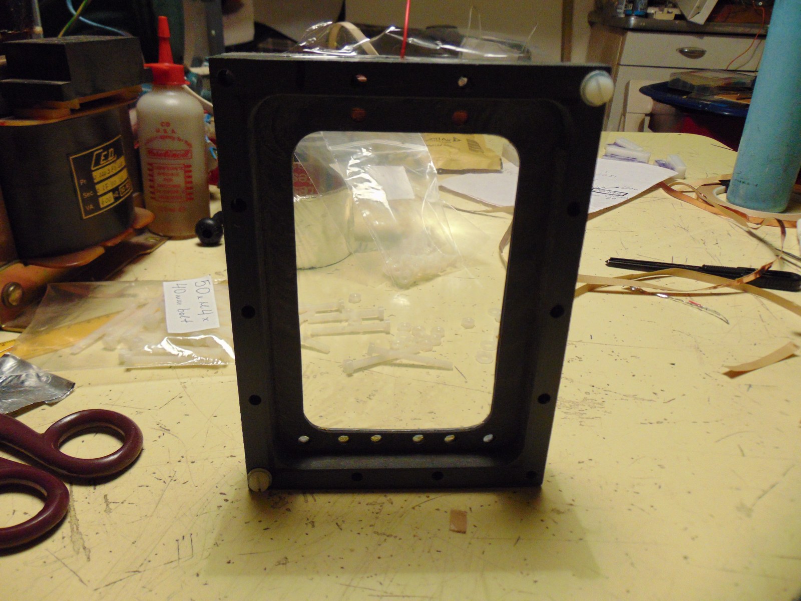

6 Attachment(s)

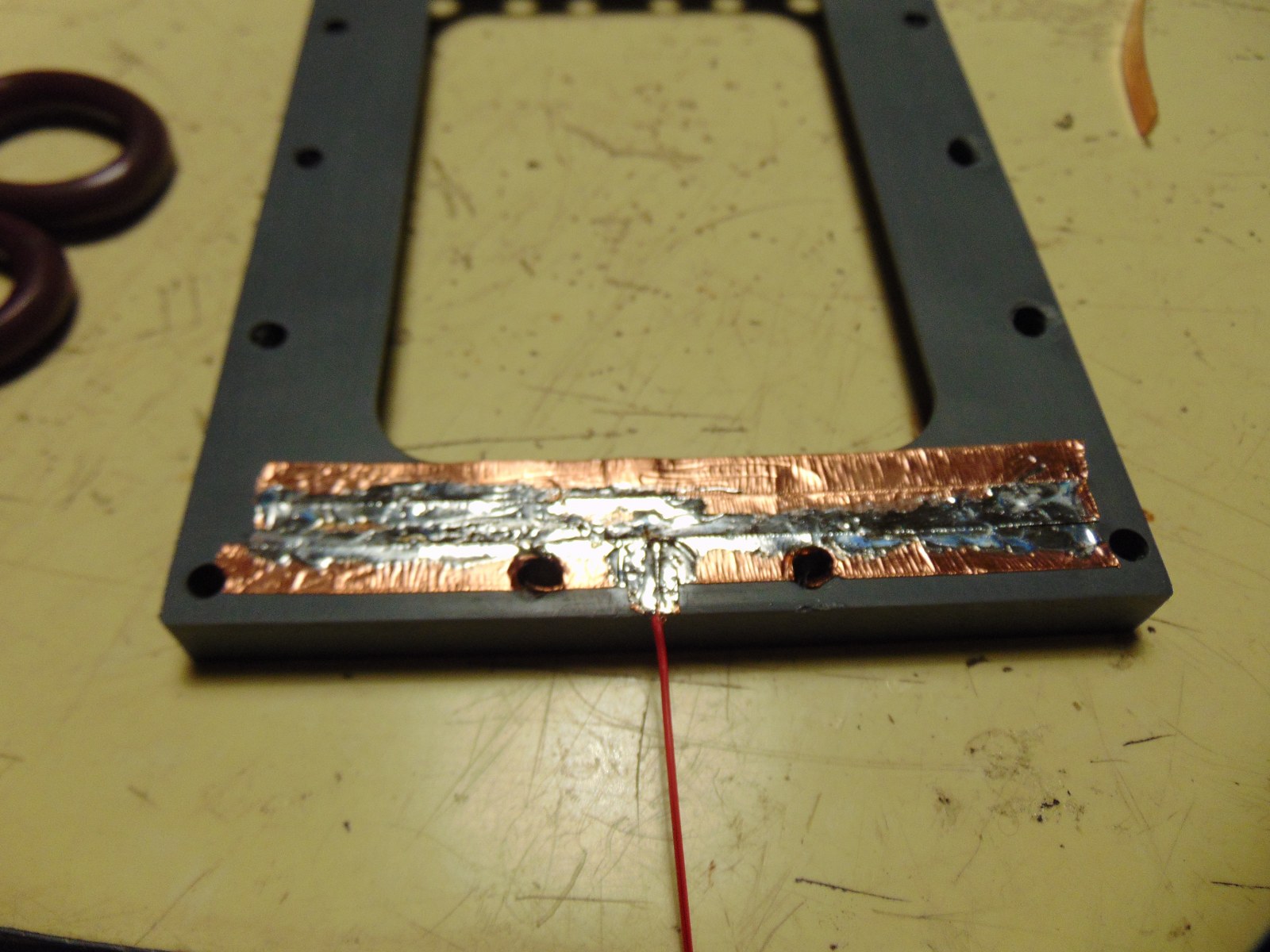

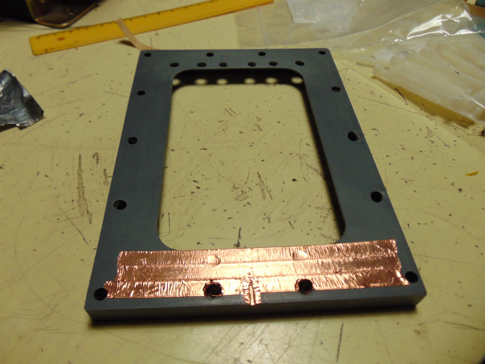

Just finished locks for stators, connection for diaphragm will be a large copper, brass or aluminum plate or tape.
I'm trying to understand if contact glue for leather is good also for pvc (120 grit sand paper). At first sight the dried glue is not easy to remove with blade from pvc, I will try!
Attachment 20960 Attachment 20961 Attachment 20962
Attachment 20963 Attachment 20964 Attachment 20965

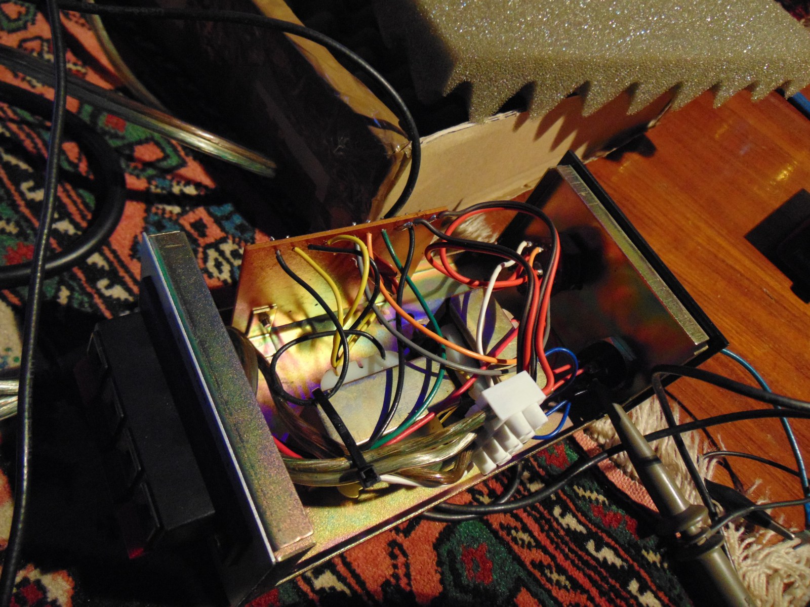

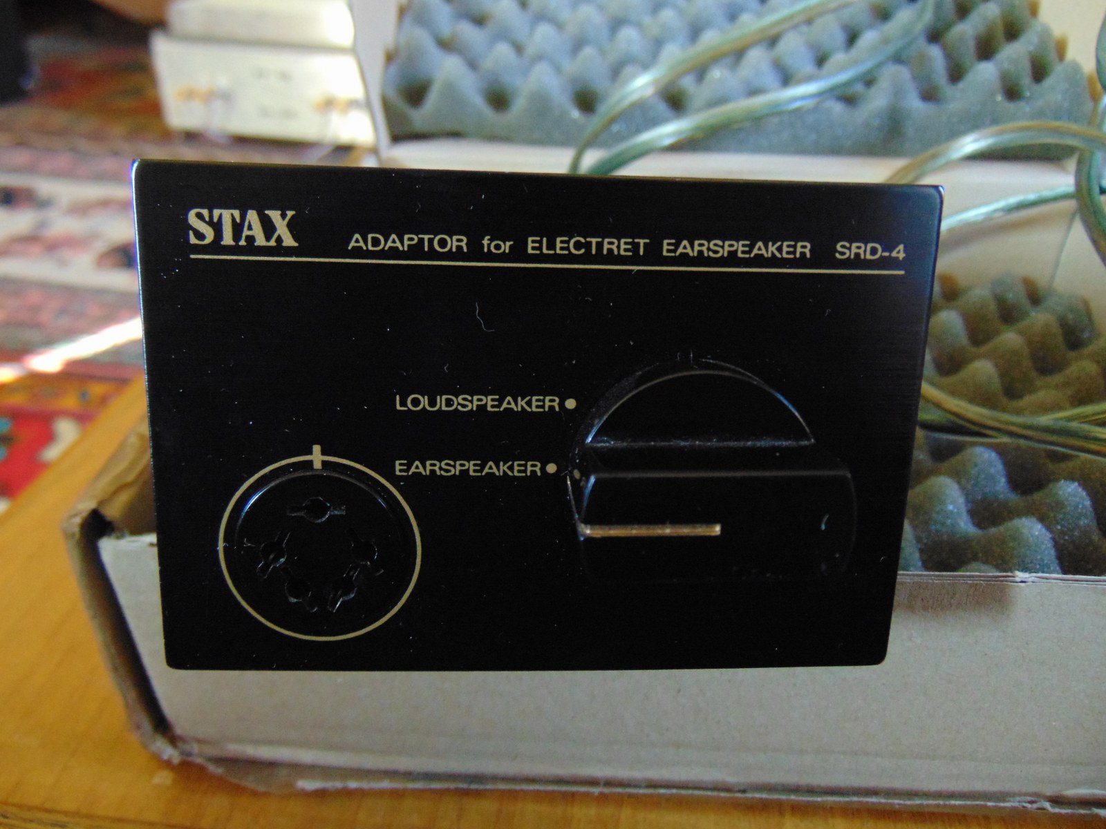

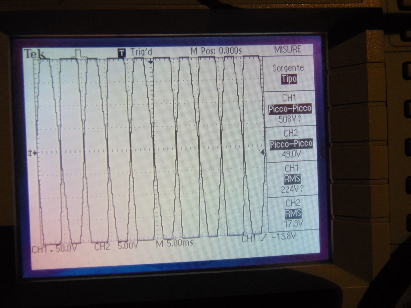

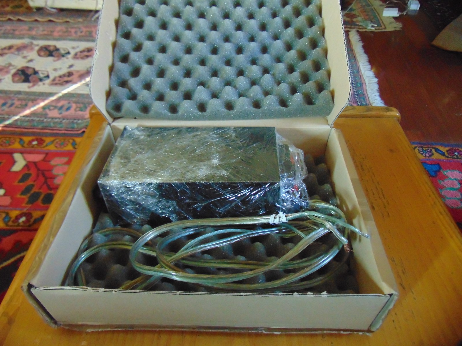

Just arrived Used (as new) old Stax electret adaptor. Basically a couple of high ratio transformer (x10) inside a box with a couple of limiters. The limit seems to be for 50v imput 500v output (peak-peak), close to perfection to drive stators with enough swing.
I tried glueing mylar to pvc with contact glue... I broke 2 times the mylar 3 micron and 3 times the 6um. It's a bastard job, I don't know how much tension is correct, books teach 1-2%, but it's not easy to Mount by hand. If the prototype will be good I will made a good stretch jig in order to replicate the correct tension.
Now it's time for coating diaphragm and making the Hv bias power supply
Attachment 20981 Attachment 20982 Attachment 20983
Attachment 20984 Attachment 20985

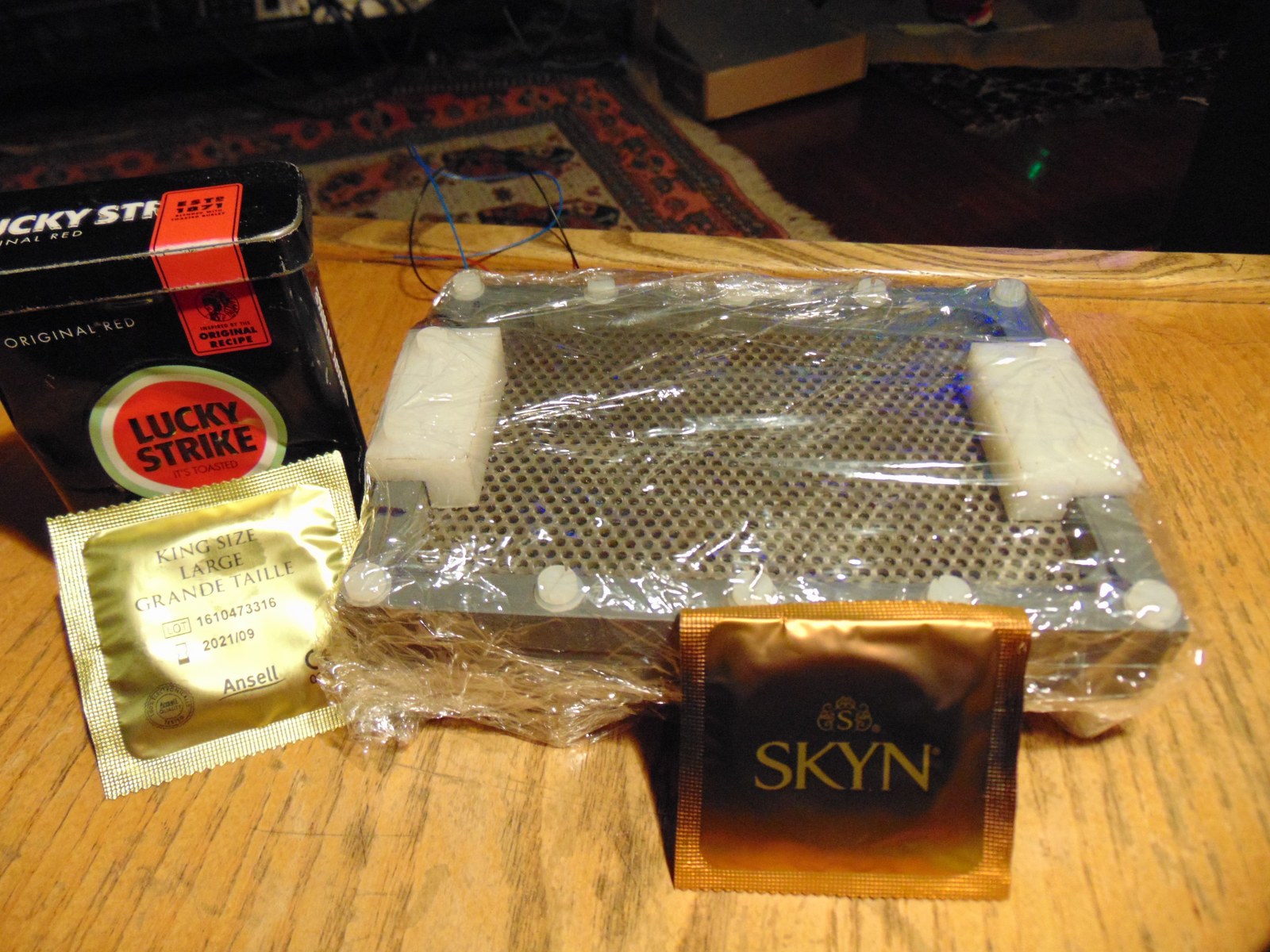

7 Attachment(s)

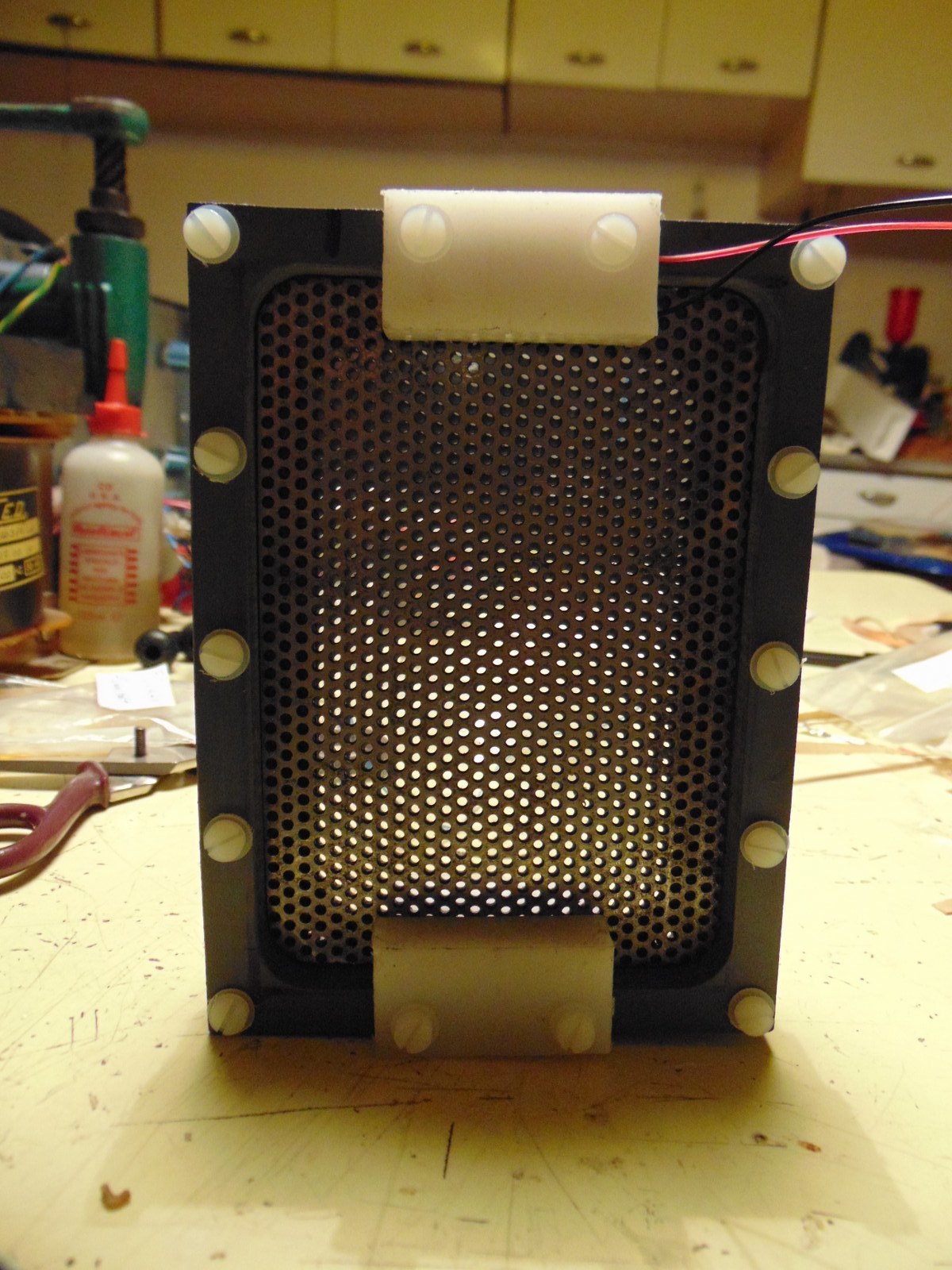

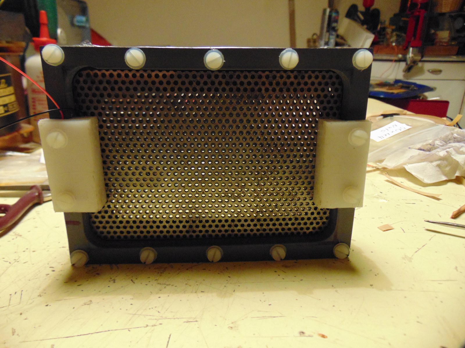

Safety first! Wear condom! :rocker:
A very big Domopak in order to protect from dust the new ESL panel. To be honest, it's not so well made and finished, but it's the first try! I made mistakes for sure so I hope to make a better job next time. I don't know the Fs of diaphragm, I didn't check, I stretched the mylar with hands and I'm very curious to know if it will sound... or it will explode :D .
Tomorrow, if I'll find all parts, I'll build the High voltage bias unit.
Attachment 20986 Attachment 20987 Attachment 20988
Attachment 20989 Attachment 20990 Attachment 20991
Attachment 20992

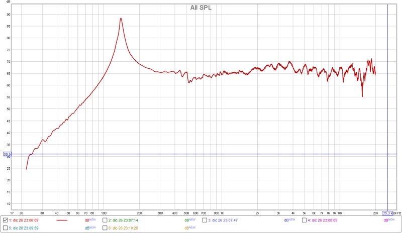

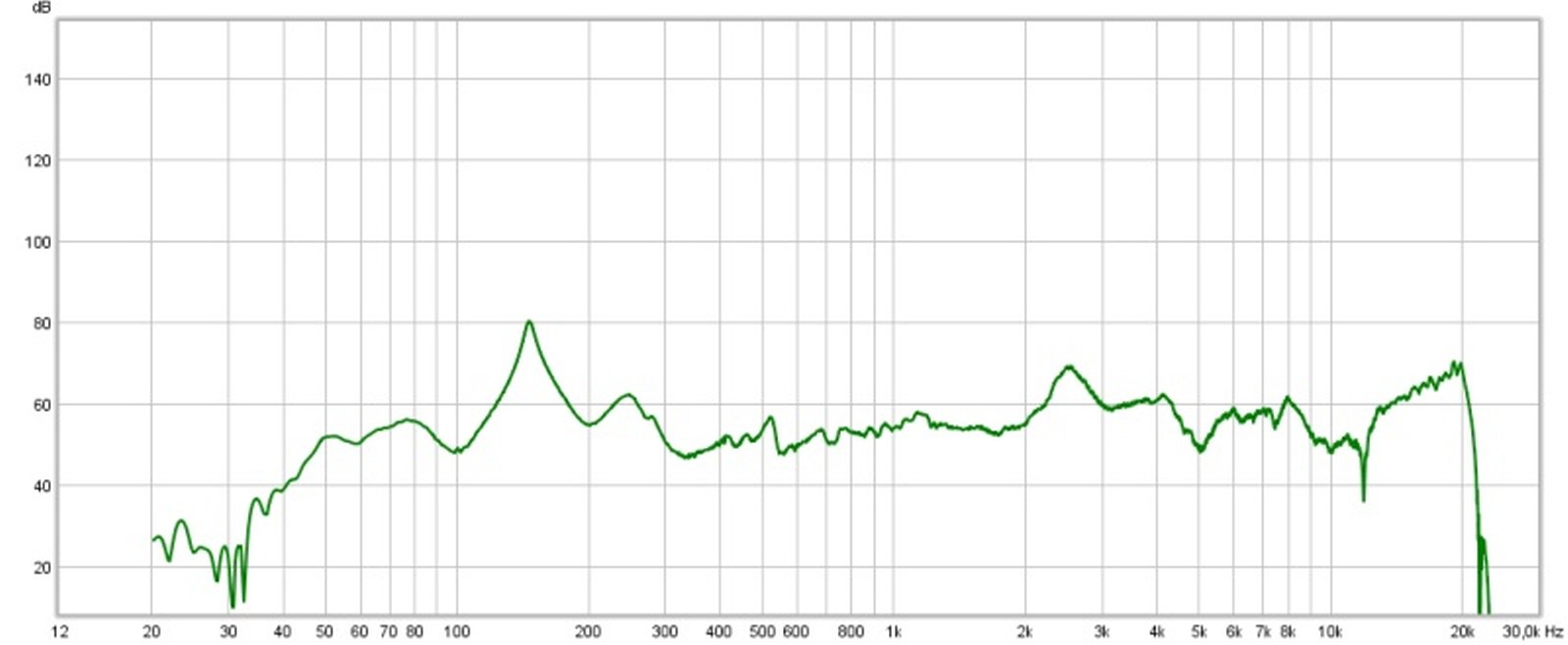

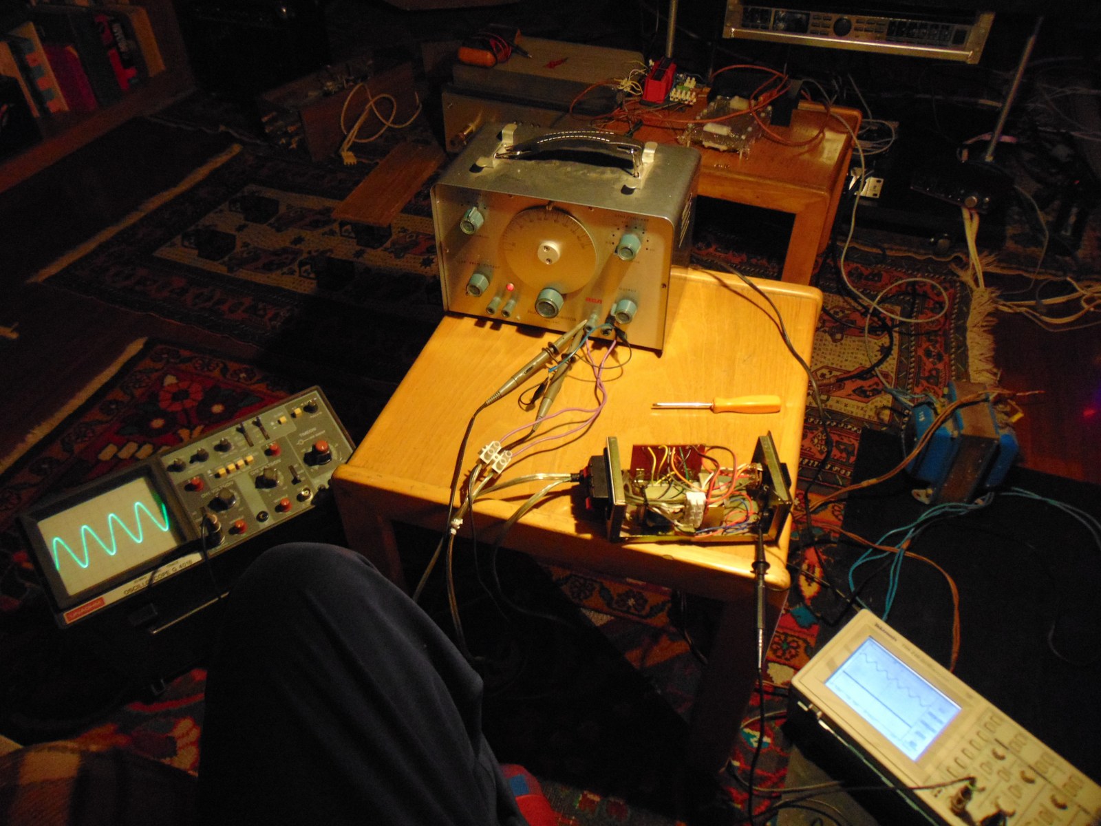

4 Attachment(s)
Merry Xmas!

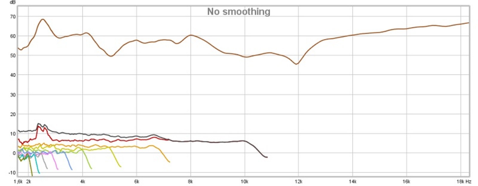

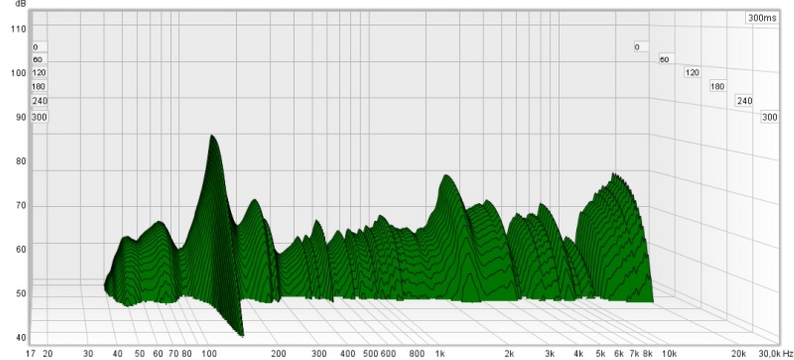

I just tried medium bias, more or less 1,2kv, results are quite good in my opinion, I have to make some serious measurement, the spl is increased. I also got some trouble with saturation of transformer core, I will connect soon the 2 transformer in series. Above all this panel needs about 5\600v p-p for high spl (not necessary for headset).
https://youtu.be/sCmVAeG3Qu8
https://youtu.be/4ZrYbGJctwc
https://youtu.be/h14WRnJY3QE
1 Attachment(s)
Pretty nice result as first panel!
Next change the tension and thickness of mylar, discovering bass range. I will build soon a couple of panel only for headphone, with right size and well tuned.
Attachment 21056
