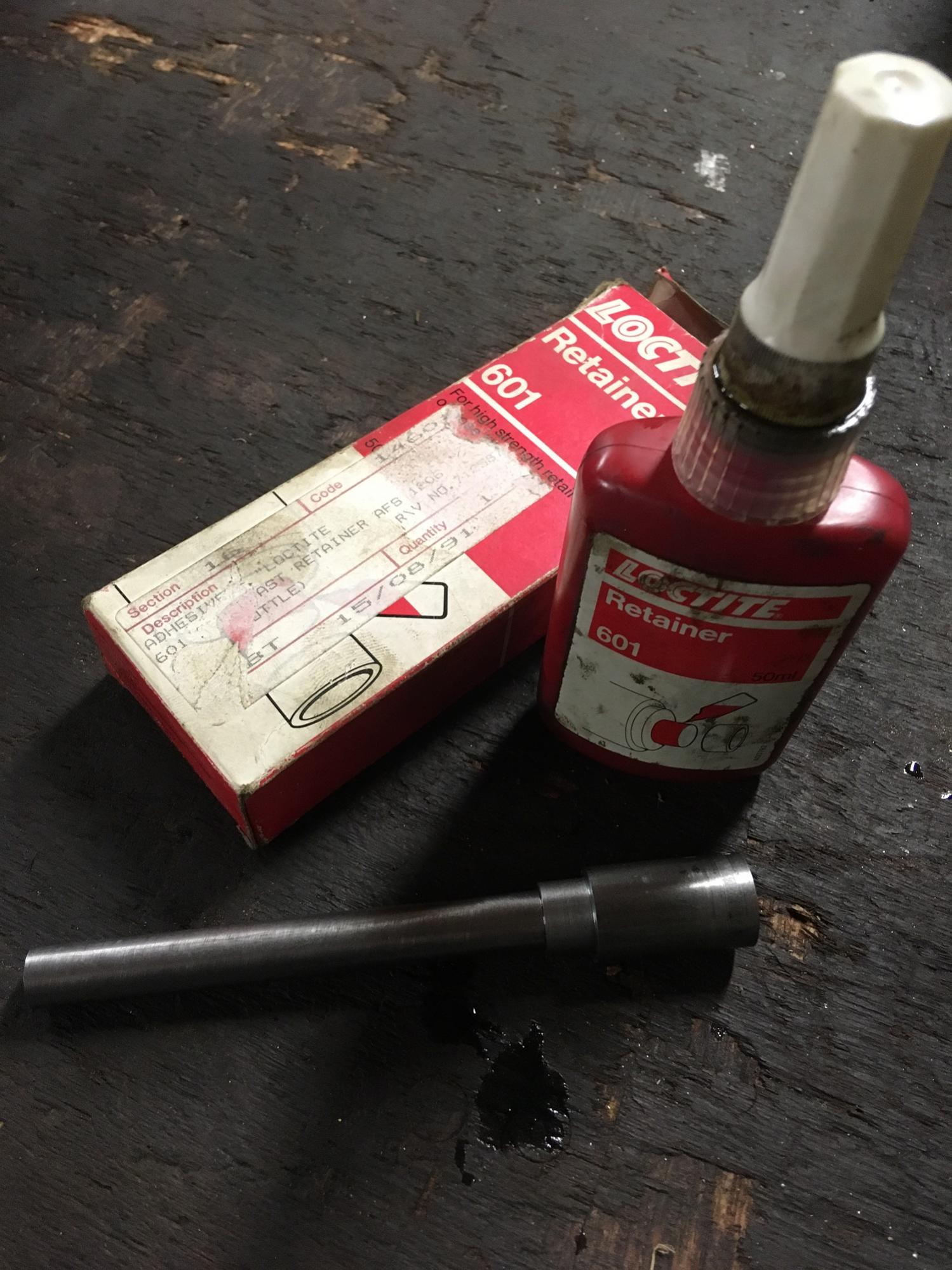

Hi All
This is a fabricated shaft for a ring roller I am making.

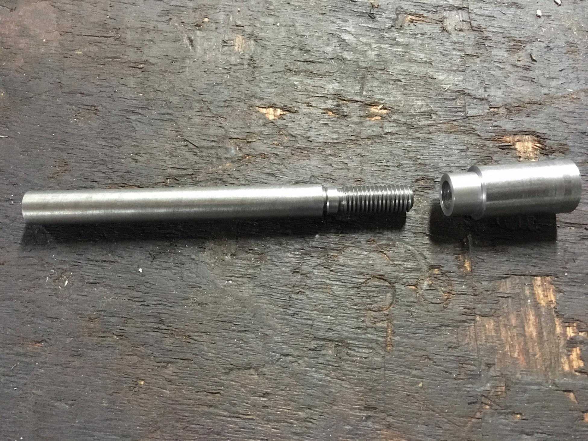

This method meant I could use 12mm stock diameter material for the smaller diameter of the shaft which fits the bearings rather than machining from solid stock. The larger end was left oversize on all diameters and once screwed and Loctite together was machined true to the smaller diameter. This method saves a lot of time and material removal.
Two parts ready to be loctited together
Attachment 22521
Loctite retainer 601
Attachment 22515

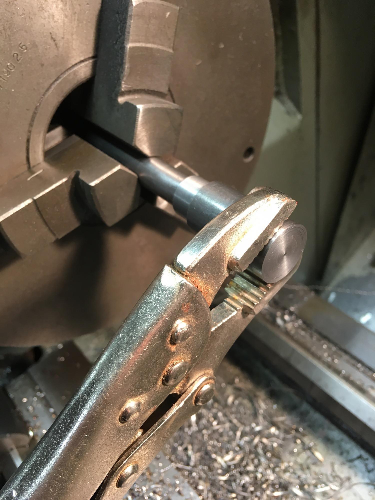

Mole grips to ensure the two components are locked tightly together
Attachment 22516

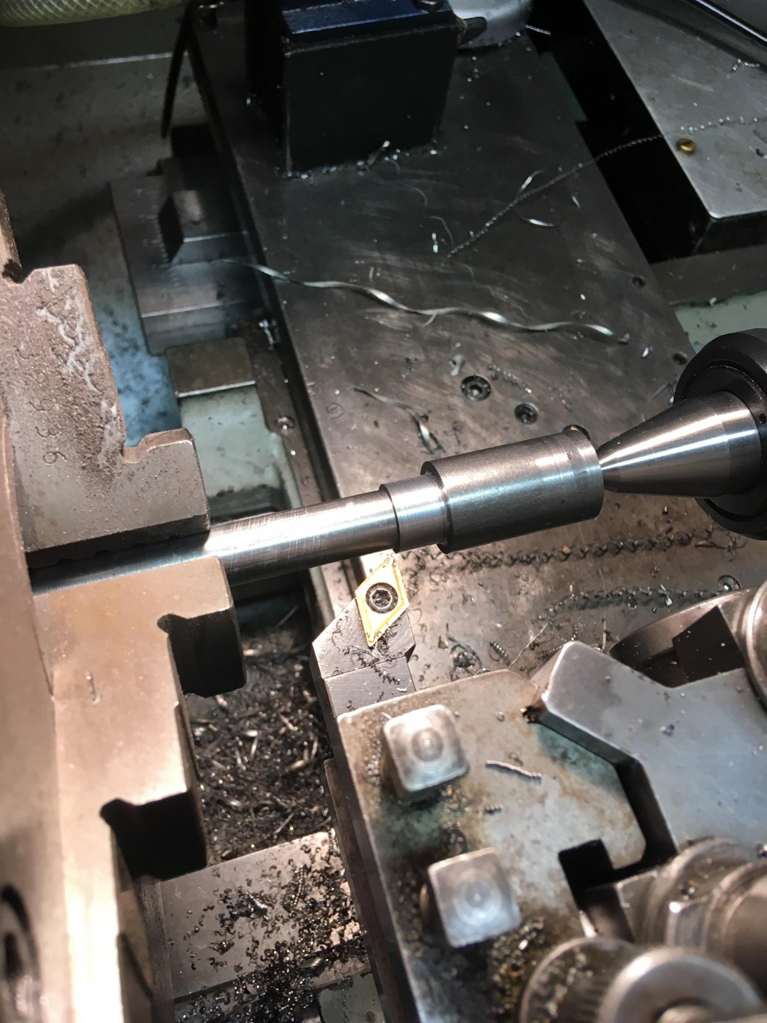

Turning with a left hand lathe tool
Attachment 22517

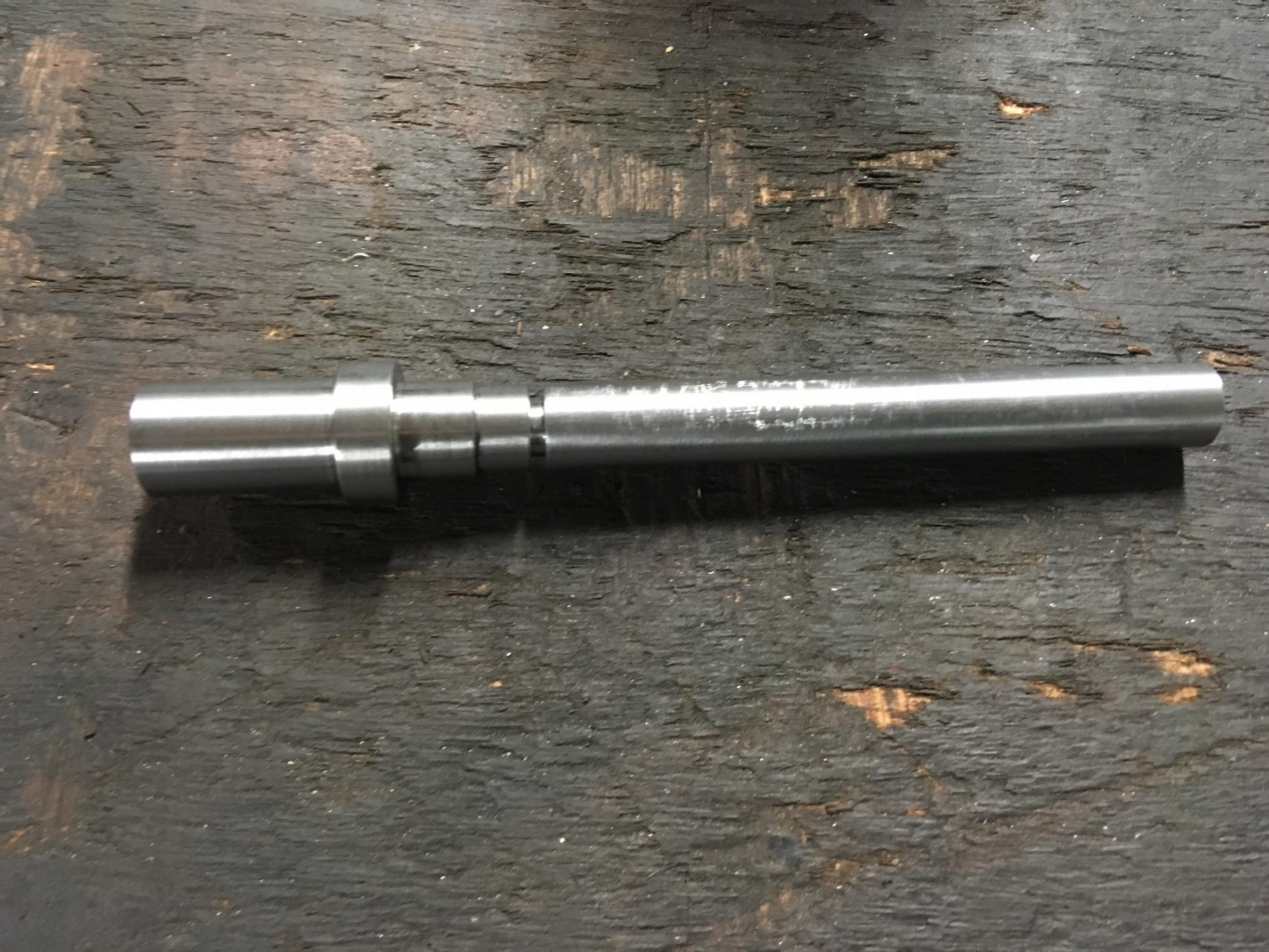

Finished turned shaft
Attachment 22518

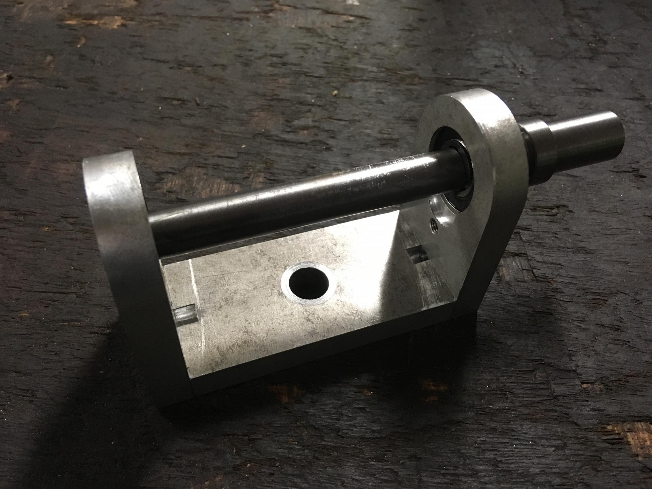

Shafted test fitted to housing
Attachment 22519

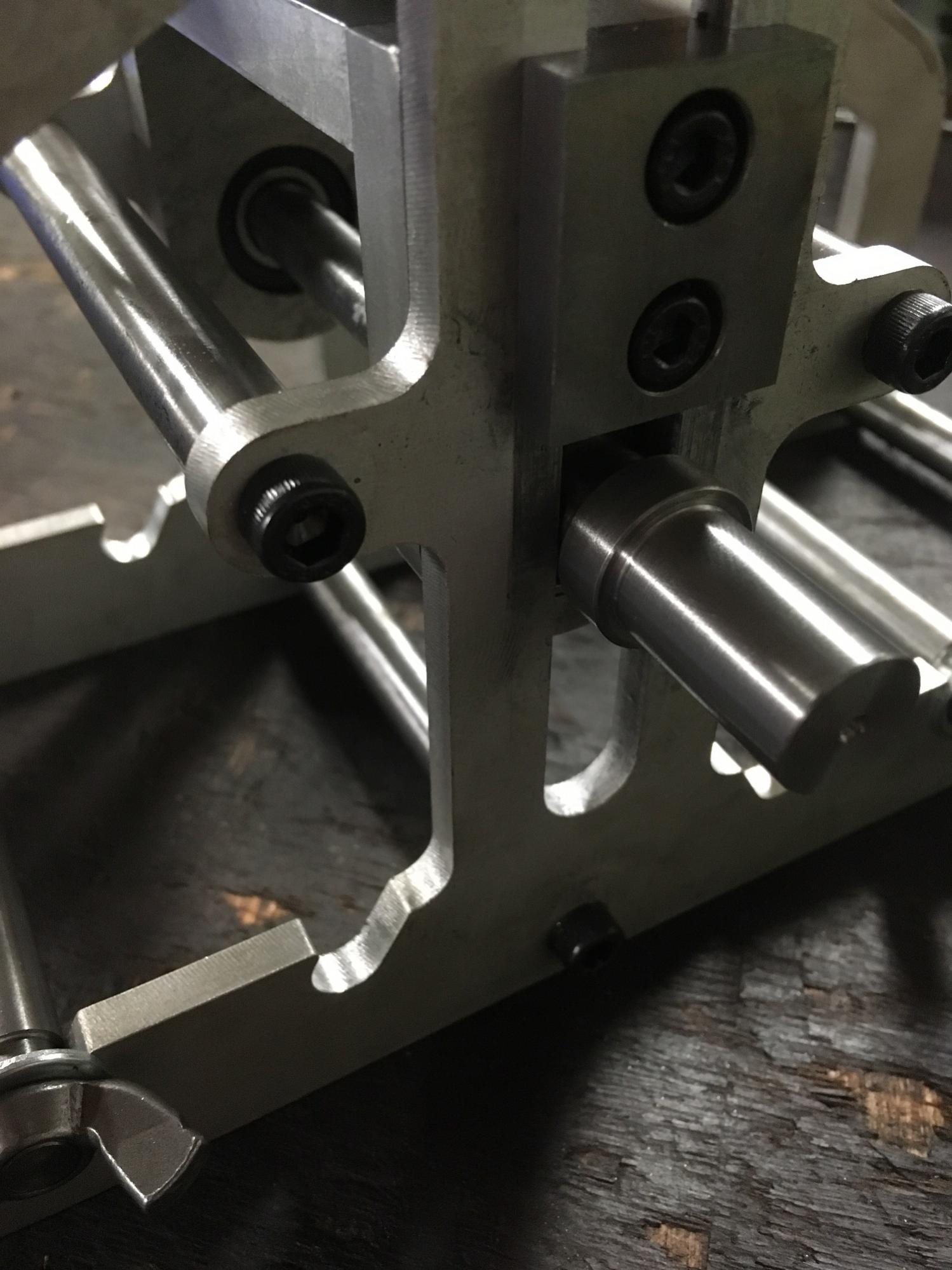

Fitted to ring roller frame assembly
Attachment 22520
Thank you for viewing
