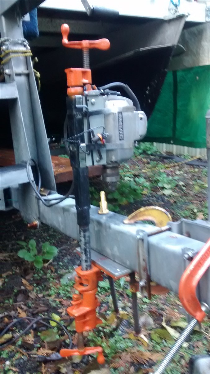

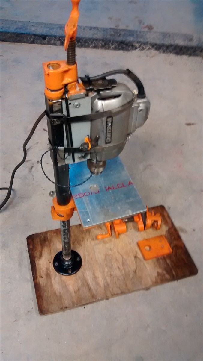

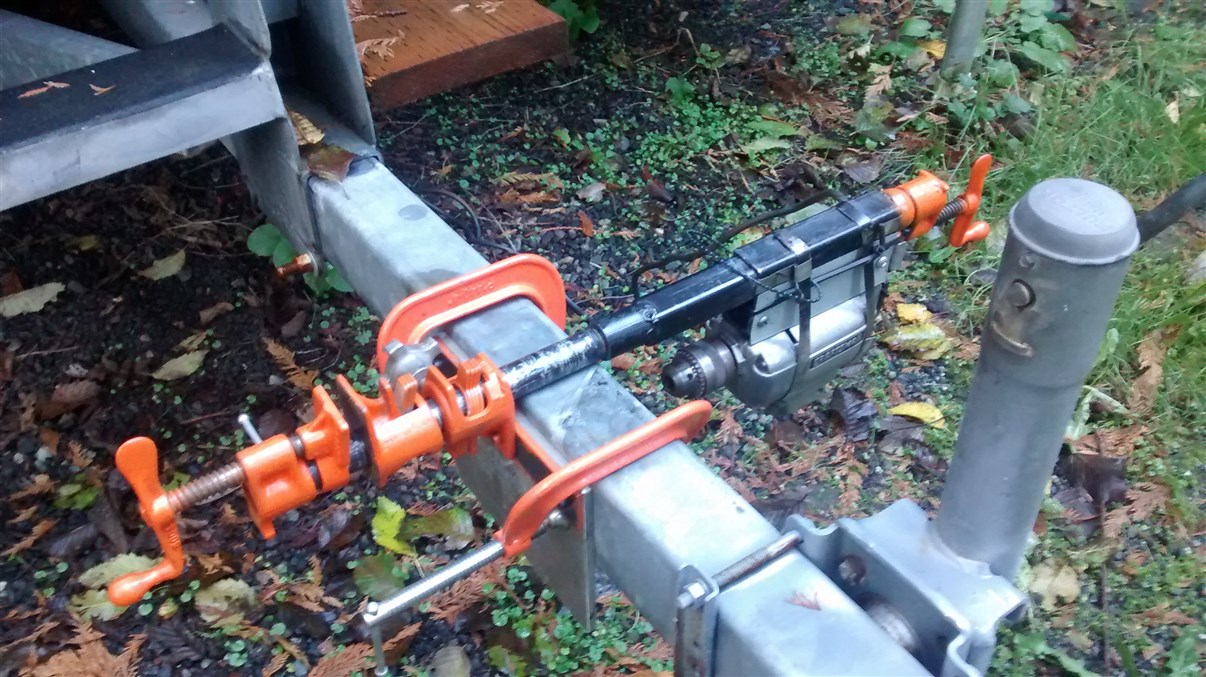

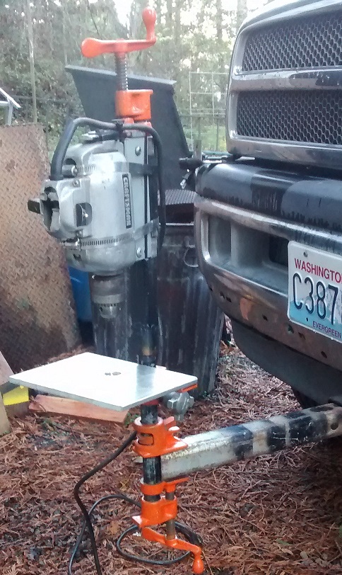

    Here is my homemade Fabricator's portable drill press. I fabricate a lot of equipment attachments for my BobCat and truck, most need large holes of 1/2" or larger drilled in steel. I've used mag drills but the weight and base size often made them awkward if not impossible to get into places I need to drill. I finally threw a portable clamp-on drill press together out of junk I had laying around. A trip to the junk box found a broken Craftsman 1/2" "D" handle drill with the switch group broken off, a couple Pony 3/4" pipe clamps,2 very large hose clamps, a scrap piece of 5/16" aluminum plate and some nesting square tubing. After some quick welding, drilling and tapping, I had a multi-position (horizontal/vertical), multi-mount drill press that could be configured quickly for many field drilling jobs.

    Nice improvising, i have seen old drill presses that hold hand drills in similar fashion, but yours looks more versatile. What is holding the al table to the cast iron pipe clamp half?

    The aluminum table plate is tapped and secured with Allen cap screws to a steel bar. The bar is a 1/4"x1.25" (the length of the table back edge) and fastened across the back edge of the plate (post side). This bar is also tapped and fastened to the Pony pipe clamp with 2 Allen cap screws.
    The butterfly handle clamps in the picture are not Cincinnati/Hargrave. They are only marked "6". I do however have a pair of Cincinnati Tool 8" clamps with butterfly handles. They are the only c-clamps I have with "lightening holes in the web.
    StingrayGS

    That setup and portable generator or automotive inverter is portable as can be, especially when the anchor is a receiver hitch!

    1. is the drill unit free to rotate around the pipe column or do you have it keyed to prevent rotation?
    2. is the pipe bendy or do you find it stiff enough for your needs?
    This is a great idea for putting trailer hitches to work on service trucks and the like.
