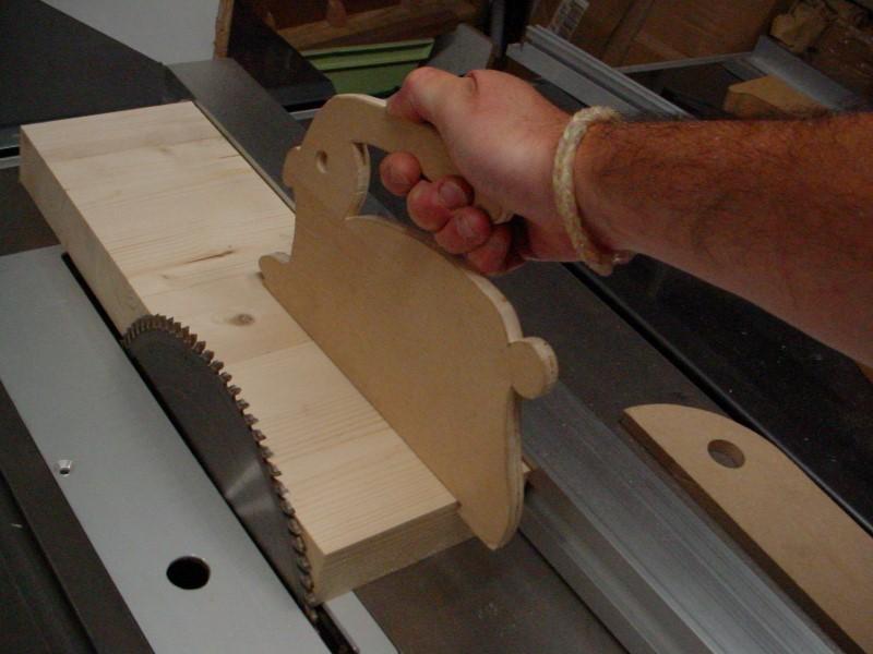

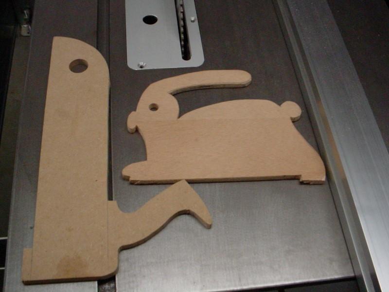

Hi !
Here are a couple of push sticks ideas :
La Belle Note - Push Sticks
http://www.labellenote.fr/file/Woodw...n_poussoir.JPG
http://www.labellenote.fr/file/Woodw...ussoirs%20.JPG
cheers !
Hi !
cheers !
Ha. Something whimsical for a change! Thanks for the post.
It sure is nice to see a different design other than handled and deer foot types. Very creative of you Christophe.

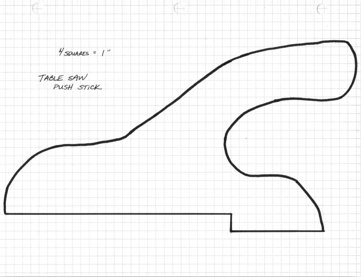

I'm new here. how do I download the plans? also in google it was these:
Attachment 45033
the top one was what I used during shop class... but now I can't find it online :(.
The top one could run your hand into the saw blade if something goes wrong. A link to other designs instead of posting the pdf, due to unknown copyright things.
I'm not a fan of ever having my hand over or near the side of a saw blade.
I ended up making this one: Attachment 45038
duct tape, frank, what do you mean really?
cause I've looked at the ones you suggested duck and except for that one:
Attachment 45039
except for that one (if I were to hold it from the very top), the hand position for the rest all seem to run pretty close to the blade (well I'm ignoring the obvious sole stick).
PS. the one I originally wanted was from popular mechanics and they've since removed the link I believe... I went on that particular page so...
