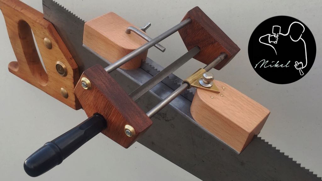

Sharpening a saw can be one of the most "difficult" tasks for a woodworker. I built this guide for sharpening hand-saw teeth at the required relief angles, for both rip saw and crosscut saw.

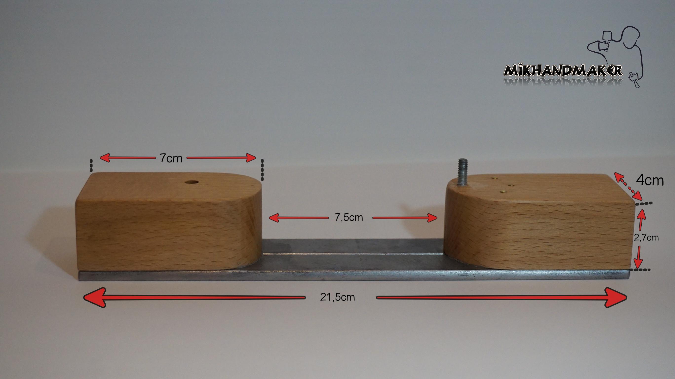

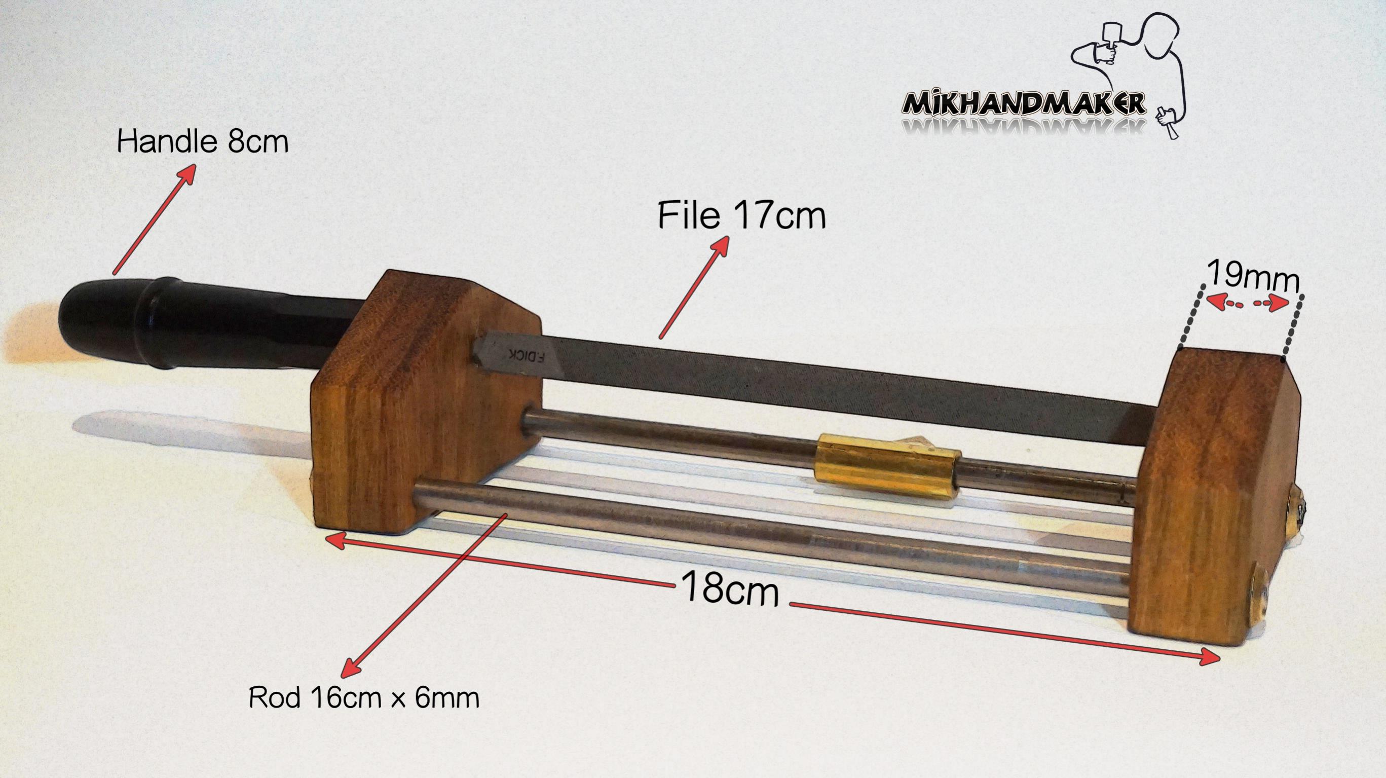

Inspired in an old tool from 1987 hard to achieve (at least where I live) and using materials available to anyone, I show you the step by step to make it by yourself.

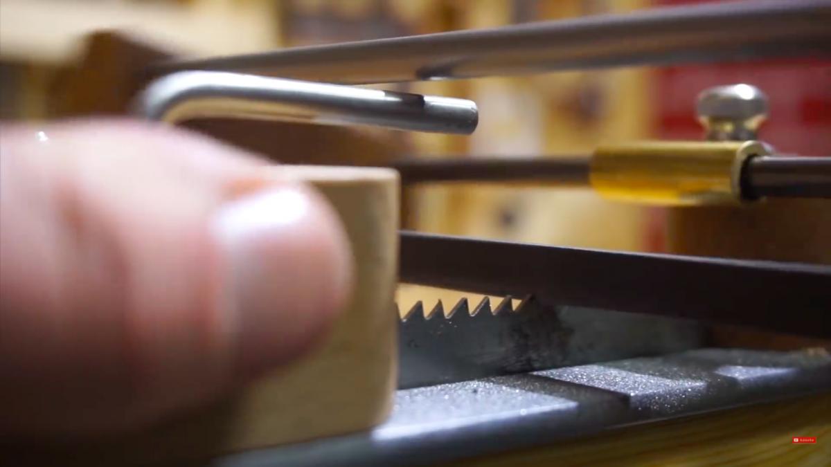

It is very important to clarify that the files work only forward. Therefore, the force when sharpening only has to be in that direction and the backwards without pressing, thus, we will avoid premature wear of the file.
