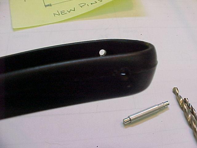

Drilling the handle for the new pins. I popped the other pin off with a razor knife and drilled the first holes with a 1/16th dia. drill. Using the old pin locations as guides I carefully drilled these first holes to ensure the new pins would be on center.
