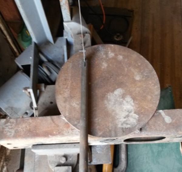

So I turned 1 end of a 7/8" 1018 round bar down enough to fit in the chuck on my drill press then set my band saw up right and placed the made from scrap table on it then made 2 cuts in the other end of the rod to form a slot wide enough to place 4 layers of 1" wide 180 grit cloth in itAttachment 18131

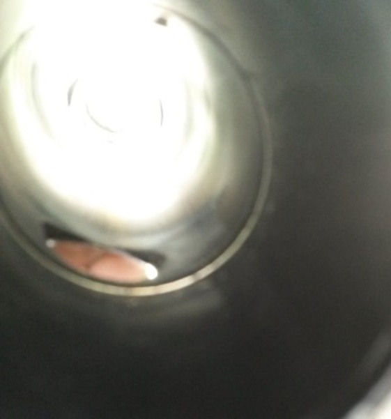

Before

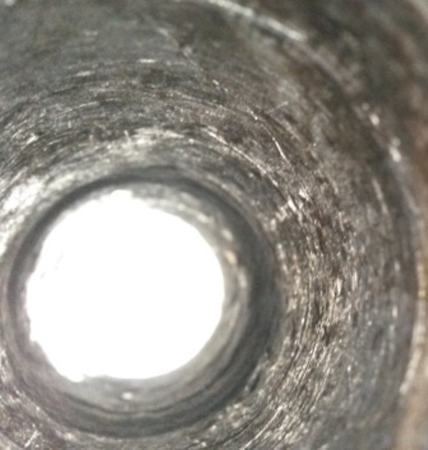

After
Attachment 18133

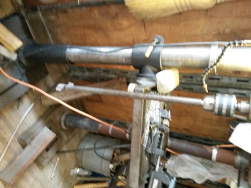

mounted in the drill press
Attachment 18134
I just left the drill press at the speed setting already on it, way to much drama to change RPM for a project like this
I just held the flashlight body by hand and moved it up and down
