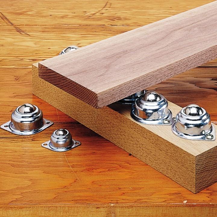

    Why not try something like this you could use extension springs to hold the table down or centered on the ball rollers you movement would be limited only to your imagination.
    They are called ball bearing rollers

    Interesting thought. Thanks Frank. I will check it out more.

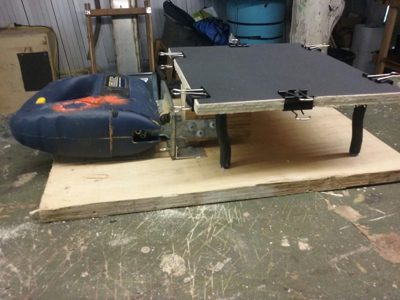

    I am going to experiment with some short lengths of silicone rubber round bar. Will have a cup top and bottom out of pipe then force the ends in to them. Drive will be from a cheap variable speed jigsaw. This will give me a recpricating table to clamp sandpaper to. The idea is, if using a disc sander, you only use about 65% of a sheet. This will use close to 100%

    Version #1. Sort of works but main issue is the travel of the saw is too much. The overall action is too violent. I was going to add an image but looks like this stupid site requires some outdated format or something.

    Version #1. Sort of works but main issue is the travel of the saw is too much. The overall action is too violent.flexible mounts for sanding table-20180223_122651_resized.jpg

    Now that I see what you were making. many of the ideas for movement control that were published would have worked equally well.
    As for being violent there are 2 ways to tone that down one being mass the other being variable speed
    many saber saws have a high and low speed others are variable I have one that has both
    you could use a link bar between the saw and the plate with a pivot being closer to the plate than the saw something like 1.5 to 1 or what ever it took to reduce the total movement
    Or you might try attaching a stiff extension spring to the plate then attach the other end to the saber saw this might dampen the stroke and the violence.
    If that is not enough then attach a second spring to the plate where the first spring is connected and attach the other end to the base mount
    I built a small gold sluice several years back using a similar spring set up
