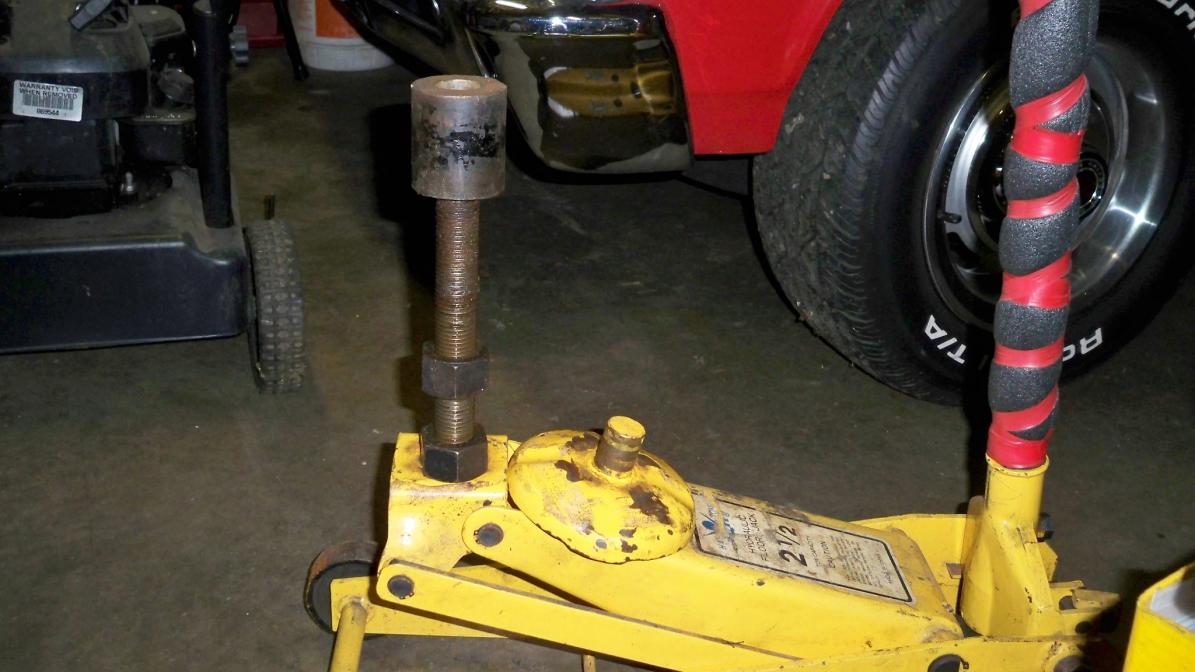

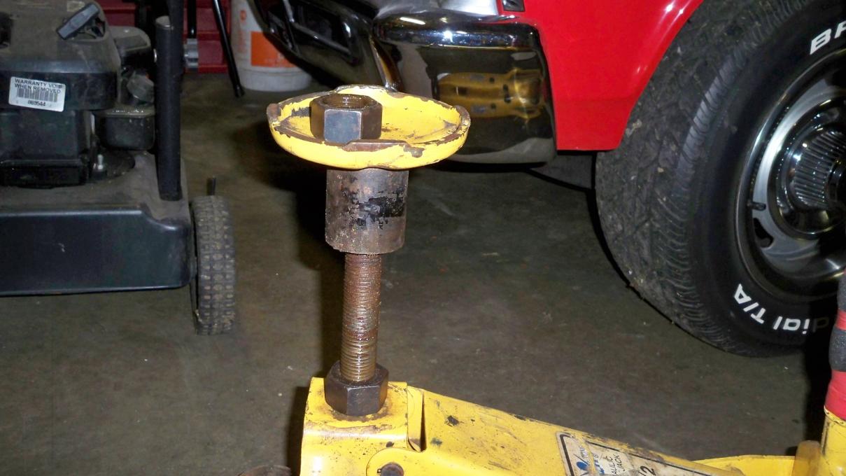

Attachment 634Attachment 635 A heat treated 1" steel stud bolt,a short piece of steel pipe with heavy cut washers welded on both ends,Bolts to floor jack by 2 large nuts and the jack "cup" drops in the piece of pipe.
