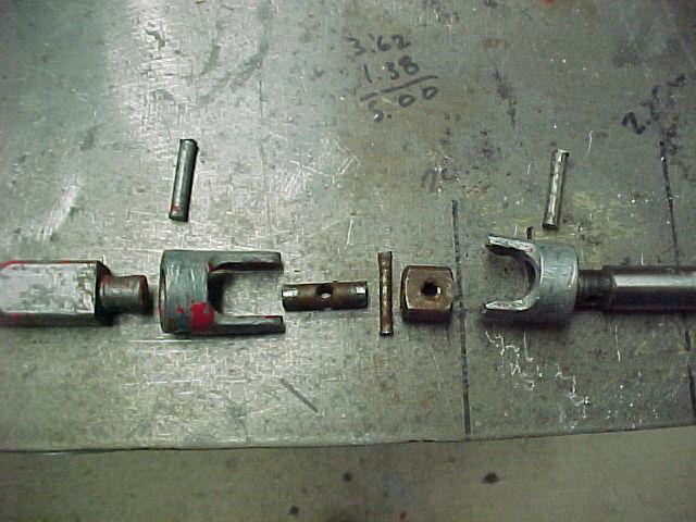

A friend of mine broke the diecast universal joint in his Craftsman floor jack. He couldn't find a replacement universal so, in looking at the broke pieces, I figured it wouldn't be that hard to make a new one out of steel.
http://images61.fotki.com/v535/photo...MVC011F-vi.jpg
The pieces aren't that big. Only 3/4" in diameter. All of the parts after dis-assembly.
http://images54.fotki.com/v104/photo...MVC015F-vi.jpg
