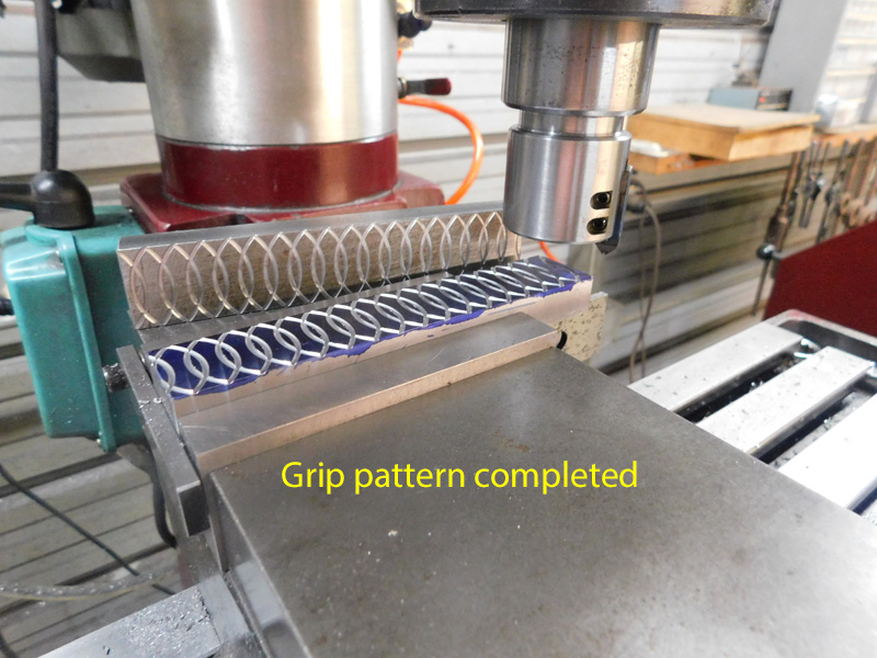

    That came out nice JR. it does leave a nice finish and you can run it at a pretty high RPM ! I did find another use for it other than just a fly cutter, it did a great job on creating a grip pattern on the new vise jaws I made for my bench vise too.
    Thanks for posting your completed project. click the photo to enlarge Fly Cutter with R8 arbor for the mill..Plans available by Rossbotics.-2.jpg

    Thanks Doug, I never would have thought of using the fly cutter for that pattern.
    If you had not posted how it was done I would have thought hours were expended
    with a rotary table and end mill! Your method would be so fast in comparison.
    Cheers, JR

    Just goes to show us that age old ideas have their place. And it's nigh near impossible To match the finish you achieve with a fly cutter with anything else. Plus the tooling is way less expensive.
