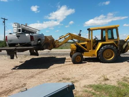

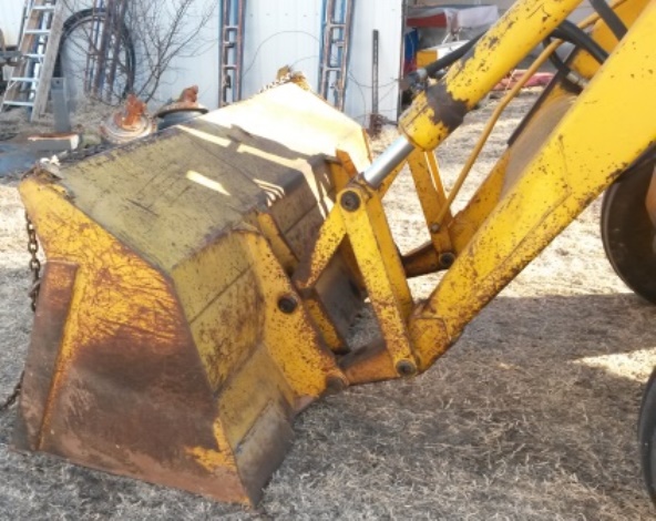

    The loader on my 755 is so strong that I can almost bring the rear tires off the ground when I don't have a bucket mounted on the backhoe. The problem here is that in order to lift something that I cannot scoop up in the bucket I have to get out and chain what ever it is to the bucket I need to use it as a fork lift a lot so I decided to see about getting forks for it. I didn't want some week little clamp on forks that slip over the cutting edge besides it is hard to see what you are picking up. I also didn't want to have forks that hook to the top of the bucket either same reasons.

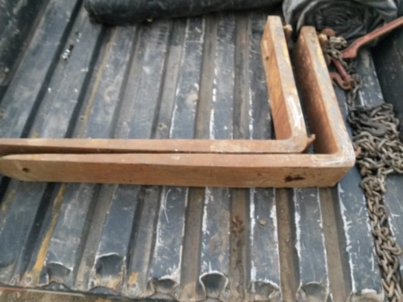

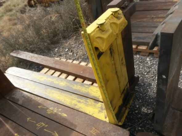

    The most suitable carriage I could find was a class 3 good for 8 to 10,000 lbs it was 5 ft wide and they wanted $300.00 for it plus another $350.00 for a pair of forks plus tax. Well I wasn't prepared to spend that kind of money, so I went to a steel scrap yard and found a pair of heavier class 3 forks than the others for $150.00.
    I bought them so now all I have to do is come up with a carriage. Time to look in my usable stock.
    Here is the pics of a factory carriage which I was going to have to modify anyway to fit my loader arms
    and these were the forks
    These are the forks I bought

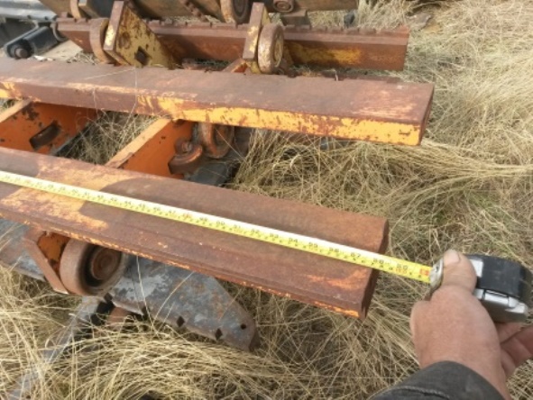

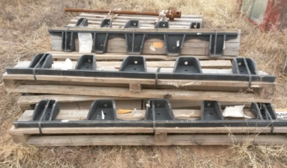

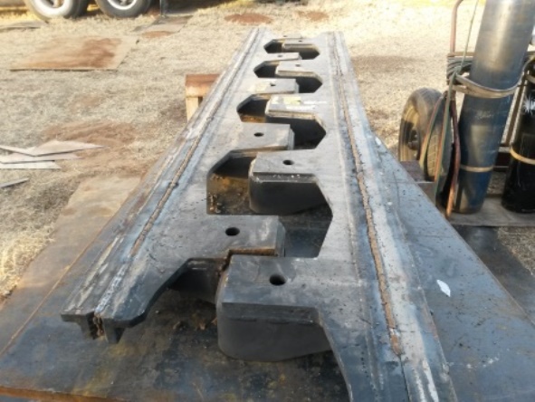

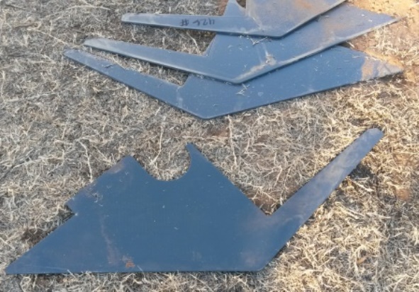

    OK I have a lot of steel in my usable stock area. Although it is not always exactly what I want it is always exactly what I need to get the job done
    I frequent auctions and whenever I can buy for 10% of what I can sell it for in scrap it gets loaded on a trailer.
    I bought 8 of these for $10.00 they are about 200 lbs each
    It may be a little hard for some to visualize how those are going to become a fork carriage so you will have to wait until tomorrow after I start cutting and welding them together

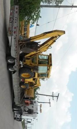

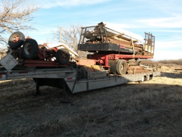

    Ha,ha yeah where does he get all of these wonderful toys indeed. When we returned from Kuwait we very carefully packed up everything to ship it back. our household stuff alone would have required a 40 ft container Partially because I had a fairly complete mini machine shop that filled 1 20 ft by 18 ft bedroom of out 3rd floor 1800 sf apartment A Harrison 280x1200 manual/ CNC trainer lathe a Clarkston Tool & cutter grinder My Do-moore versi mill 2 bench grinders a 2 HP table mounted Mill Drill and even a 1000lb cap gantry crane plus a 27 drawer tool cabinet the rest of the house was chock full of the usual house stuff except for my office which had 2 computers an 8 ft Mahoghany executive desk with 4 32" TVs for moniters
    In my factory mnost of my stuff had been removed from service as we had replenished with upgraded equipment but my machines and tooling alone would have filled another 45 ft container. Our debarkation date came earlier than expected so everything had been placed in one of the companies warehouses to be loaded in a container. We left with 2 large suitcases and 2 laptops leaving everything else to be shipped at a later date that was in March of 2013 to this day we have received nothing Not even the vested interest due me for my 10 years as senior engineer for the company which was to be 1% of net and 1/4 of 1% gross annual receipts. Nay all we came away with was the 10 years worth of my wife's salary plus about 6 months of my salary. We have lived off of that and accumulated what we have from my buying and selling or the few odd jobs that have come my way

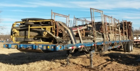

    the truck not mine the trailer half mine because I rebuilt it at cost and no labor the Backhoe mine from a customer that I have had since 1979
    THe reason I need forks
    more reasons for forks the trailer half mine
    the small trailer mine the junk mine
    And there have been 10 more loads like these brought out here call it my Mad frank beyond thunderdom apocalyptic survival stash

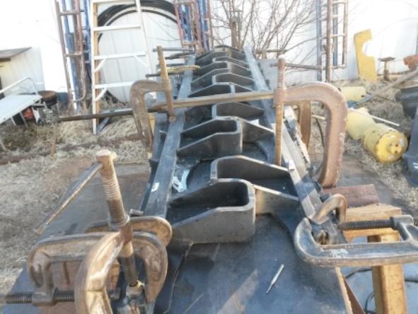

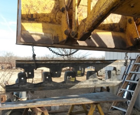

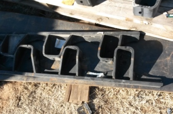

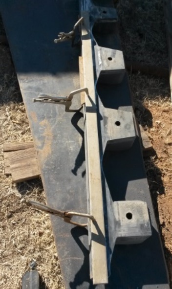

    Progress today

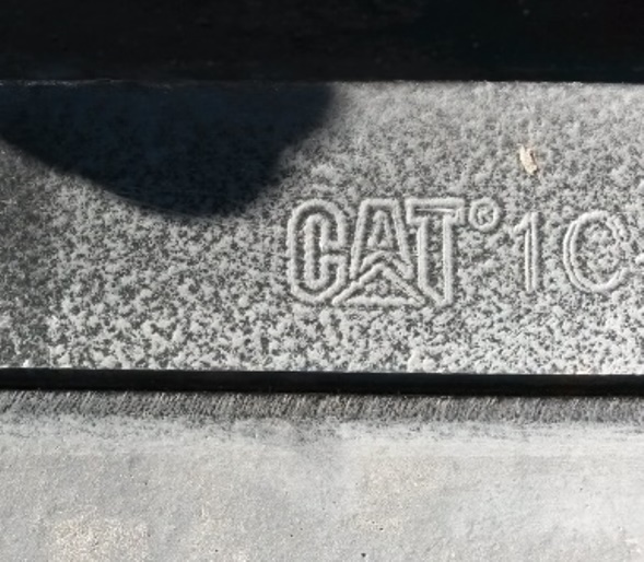

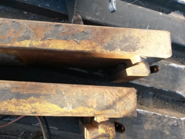

    Yes the scrap steel is new so to speak. also it is CAT steel so I know it is high quality and strength

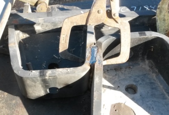

    As you can see I cut 2 of the pieces to the the upper and lower lips of the carriage
    the funny thing about this steel is if the market hadn't dropped by half right after I bought it at the auction I would have sold it As with about 2/3rds of the other junk I hauled out here
    Fork carriage for my Ford 755-20170101_160903a.jpg Fork carriage for my Ford 755-20170101_162017a.jpg Fork carriage for my Ford 755-20170101_162036a.jpg Fork carriage for my Ford 755-20170101_162104a.jpg

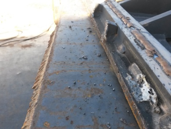

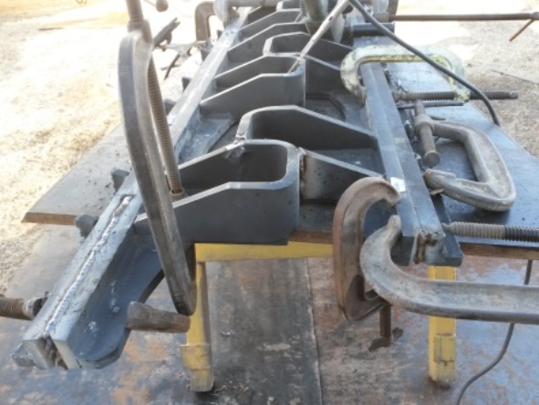

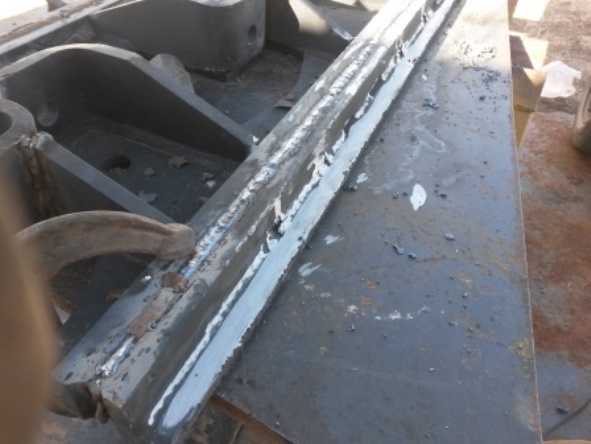

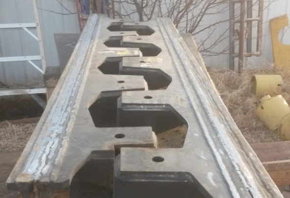

    Windy enough to today blow a prairie schooner across the desert on square wheels with a ripped sail.
    Not a lot of progress having to constantly fire watch while trying to weld cut or grind
    First pic is where I am starting ro scarf off the left over stubs from the previous cutting
    2nd one is after grinding the land
    Fork carriage for my Ford 755-20170102_150407a.jpg Fork carriage for my Ford 755-20170102_150419a.jpg

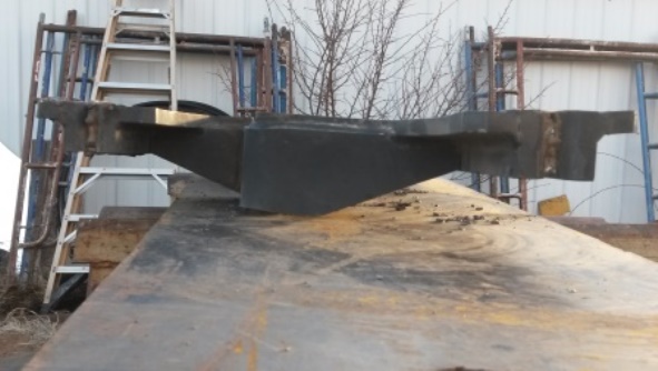

    3rd is the back side nearly finished welded out 4th is turning the assembly over
    Fork carriage for my Ford 755-20170102_150429a.jpg Fork carriage for my Ford 755-20170102_152548a.jpg

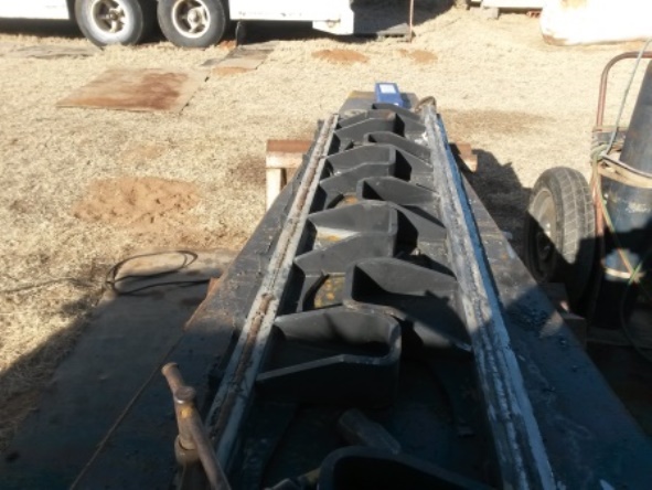

    5th is some plates I have that will probably be the attachment plates for the loader arms.
    6th shows how the front side next to the forks will look
    Fork carriage for my Ford 755-20170102_162532a.jpg Fork carriage for my Ford 755-20170102_165936a.jpg
    7 is an end view

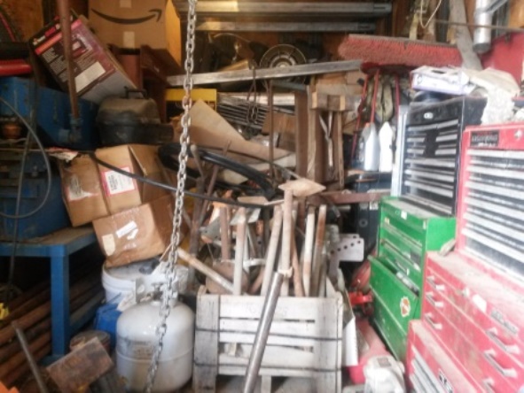

    Almost no progress on the forks carriage today. just a little grinding to the front face. for minimal clean up.

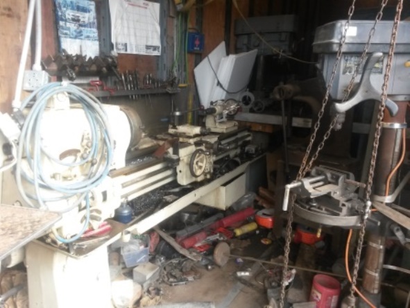

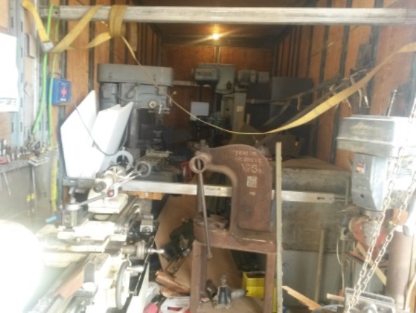

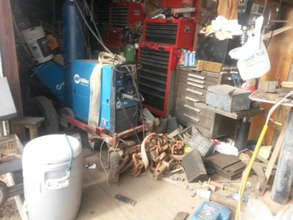

    most of the day was spent trying to clean out the machine shop van enough so I can make the pin bushings that will be welded into the mounts that will attach to the loader arms.
    Too much stuff had to be packed for transport leaving an absolute mess when some stuff that hadn't gotten tied in real good shifted A lot of this stuff doesn't even belong in here so out it goes as soon as possible to be stored elsewhere
    Fork carriage for my Ford 755-20170103_130943a.jpg Fork carriage for my Ford 755-20170103_131020a.jpg
    The arbor press broke free of its moorings and walked out to the middle taking along with it a parts bin the 30 drawers decided to empty their contents on the floor as well as some stuff from a lower cabinet managed to wind up under the lathe.
    Some people can work by stepping over that stuff and I might have if machining these bushings had been an emergency job but they are not and I will not so before I power up the lathe a good house cleaning is in order 1 day or 10 I don't have to worry about keeping everything in lock down anymore so a lot of this stuff has to go
