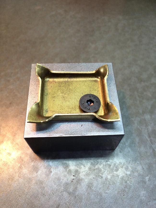

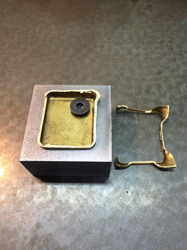

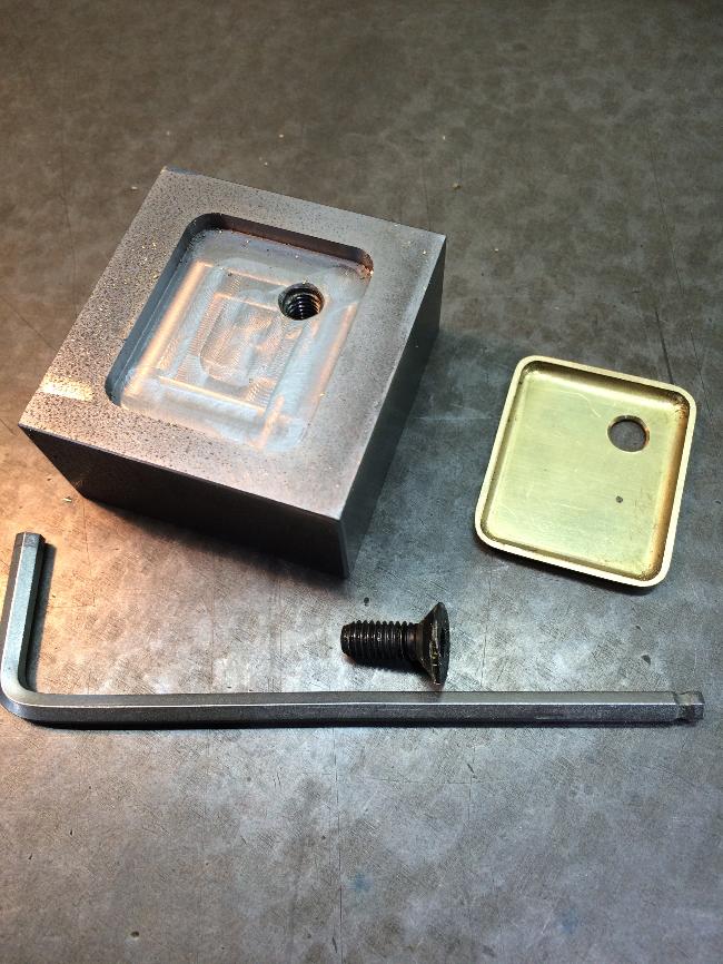

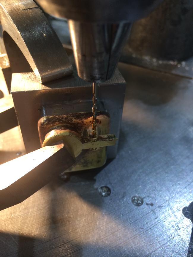

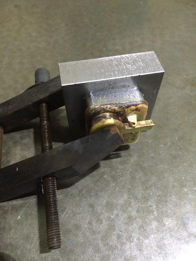

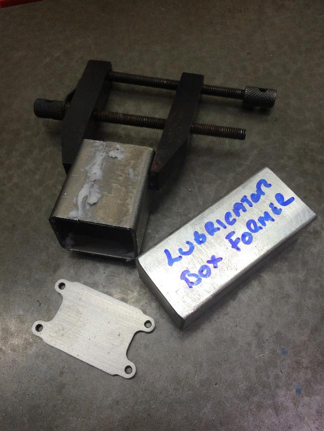

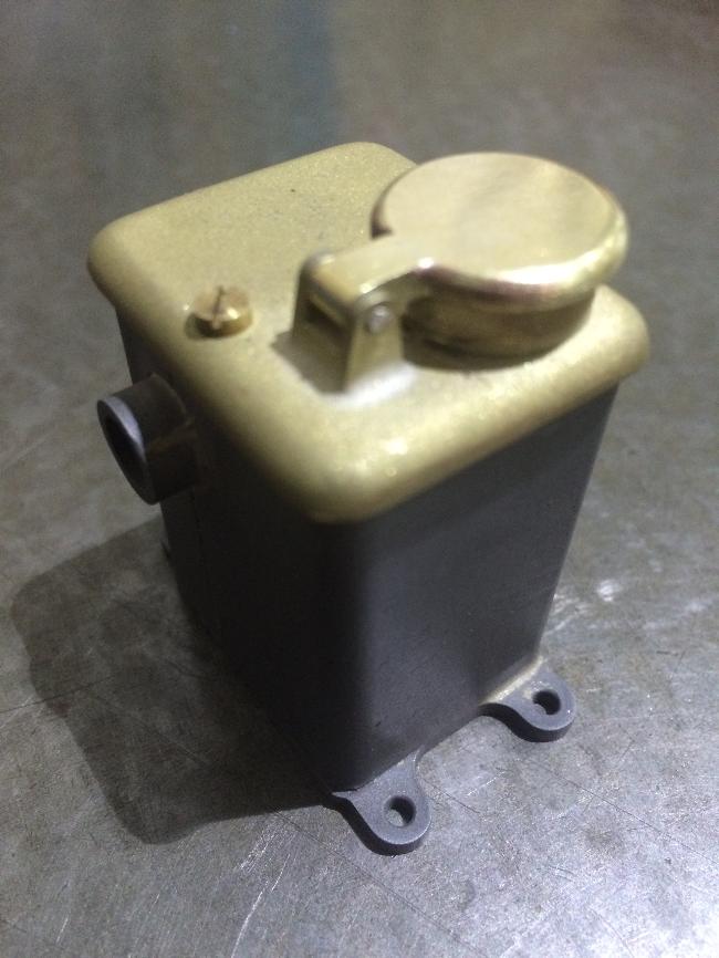

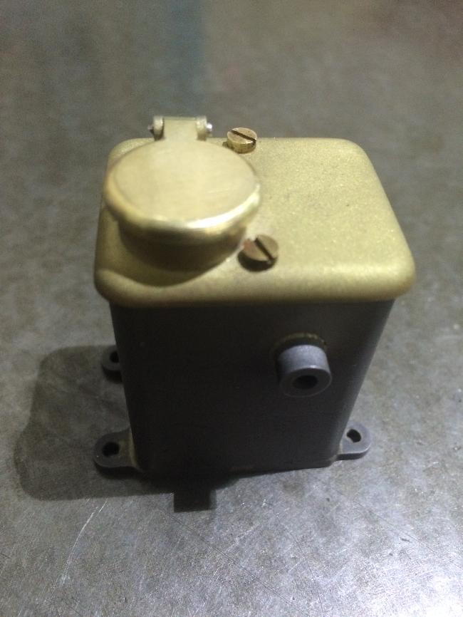

Hi All

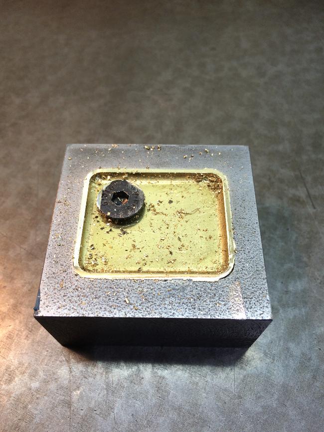

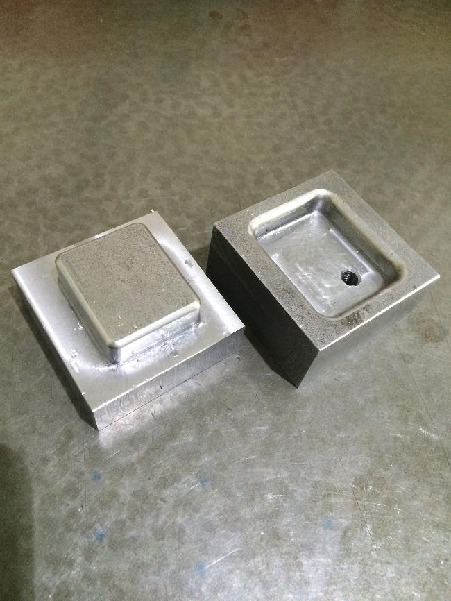

This is a lubricator for a 3” scale Foden Steam Wagon. It is not so much about what the item is but I thought I would share the tooling made to form the material.
The main box is 16 gauge steel. Simply cut to length, and rapped around the former tapped in to place for a tight fit. The lid I as a pressing. The press tool for the lid also doubles up as a milling and drilling fixture as can be seen from the photos. The box and lid have then been individually silver soldered with their relevant bits made on the mill and lathe. The original full size lubricator, constructed from two castings, so I am hoping this will look like a scaled down version, once painted. There is more info on the Foden build on my web site Practical Engineering
