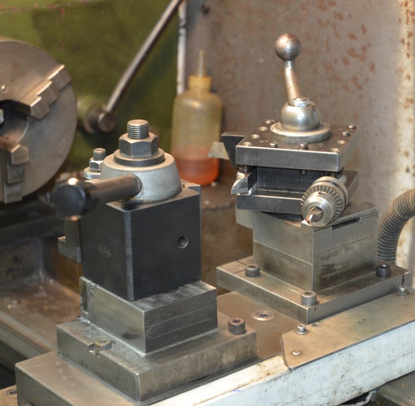

This is 2nd and most important modification of my lathe (11 x 26, bigger brother of Grizzly G0602).
In order to make compound more rigid and also to enable use of bigger cutting tools, I made 4 bolts compound clamp and by the same time I lowered top slide for almost 5 mm. That allows use of bigger 4-way tool post and 16 x 16 mm cutting tools.
Both; compound clamp and new pivoting base were made from 25 mm high tensile AH36 (shipbuilding) steel plate. In order to make it more rigid,
I made new pivoting base which is bigger and which has recess for compound slide pivoting base. Compound clamp is bolted down with four M8 x 30 bolts.
Picture 01
Original (very bad) design is 2 bolts compound clamp with bolts at wrong places. There is a lot of flexing, vibrations and chatter.

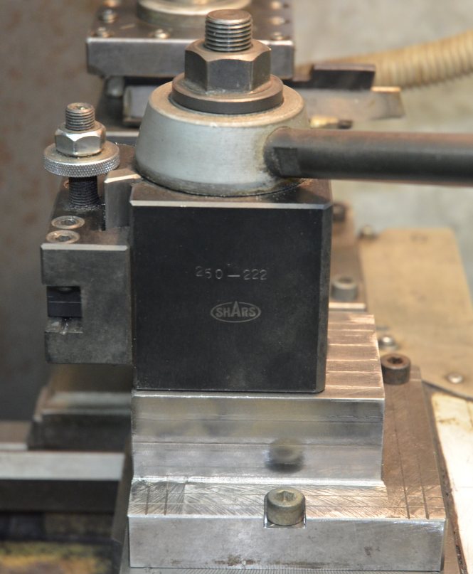

Picture 02
New 4 bolts compound clamp and new beefier 4-way tool post.
I have no intention of installing QCTP, as for the last 30 years or so I was working on various heavy duty lathes with 4-way tool post. Shimming is not a problem at all, especially if the same size tools are used. For this tool post and 16 x 16 mm tools I need 2 mm shim. For 16 x 16 mm boring bar holder I need 9 mm high shimming.
