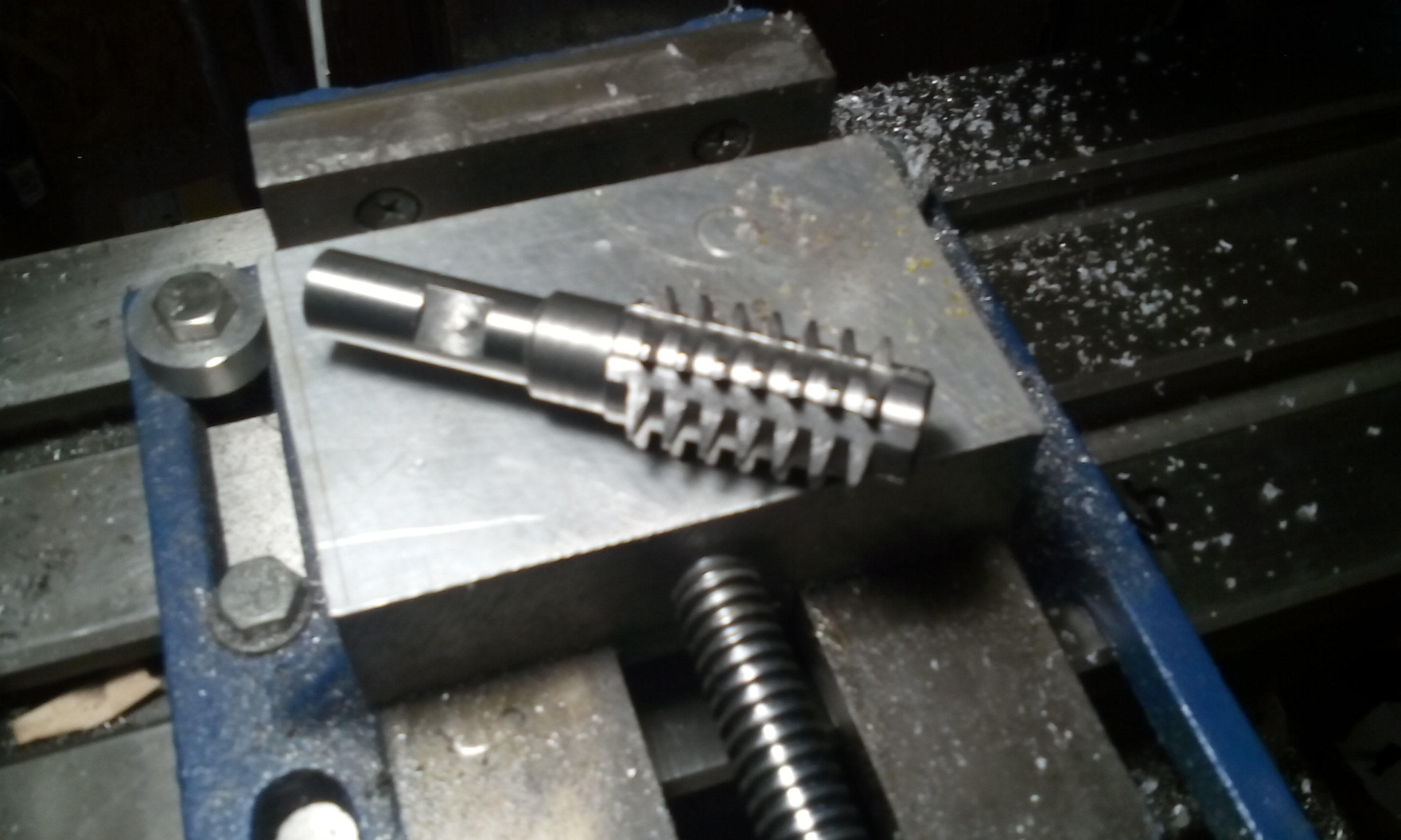

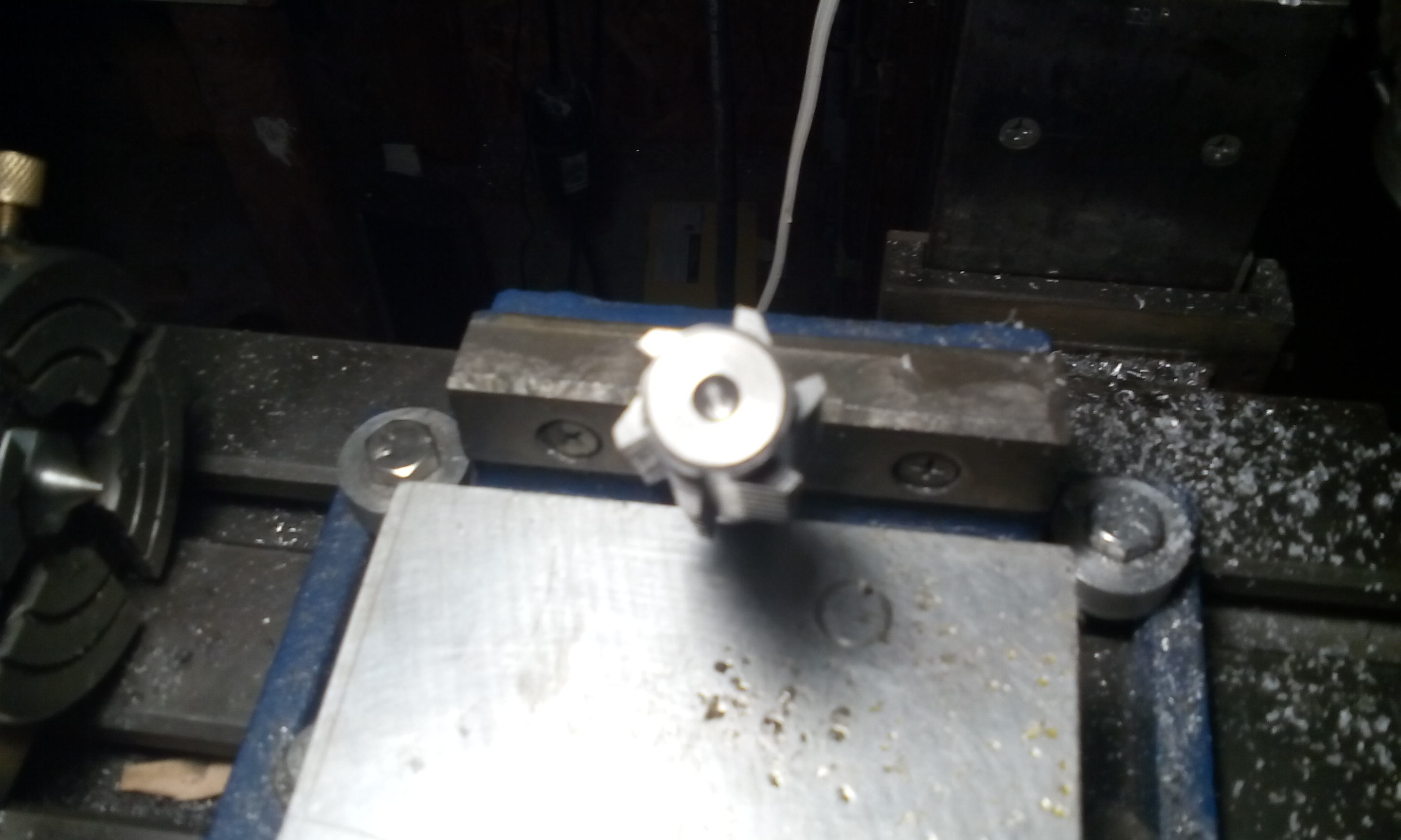

    Here is my approximate involute gear cutter, turned down from some un-known steel from the calculations from this siteInvolute Gears
    It was then pack hardened for 2 Hrs. at 1800* F And the teeth honed on a diamond lap.

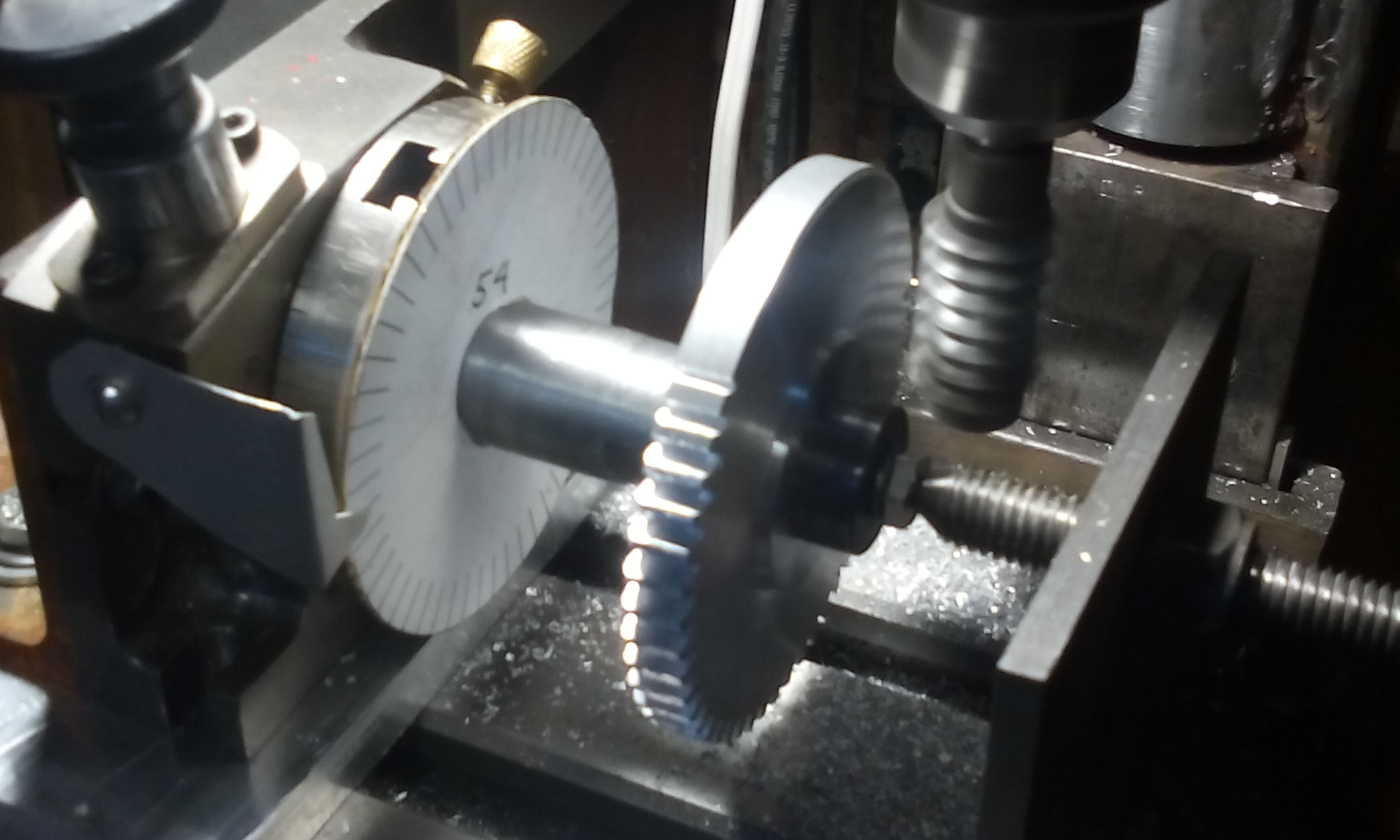

    Set up in my homemade knee mill (Witch will be another post as soon as I get a few more pics.)

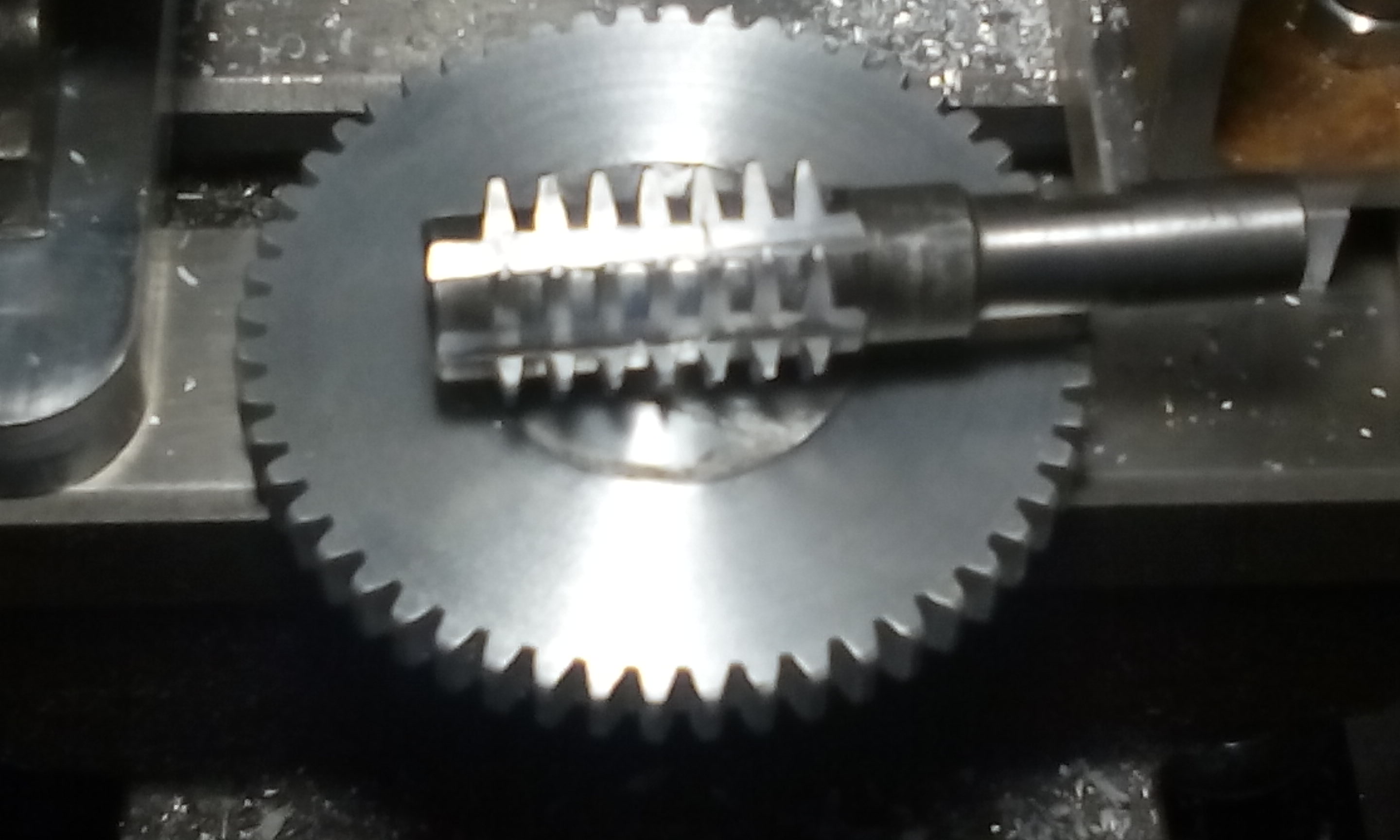

    And the final gear.
    Although I believe I forgot to add the extra for whole depth plus clearance it does run on the lathe, but a little noisier than the other change gears.

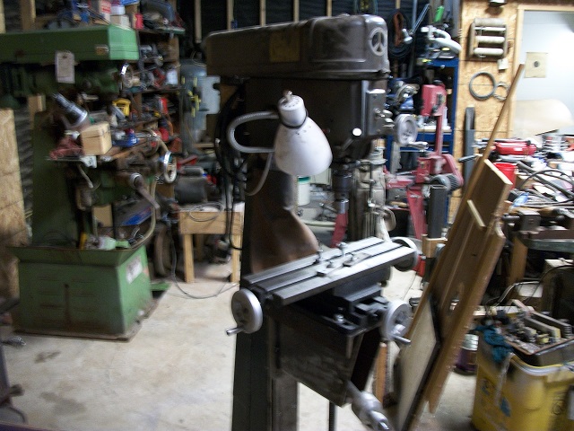

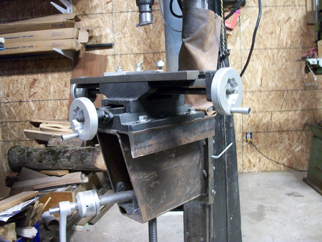

    Your post caught me by surprise as this post is a couple years old! As to the mill, I used it for a little les than a year never really completely finished it and got offered enough for it by a shop that wanted a heavy-duty drill press with cross slide table that I was able to pay for a smoking deal on a used mill taken out of service at the Intalco Aluminum plant here.
    I think the only picture I have left of it is the one in my avitar

    Found a couple of it just before it left for its new home, the replacement is in the background
