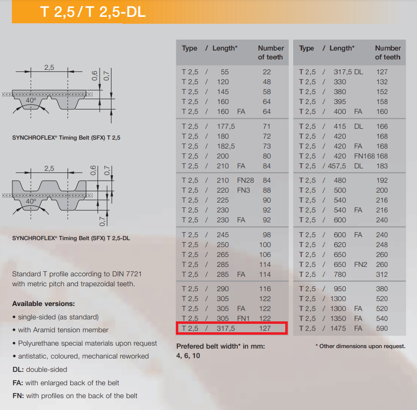

1 Attachment(s)
"AMAZING!!!" 127 T "gear" on the über-cheap!
From a discussion in the following thread:https://www.homemadetools.net/forum/...ng-plate-84732
Quote:
Originally Posted by
DIYSwede
-Your brilliant idea finally solved my problem of making a biggie 127/ 50 tooth bike chain wheel combo,
to convert my mini lathe's metric leadscrew to inferial! :)
Humour (if present) could sometimes be the pathway to new ideas:
- Imperial (127 teeth) to Metric conversion gears aren't obtained neither easily nor cheaply.
A fast, cheap and small (enuff to cram into a 7 x 14" mini lathe) could be to use a timing belt.
The "T 2.5" variety in fact has a 127T (@ 4, 6 or 10 mm width) belt that could be ordered for under 4 bucks...
So - (as the well-informed HMT reader instantly replies)
- a 127 T BELT doesn't really solve the ratio problem, as it's just an intermediate!
Yup - IF (and only if) you really USE it as a BELT -
but if you instead wring it inside-out and glue it tightly on a turned center disk of ca 100 mm dia, and desired width,
it will (-Ahem - most probably...) become a 127 tooth pulley - as the T 2.5 profile has a symmetrical, trapezoidal profile.
Put it in the lathe "gearbox" together with a (more uncheap) T2.5 pulley to get desired ratio.
A 100T pulley together with this 127T kludgery will most certainly NOT fit into a smaller lathe though,
so a smaller "pinion" might be needed, and take up (or down) the lost ratio in later gear stages.
More than a thousand words (check out the red box):
Attachment 39202
from:https://docs.rs-online.com/14e8/0900766b808993b4.pdf
Just a quickie idea - ans suggestions and corrections welcome!
