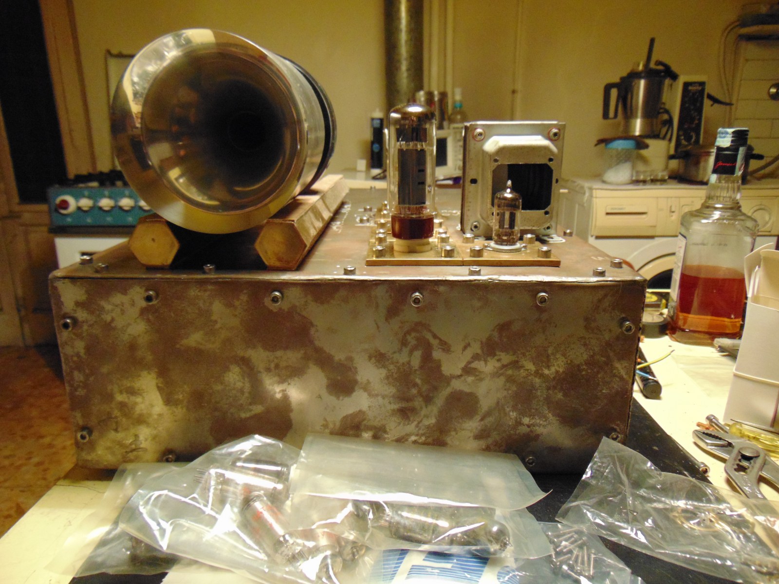

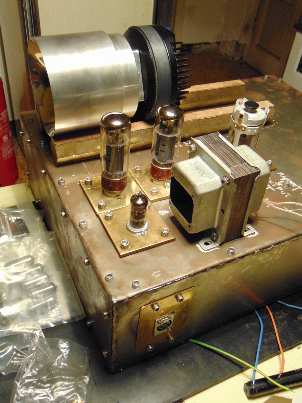

Around the outside I used a strong paper used for electric motor, should be mylar paper according to old man who gave it to me. Very rigid and in various thickness, I used 0,2mm. He gave me also a very nice mylar scotch tape, close to perfection to keep winding in position. Unfortunately calculations foresaw slightly different values, I got maybe a bit low inductance and resistence as anode choke. Some manufacturer has anode choke of high impedence (80\100H for 10-20hz use), I don't need low cutoff frequency, but I got some doubts about this. The good thing is that I got space in bobbin, I can wind maybe 5x of actual turns, and maybe this time, with lathe, luckily is only an inductor :) obviously I will try to do by hand

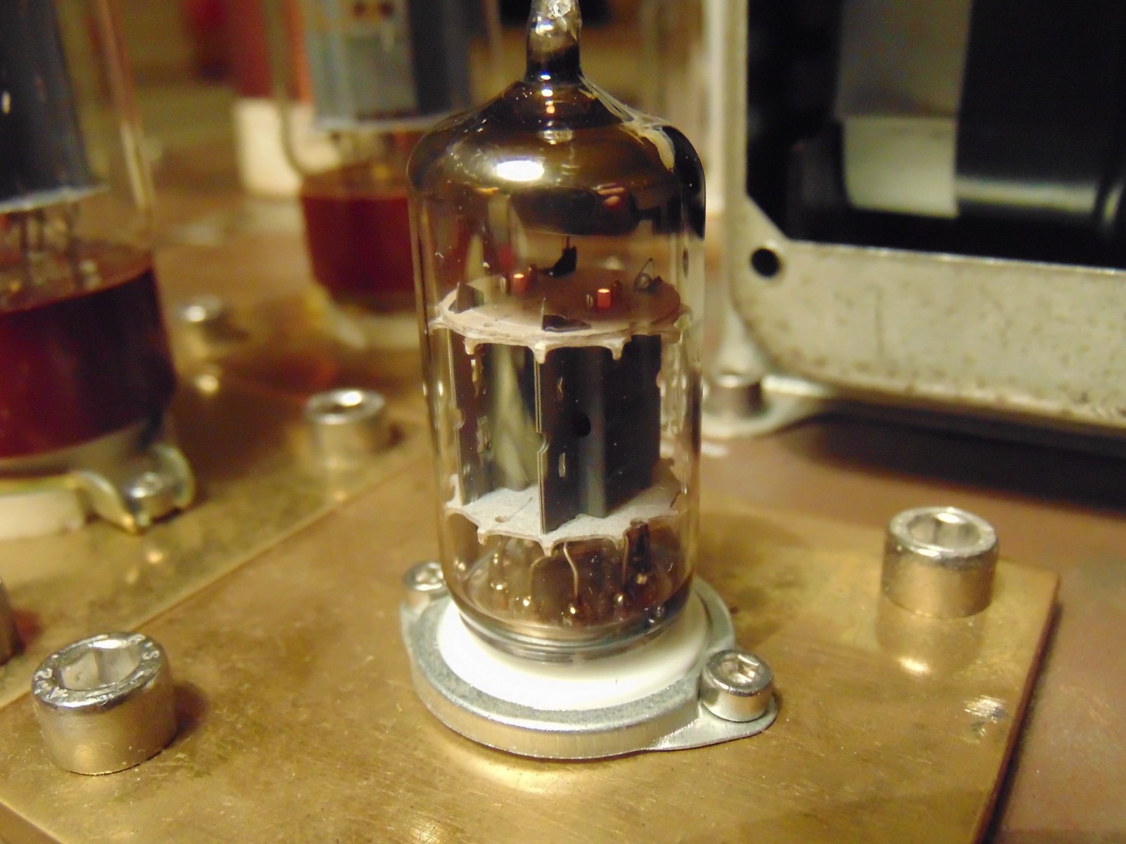

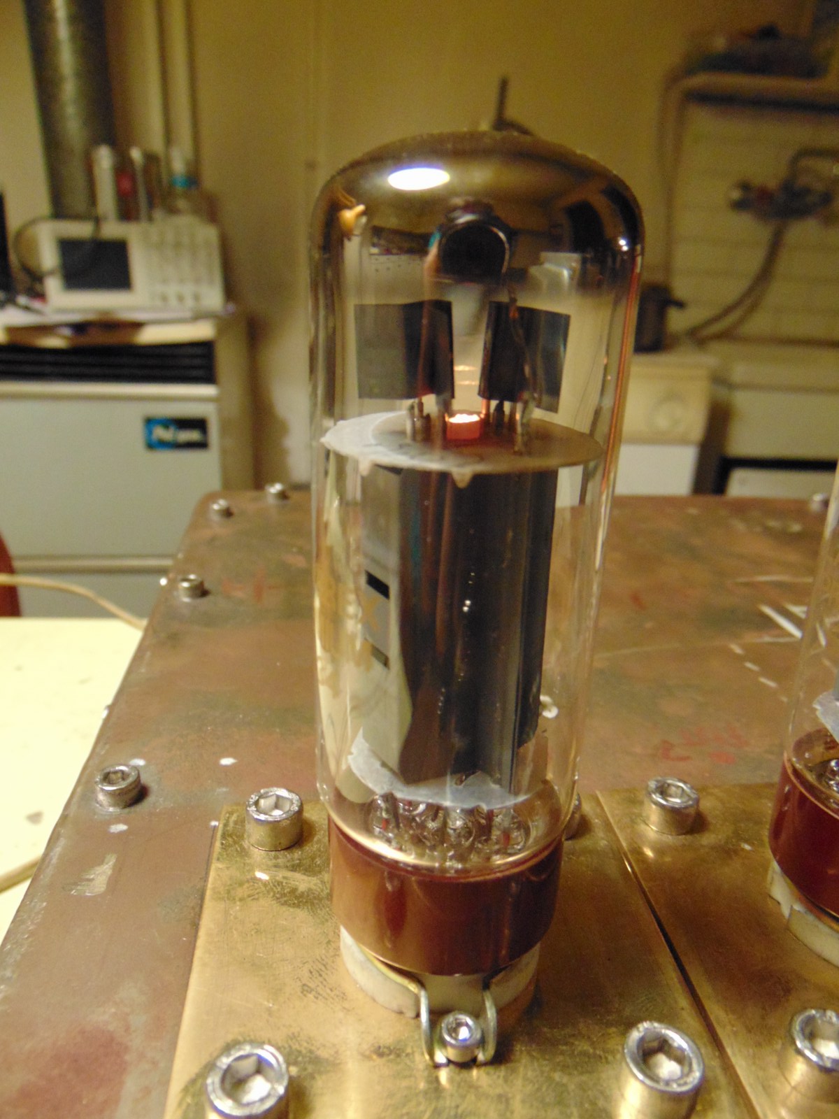

This El34 tube are made for Langrex, a uk company of tubes and electronic parts. For sure made in Cina by Shuguang factory, quad matched. Imho this production is a "good selection" of el34, maybe matched in factory during test. I would like to think so :D . Even if they were only fables, 15 euro shipped each tube is a good price. In my city shops I've seen similar price range tubes ( chinese, JJ, elettroharmonix ) from 22 to 45 each, even on ebay price are good.

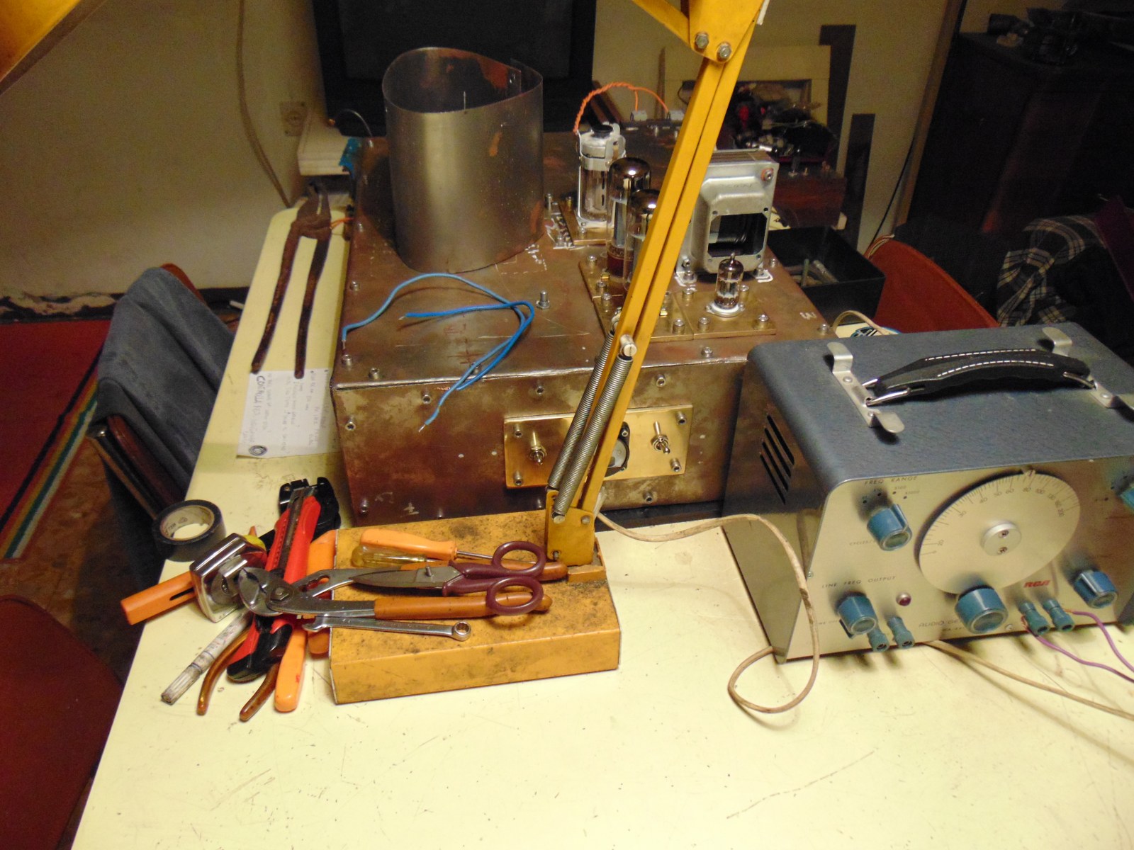

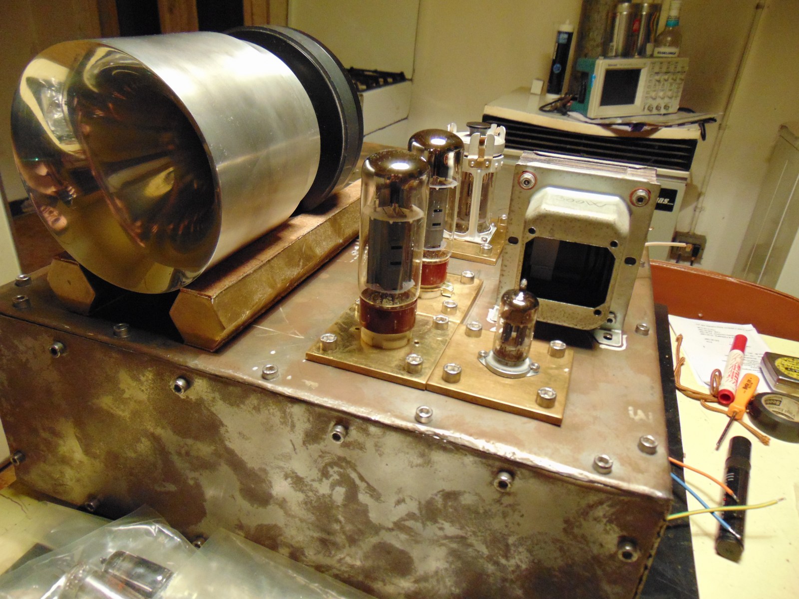

I try new layout, I'm trying to make a good use space. For final version, no potentiometer, no volume, and switches in the back, in order to not keep around half meter of 6 cables for power supply. I have to find a good amperometer and maybe a voltmeter till 2kv, not easy to find, unfortunately! This evening I made a couple of support for power supply and Hv unit, to Mount close to sockets.
I changed Gu50 position because heat, and thinking the worst scenario, the replacement of final oscillator tube with one of a higher class (Gk71 - 813 for example). I really want to keep gu50 in circuit, because it's good, but you never know... better to get hands on :D

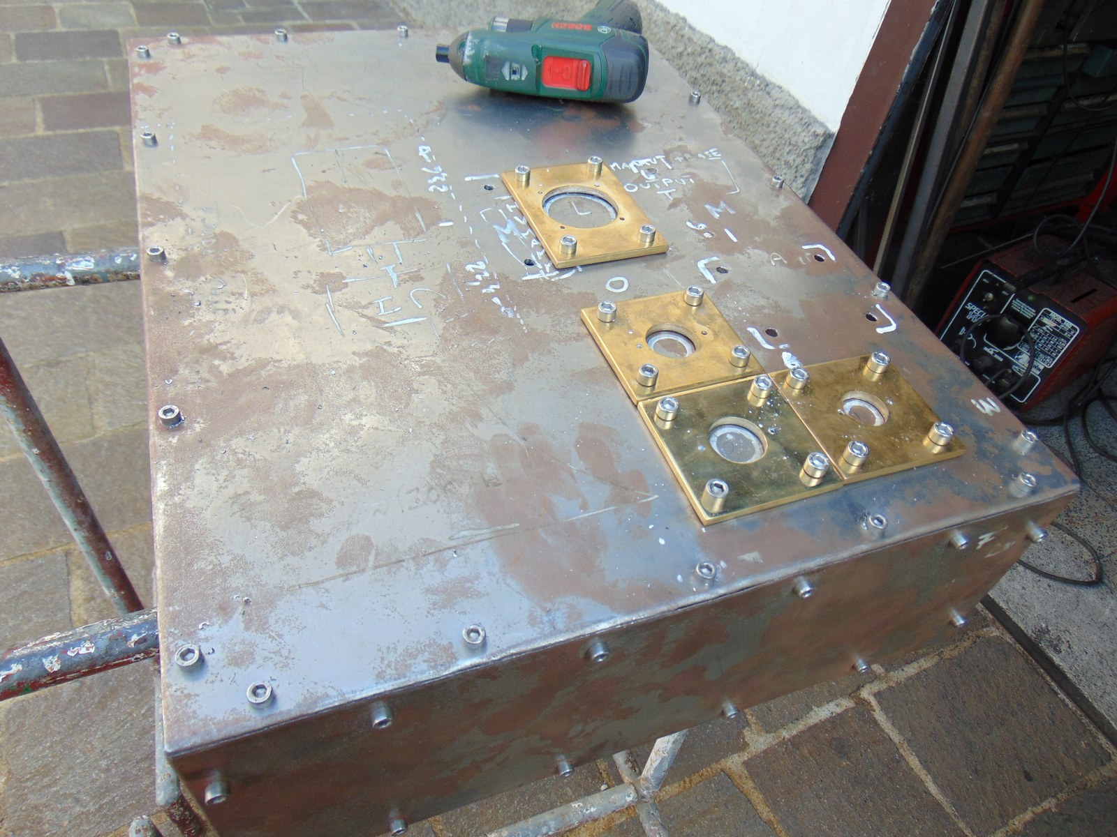

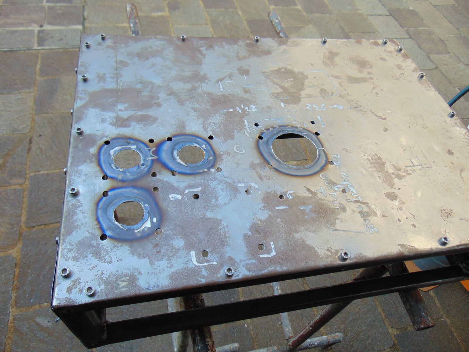

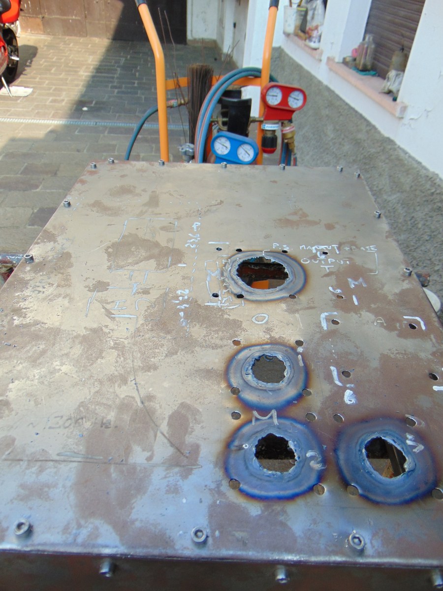

I'm not sure if it's better to use milling machine to open large drill on thin steel, or maybe use the oxy torch, for sure a fast work!

Nice the old guy gave you some paper and Mylar tape. The paper, if made for xformers will be fine with a layer of tape over it. I know you are winding this yourself and it's a pain, but you can change your inductance with the gauge wire...but still depends on the frame quality, laminations & permeation you have. 80/100H does seem high but not sure in this case either.
Really good prices on the EL34's especially if they are Matched...wouldn't count on them being perfectly match but close would be great for this stage.
Glad you are shortening your wire runs it should really help in the isolation. Perhaps you could run the low voltage stuff on one side of the frame and the higher on the other. What is the amp meter for? For the amp meter you can always use an external shunt with an MA meter. A 2kv voltmeter is a bit more tricky to find but again you could build a small external voltage divider circuit...in both cases you'll need to rescale the meters and they will lose some linearity.
I'd think the mill would be better for the larger holes, but you need to work on the cutting geometry of the boring setup you have...although you might find a hole saw (~$15-20) the right size and go slow (peck it) with lube. Give yourself plenty of clearance to the hole in your brass plates for wiring and isolation. To me the torch would mess up your pretty work so far and need a lot of clean up.

Ps: I used oxy torch, and file, because frame was to big to lock on milling machine

I get it about the torch/mill size!

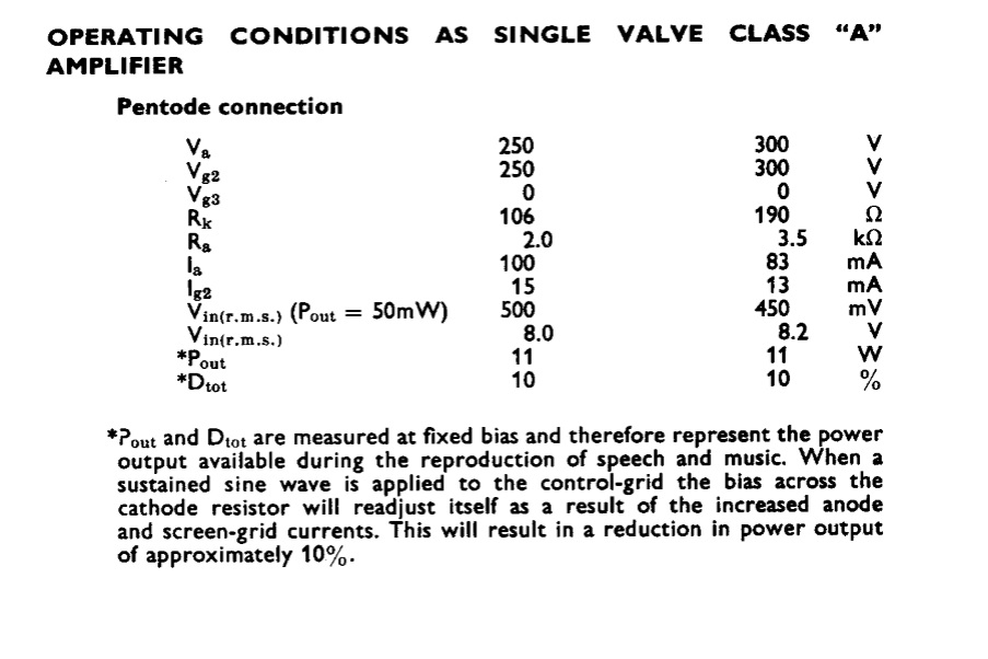

El34, amplifier part, for now follows datasheet specification, then :
anode voltage 300, grid 2 300v, Rk 190ohm, Ia 80ma, Ig2 13ma, 11w power output with 8.2v g1 load 3,5k
I'm also thinking about second working point, for same output , with different load.
anode voltage 250, grid 2 250v, Rk 106ohm, Ia 100ma, Ig2 15ma, 11w power output with 8v g1 load 2k
https://frank.pocnet.net/sheets/129/e/EL34.pdf
Is nothing more than the official data. I will modify the circuit if necessary, but I think it's a good starting point.

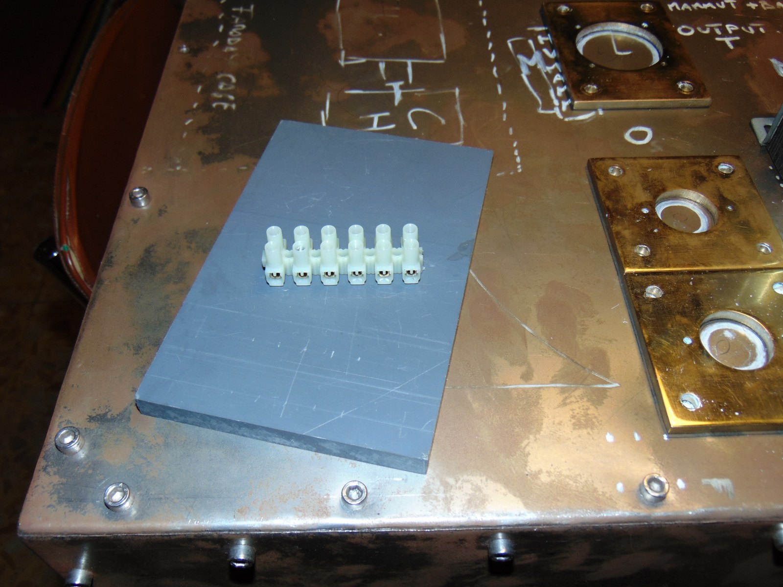

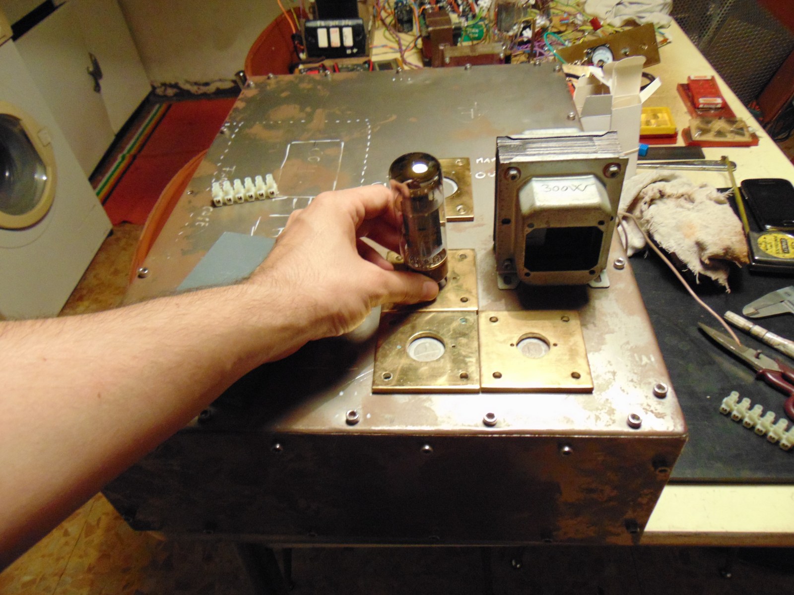

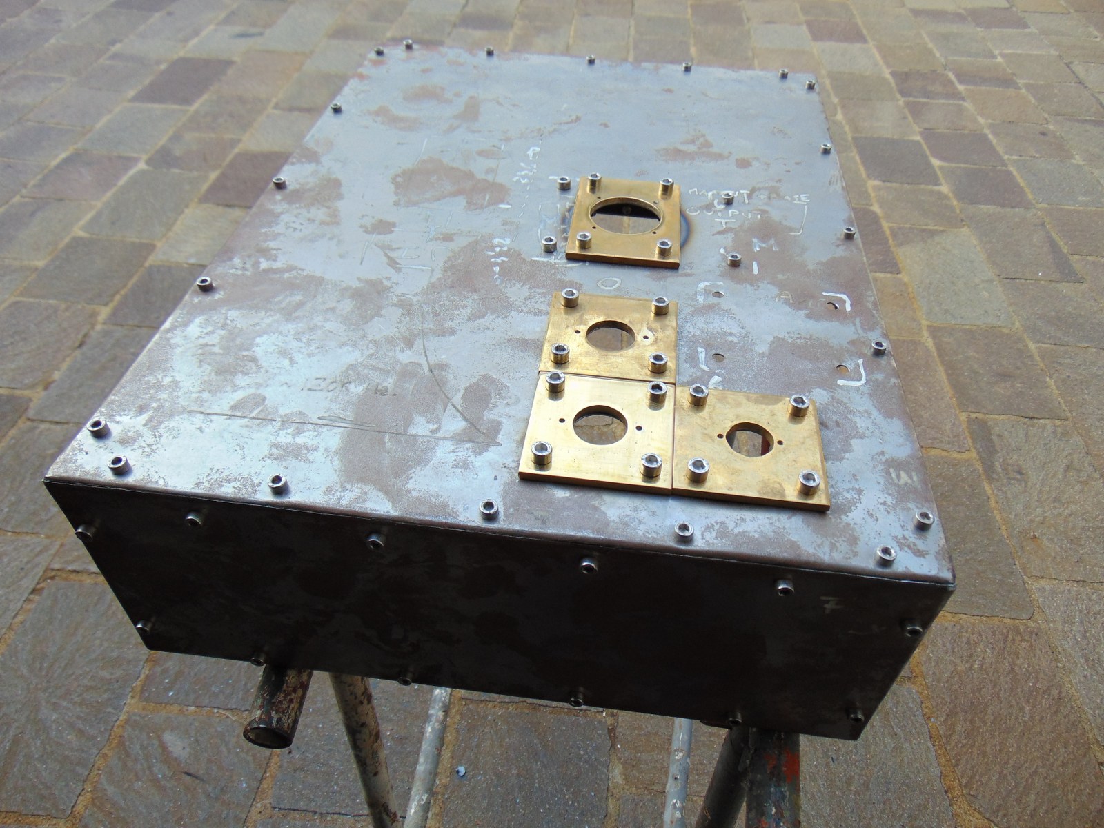

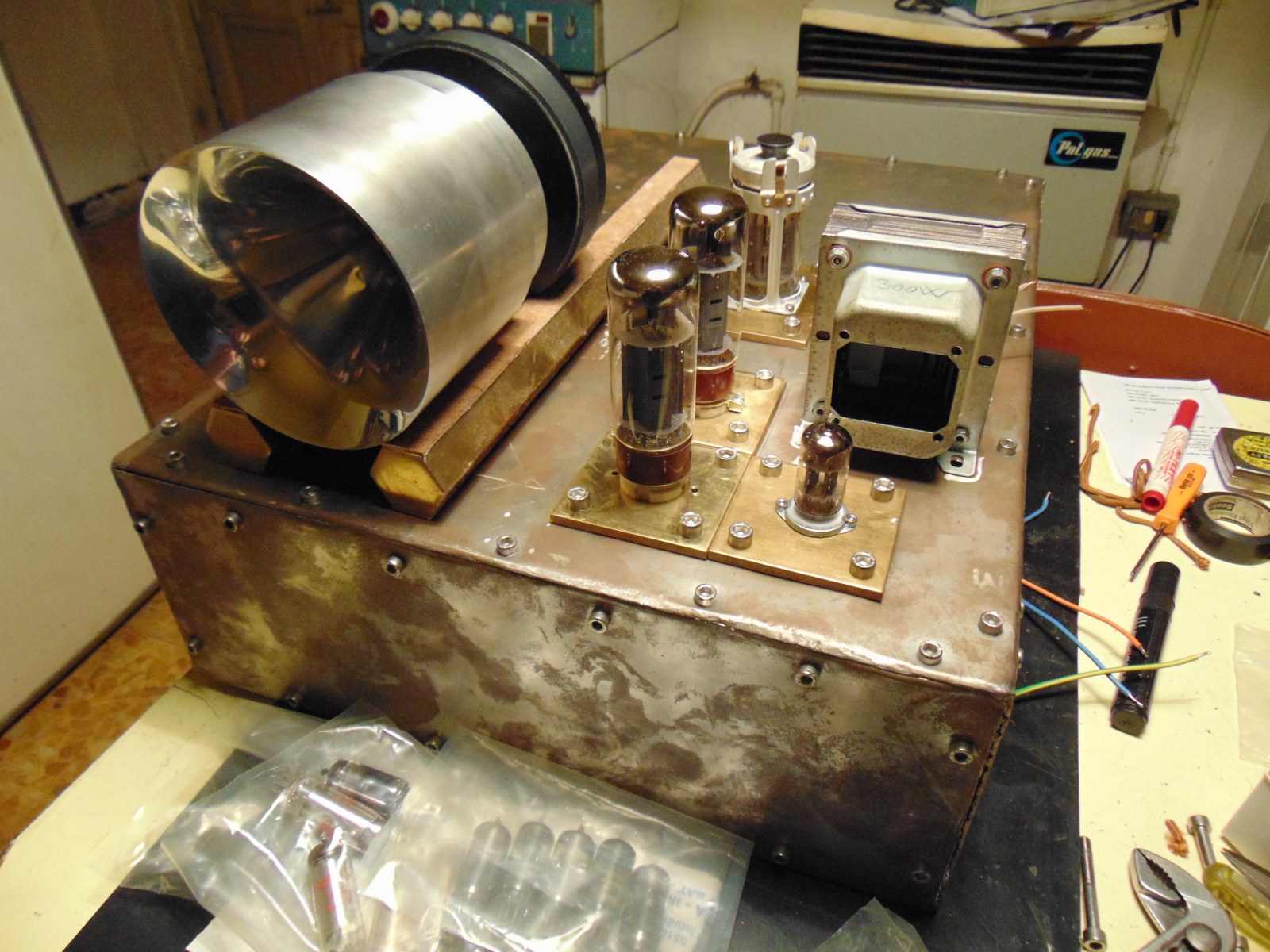

I'm going to put parts on frame, and trying to imagine a new plasma tweeter. Position of sockets is good, I'm thinking about powersupply transformers, switches and other parts. I think I will buy a single 500va toroid and put a couple of relays in order to cut high voltage and maybe filaments.
The 2 long hexagonal brass are only for picture, although I like them cut short.
Step by step this monster is on! I hope! :D

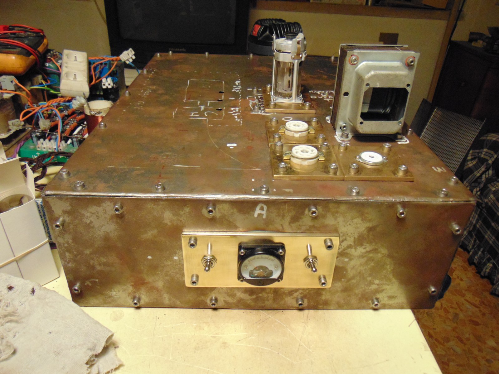

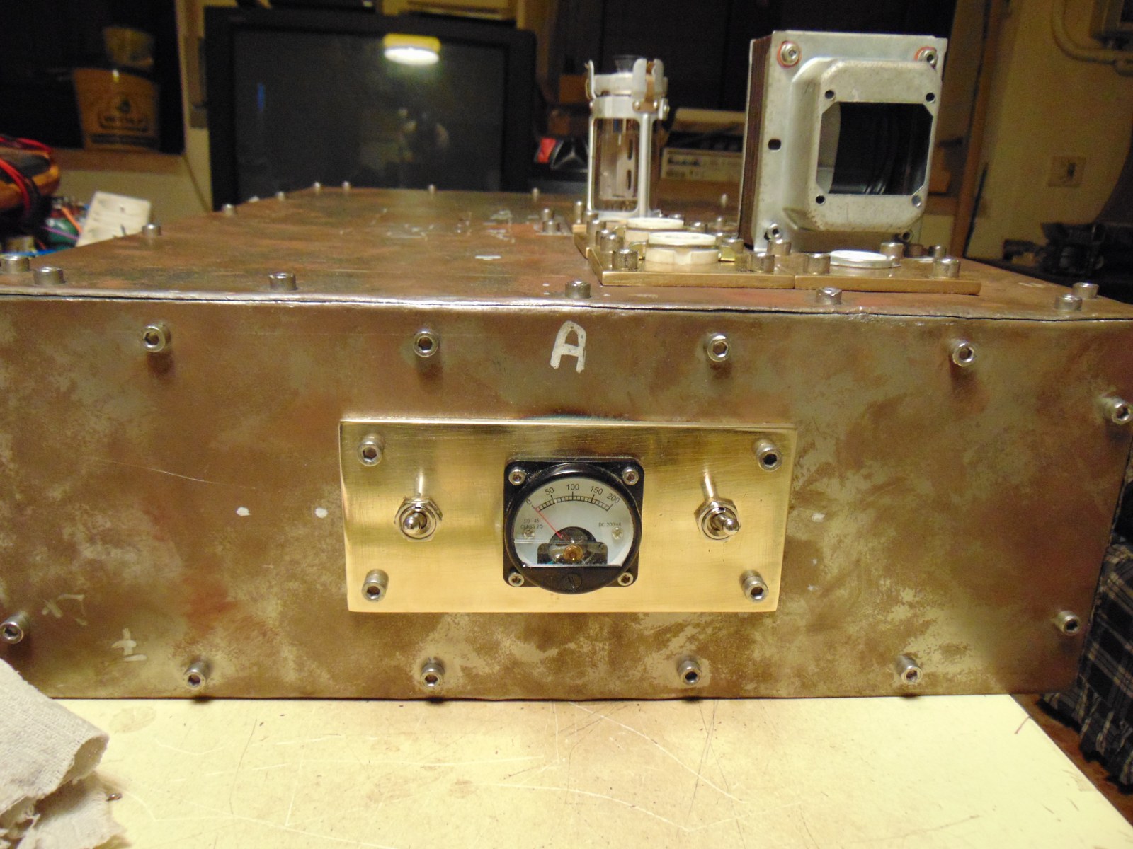

new front panel, as usual solid brass polished, I've improved layout of ammeter and switches for better cables position.
Next step, circuit!

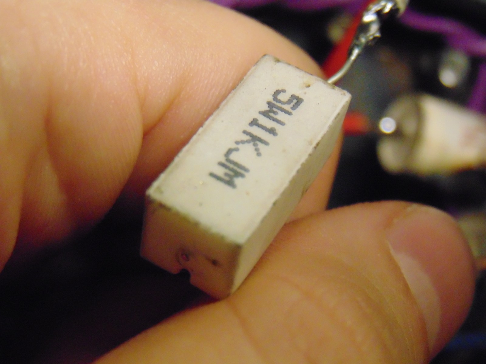

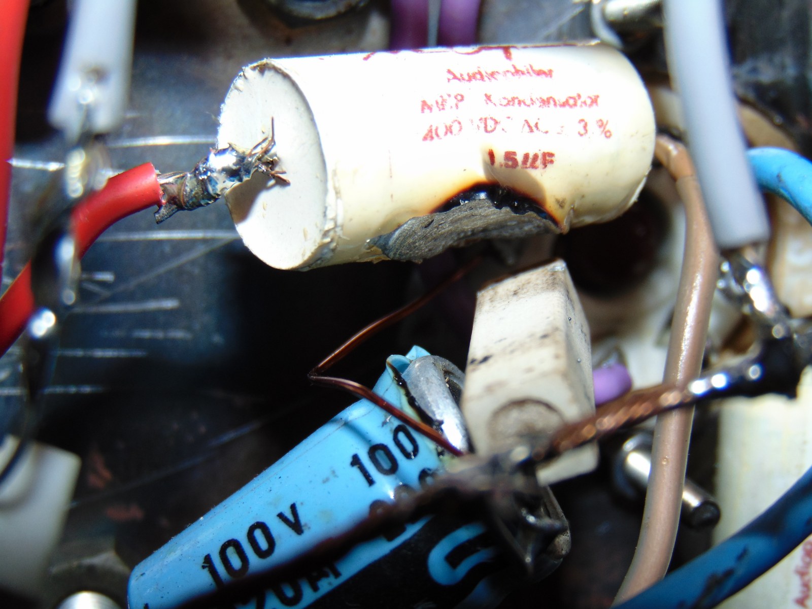

I've not seen that a crucial ceramic resistor broke its rheophore, leaving uncovered a part of the circuit.
Results: melted a mundorf capacitor, the outside of another cap, and damaged a resistor in only 10 seconds. There are also good news, flame is pretty big with only 50ma, imperturbable to environment, with or without semi-faraday gage. Shielded frame seems pretty good.

Sounds like good progress! But maybe a "Bit under wattage" on the wire wound...and also way too close to other components. One thing about ceramic wire wound resistors is were the lead comes out of the ceramic. To much flexing of the lead and or too hot soldering close to the ceramic weakens the wire at the joint and they will break. They also make ceramic wire wounds encased in an aluminum heat sink you can mount to the chassis or a bracket.
For the foil cap you might try to find a replacement Spraque/Cornell "Orange Drop" epoxy resin type and can get them down to 3-5% if necessary. Pull the 100uf electrolytic and toss it...the bleeder hole is likely damaged from the excessive heat.
